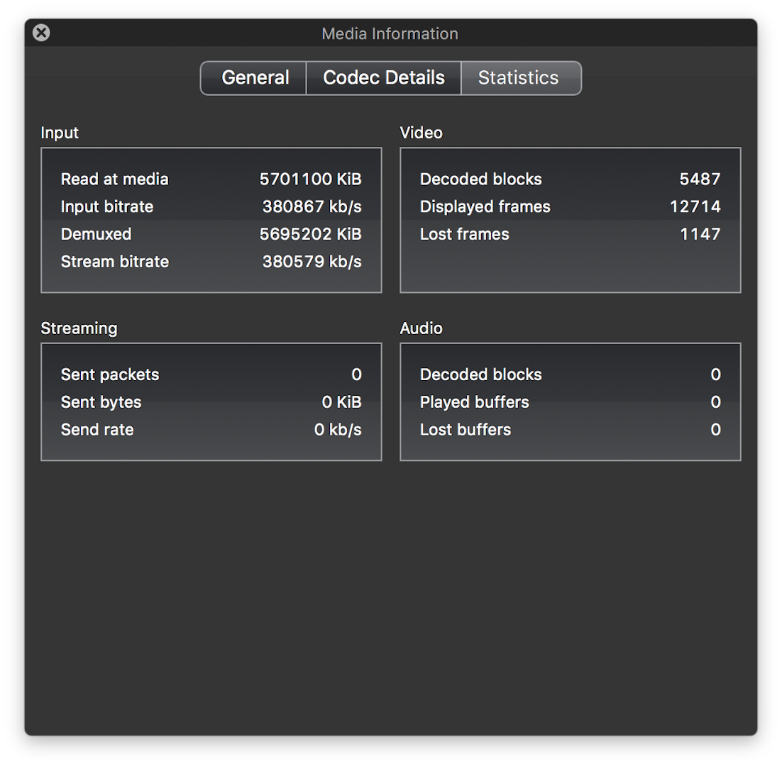

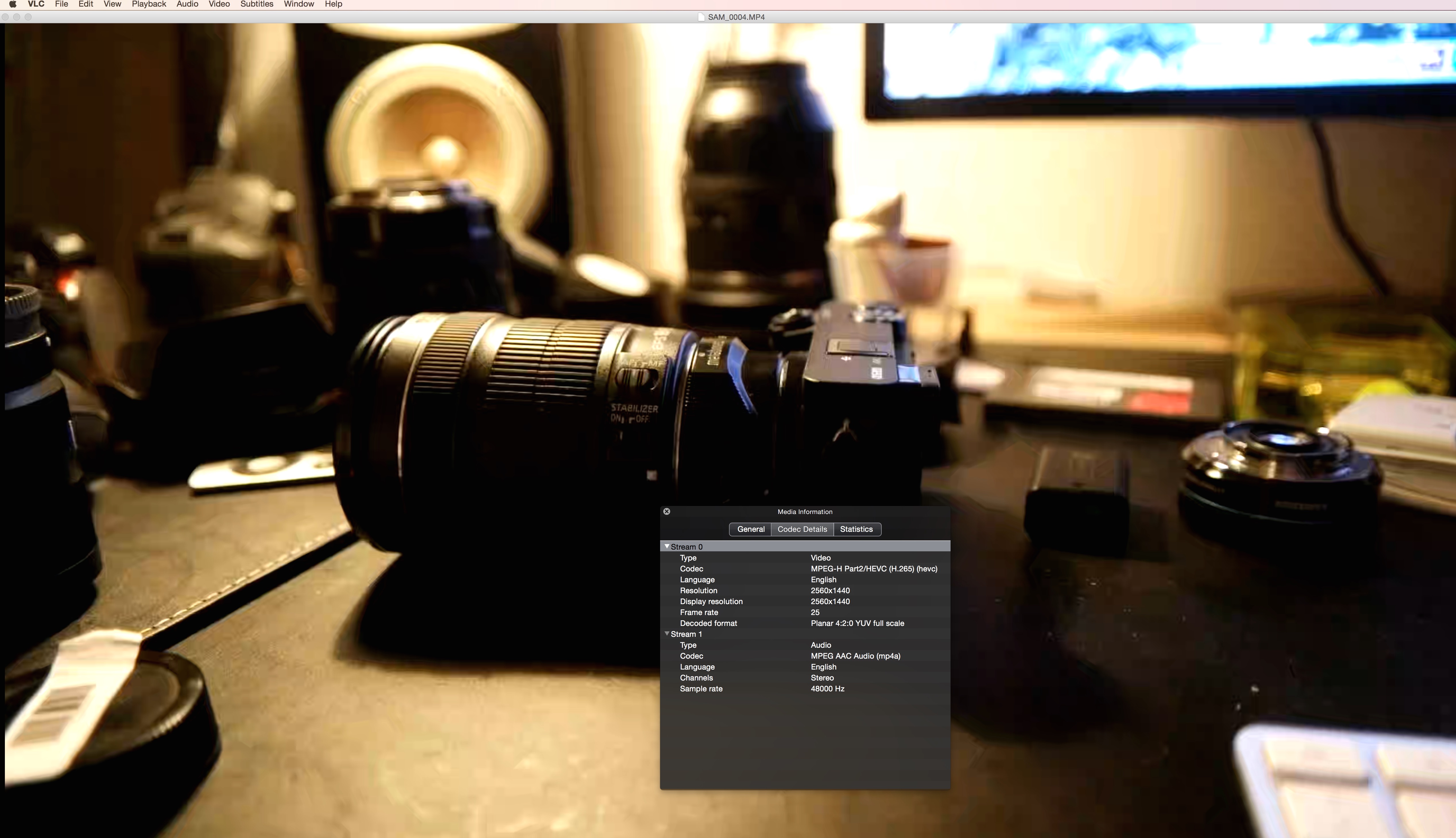

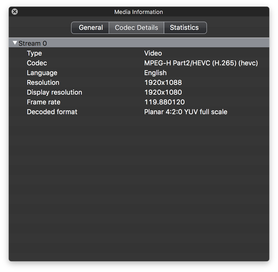

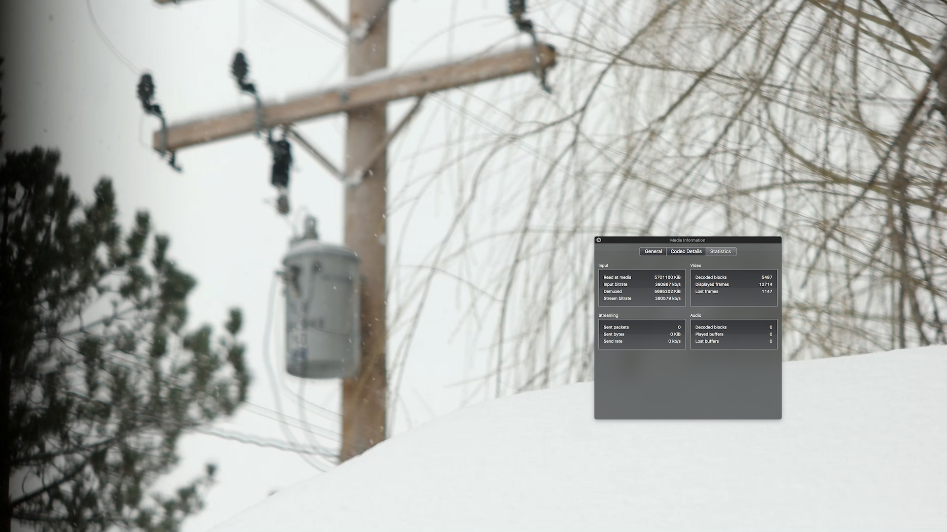

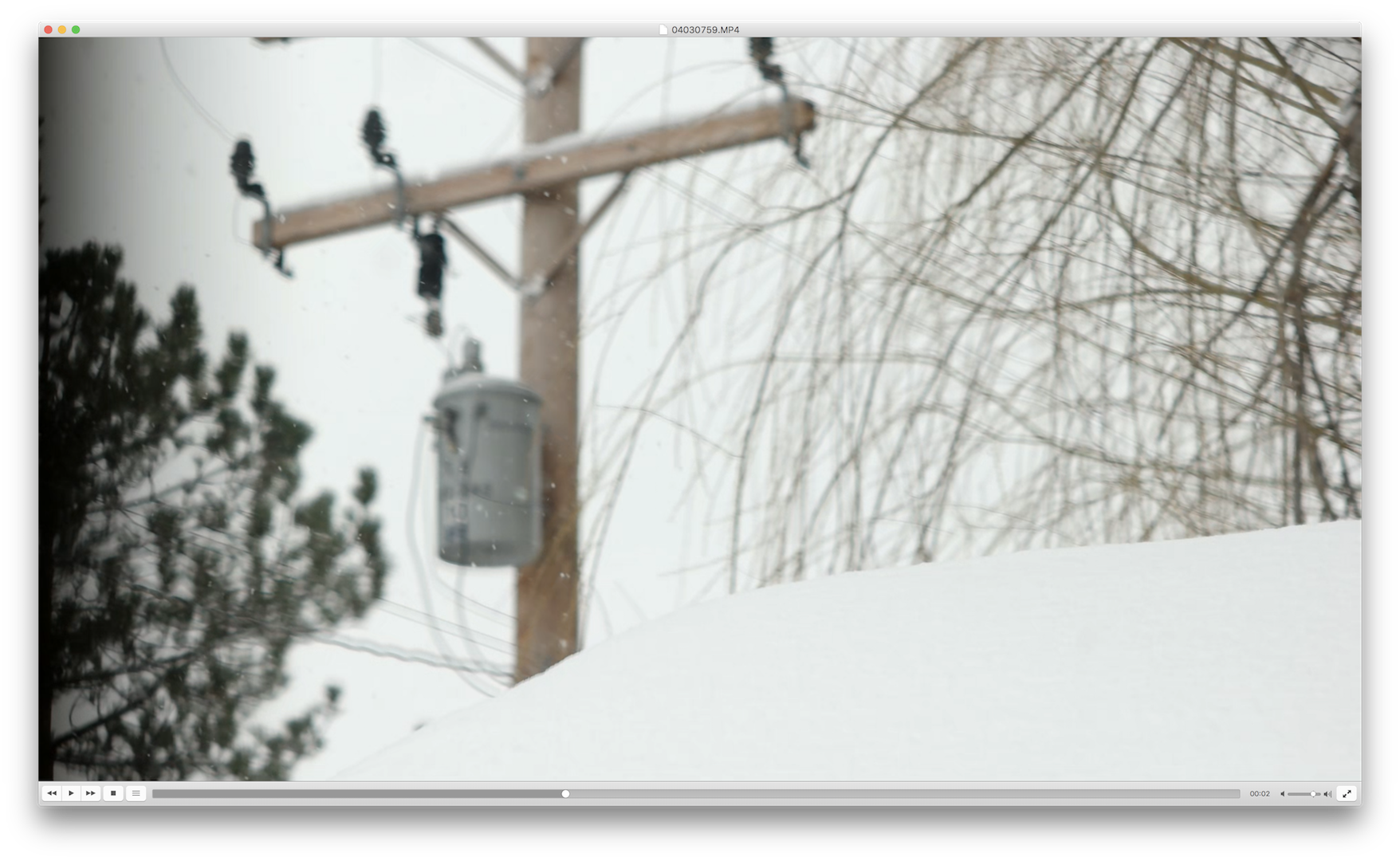

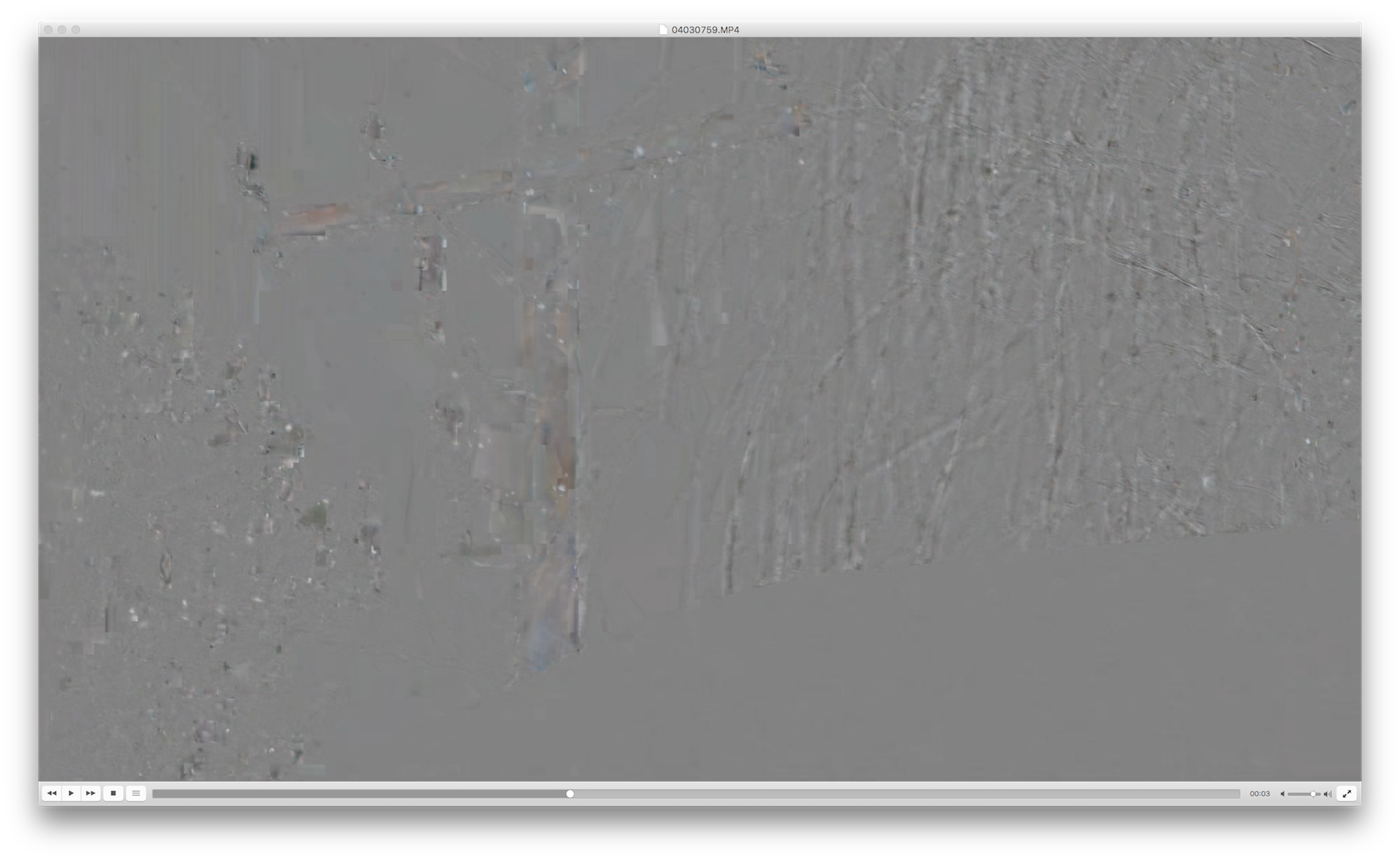

Last Leaves Posted April 4, 2016 Share Posted April 4, 2016 I just tested the NX500 1080p @120FPS via Otto K's github. By no means am I complaining, but the initial results were very disappointing. I saw that Otto said "not a real 120fps" but I wasn't sure what he meant. First of all, when I try to open the h.265 files in VLC (which usually plays h.265s straight off the NX500 without a problem) there are strange glitches in the footage. Every few frames displays completely full of strange artifacts (see pictures), like a corrupted or incomplete file. The strangest thing is that, similarly to Vasile's bitrate-boosted aquarium clip, the data rate is all over the place. (Note: From limited testing that I have done, NX500 footage with normal ("non-hacked") settings shows up as having a rock solid data rate with no fluctuation at all.) On one 1080p120 test clip I shot the data rate fluctuates from roughly 2Mb/s to 380Mb/s! This, to me, seems very bizarre. I decided to transcode this footage to see what it would do with the glitches. I used Rocky Mountain Movie Converter to transcode into Prores LT. Playback then showed no glitchy artifact-filled frames, but it did show duplicate frames. It reminded me of the HVX200 days when people would shoot with the framerate pull-down and forget to remove duplicate frames with Cinema Tools. I conformed the clips from 119.880120fps (that's the exact number produced by this method) to 23.98 and, strangely the playback is in near real-time with short pauses every dozen frames or so. TL;DR 1080p @120fps on the NX500 produces bizarre results with glitches, duplicate frames, and extremely variable data rates. What the clip should look like: What the strange artifacts look like in VLC: Link to comment Share on other sites More sharing options...
Last Leaves Posted April 4, 2016 Share Posted April 4, 2016 34 minutes ago, Tommix said: i may sound like apple hater which im am -but really - it's mac. in windows world i do not even have idea how it's possible to not decode video. Can you share your clip to test on windows? PS variable bitrate is good. some scenes have less info than others so variable bitrate saves space on card. I am skeptical that it is an apple issue. I'm pretty sure the file produced by the NX500 with the 1080p120 setting is messed up. I have never had any issue decoding any other NX500 clip (even on my brand-new-top-of-the-line-piece-of-shit apple machine that I shouldn't have bought because "really - it's a mac"). I know that variable bitrate can be good, but jumping from 2MB/s to 380Mb/s and back when the only thing changing in the shot are a few falling snowflakes does not seem like a good management of bitrate. Here are two test files straight off of the NX500's card: http://www.filedropper.com/lastleavesnx5001080p120test Link to comment Share on other sites More sharing options...
MountneerMan Posted April 4, 2016 Share Posted April 4, 2016 25 minutes ago, Last Leaves said: I am skeptical that it is an apple issue. I'm pretty sure the file produced by the NX500 with the 1080p120 setting is messed up. I have never had any issue decoding any other NX500 clip (even on my brand-new-top-of-the-line-piece-of-shit apple machine that I shouldn't have bought because "really - it's a mac"). I know that variable bitrate can be good, but jumping from 2MB/s to 380Mb/s and back when the only thing changing in the shot are a few falling snowflakes does not seem like a good management of bitrate. Here are two test files straight off of the NX500's card: http://www.filedropper.com/lastleavesnx5001080p120test Compressed video usually only records the change in pixels compared to a reference frame. http://www.axis.com/global/en/learning/web-articles/technical-guide-to-network-video/video-compression-guide So a very detailed scene could have the same bitrate as a pure black scene as long as nothing is moving in either. Every few seconds a new reference frame is encoded witch would cause the bitrate to jump especially in a very detailed scene. Honestly I am a pretty big noob when it comes to all this stuff and there are a lot of people on here who know and understand this stuff alot better than me but this is how I understand it. kidzrevil 1 Link to comment Share on other sites More sharing options...
