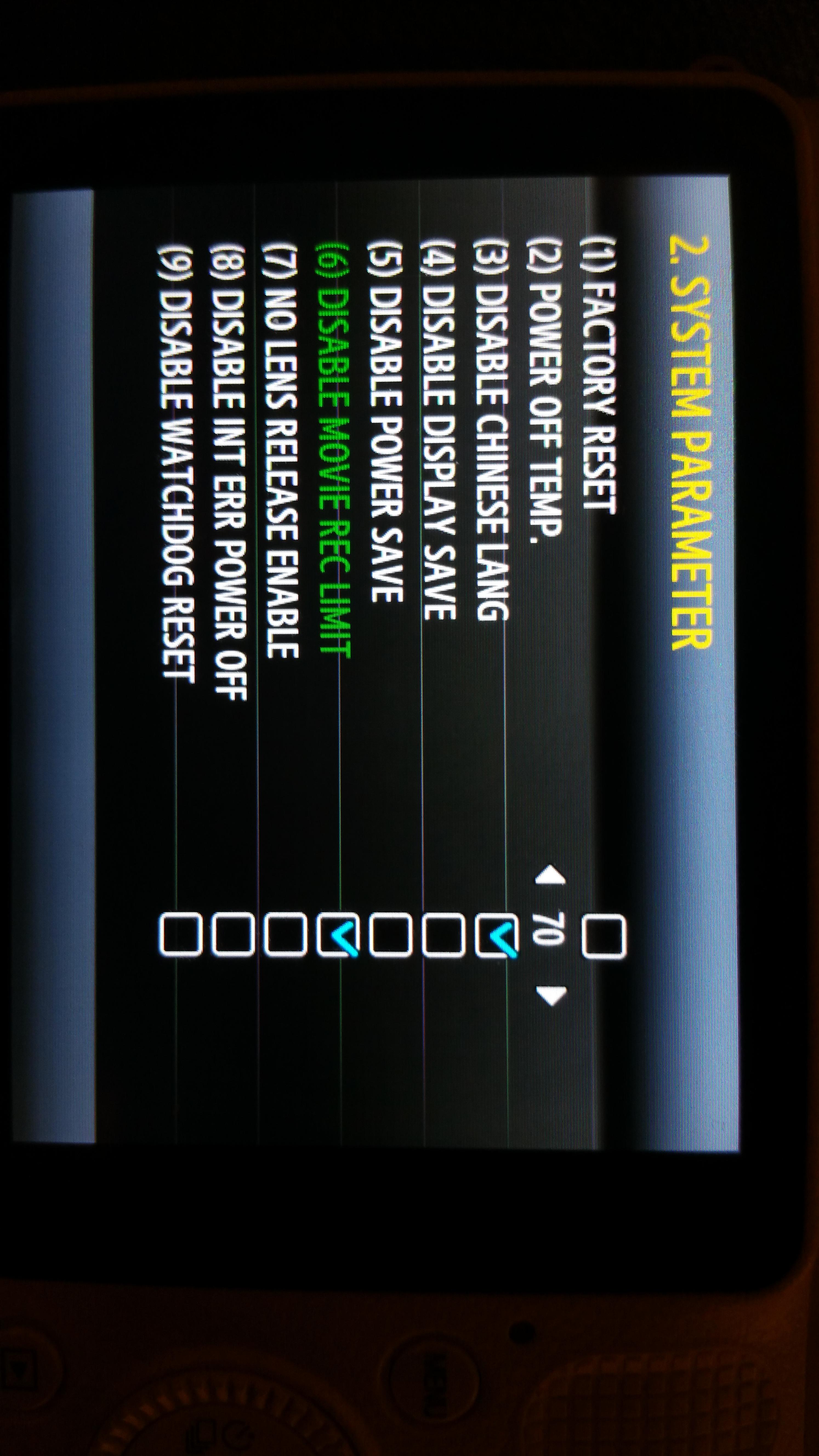

NXThink Posted March 21, 2016 Share Posted March 21, 2016 Time limit hack works for NX30, NX300 and NX1100 for all video recording formats including 60fps 1080p. NX30 and NX300 shows 3579139 for total duration for all videos, if last two digits are decimal points, it will roughly equate to 34.67 GB corruption mark. 34.67 gb converts to 35502.08 and 35791.39 mb converts to 34.95 Gb. NX1100 had a time duration showing instead of a constant, different times for different formats. NX1100 does not have an AE button, but substituting the Trash button worked to gain access to Dev Menu. RieGo, SMGJohn, Geoff CB and 1 other 4 Link to comment Share on other sites More sharing options...

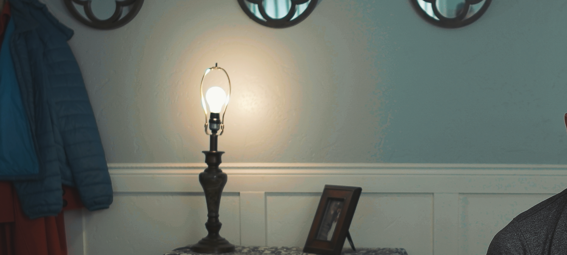

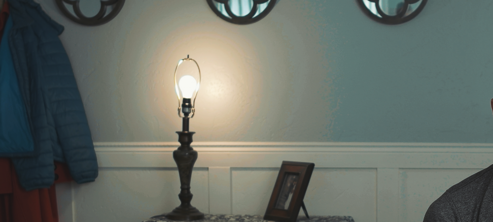

caseywilsondp Posted March 21, 2016 Share Posted March 21, 2016 9 hours ago, SR said: I wonder how the higher bit rate affects the 120p 1080p mode. Any tests? not 120, but here is 60fps 1080p internal vs high bit ratehttp://www.eoshd.com/comments/topic/18661-your-ideal-nx1-settings/?do=findComment&comment=129594 3 hours ago, lucabutera said: With Shogun 8-bit 4.2.2 the problem of banding and macroblock it is still evident on in one color backgrounds. The problem turns up in the time of color correction I'm not entirely sure the camera is outputting 422. 8bit 422 on other dslrs produce much less banding which leads me to believe the nx1 is outputting 8bit 420 over hdmi. macroblocking is precisely what increased bitrate will help us with, however. 80mbps: 600 mbps: clearly here is some jpeg compression from the upload and its a major crop of the origional, but the difference i think is clear. higher bit rates = less macroblocking and more fine detail. it will not significantly reduce banding, we need 422 and ideally 10bit+ for that. SMGJohn and lucabutera 2 Link to comment Share on other sites More sharing options...
