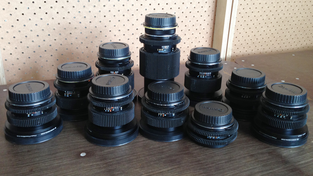

JaeM Posted February 11, 2015 Share Posted February 11, 2015 Here's a set I'm slowly collecting / modifying.Pentax SMC Takumars:17mm f424mm f3.535mm f250mm f1.4 - 7 element50mm f1.4 - 8 element55mm f1.885mm f1.8105mm f2.8135mm f2.5200mm f4I've de-clicked them, had 3d printed focus and aperture gears fitted and lightly grub screwed, shimmed them all for infinity focus with EOS adapters, and have 80mm fronts on all but the 17mm. Yes, they're a bit slow at either end, but with an A7s, plenty of fun to be had. Amro Othman, JazzBox, Cinegain and 1 other 3 1 Link to comment Share on other sites More sharing options...

mojo43 Posted February 12, 2015 Share Posted February 12, 2015 Here's a set I'm slowly collecting / modifying.Pentax SMC Takumars:17mm f424mm f3.535mm f250mm f1.4 - 7 element50mm f1.4 - 8 element55mm f1.885mm f1.8105mm f2.8135mm f2.5200mm f4I've de-clicked them, had 3d printed focus and aperture gears fitted and lightly grub screwed, shimmed them all for infinity focus with EOS adapters, and have 80mm fronts on all but the 17mm. Yes, they're a bit slow at either end, but with an A7s, plenty of fun to be had. Please tell me more about the 3d printed focus and aperture gears? How do I go about getting them for my own set of lenses? IronFilm 1 Link to comment Share on other sites More sharing options...

IronFilm Posted February 13, 2015 Share Posted February 13, 2015 JaeM: why did you decide to go with Pentax over anything else? Link to comment Share on other sites More sharing options...

JaeM Posted February 14, 2015 Share Posted February 14, 2015 Please tell me more about the 3d printed focus and aperture gears? How do I go about getting them for my own set of lenses?http://www.ebay.com/itm/Seamless-Follow-Focus-Gear-for-Iscorama-54-Lens-/261668990574?pt=LH_DefaultDomain_0&hash=item3cecafee6eThis seller can custom make them for you - just get in touch with him and provide the dimensions he needs - they're pretty much a perfect fit, I grub screw them in place so that there is no slippage at all. Link to comment Share on other sites More sharing options...
JaeM Posted February 14, 2015 Share Posted February 14, 2015 JaeM: why did you decide to go with Pentax over anything else?They're bloody well made - solid enough to hold my IscoramasThey're also less common as a set than Zeiss and Leicas, which local DPs have in abundance near me.Plus they're characterful and cheap, and reasonably consistent.I've got a wide range of Helios, Tair, Zenit bla bla blas that make a 'set', but they're very wacky, and not consistent at all.Cameras are for christmas, Lenses are for life. sudopera and IronFilm 2 Link to comment Share on other sites More sharing options...
