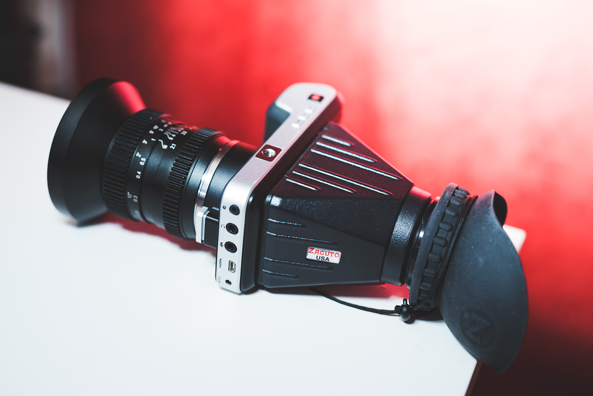

Two of the most exciting lenses for GH4 and BMPCC users at Photokina were the SLR Magic 10mm T2.1 and the Voigtlander 10mm F0.95. The SLR Magic wide angle is now available and gives you back your 24mm wide-end in 2.3x 4K mode. You could view it as an upgrade to the well regarded 12mm T1.6. Compared to the Voigtlander it has the advantage of less chromatic aberration, a stepless aperture and focus gearing designed for video use. Other than that it's hard to do a detailed comparison because the F0.95 isn't out yet!
I put the lens through its paces in Berlin and here are the results.
Read the full review
There is much to be excited about considering this lens and I have a lot of faith in the quality of SLR products. Informative article and wonderful video, needs Peter Buck song! (just saying) :) I also like the look of the viewfinder paired with the BMPocket, just seems like a fun way to shoot. Can I assume you are using that octopus looking thing for stabilization?
