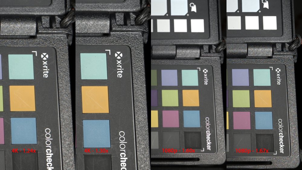

amweber21 Posted October 27, 2022 Share Posted October 27, 2022 On 10/26/2022 at 8:15 AM, Andrew Reid said: Cinema DNG is the key to the Fp. Even in 8bit. It doesn't have the squeaky clean and processed look of BRAW and ProRes RAW. I may try the 2K on the Fp-L and see if it's any good. The file sizes in 4K are a bit of an issue. You'll want to shoot with a 1.67x crop or higher if possible. That seems to be the point where it oversamples the image. Up from the 1.30x of UHD I'm guessing due to the extra processing required to downsample further to 1080p. I could swear the full width 1080p has been improved since I first got the camera. Maybe they snuck it in with a firmware, but the improvement is still clear at 1.67x. Higher 1080p frame rates will require it 1.67x or higher anyway. 12bit to an SD card is also nice. Link to comment Share on other sites More sharing options...
Administrators Andrew - EOSHD Posted October 27, 2022 Author Administrators Share Posted October 27, 2022 40 minutes ago, amweber21 said: You'll want to shoot with a 1.67x crop or higher if possible. That seems to be the point where it oversamples the image. Up from the 1.30x of UHD I'm guessing due to the extra processing required to downsample further to 1080p. I could swear the full width 1080p has been improved since I first got the camera. Maybe they snuck it in with a firmware, but the improvement is still clear at 1.67x. Higher 1080p frame rates will require it 1.67x or higher anyway. 12bit to an SD card is also nice. The Fp-L starts oversampling around 1.37x And looks very nice and crisp up to around 2x, maybe even a bit further The full frame and 1.1/1.2x crops are binned but still look very nice. I just wish it had a 2.8K RAW mode oversampled from 4K RAW to save on file size. Link to comment Share on other sites More sharing options...

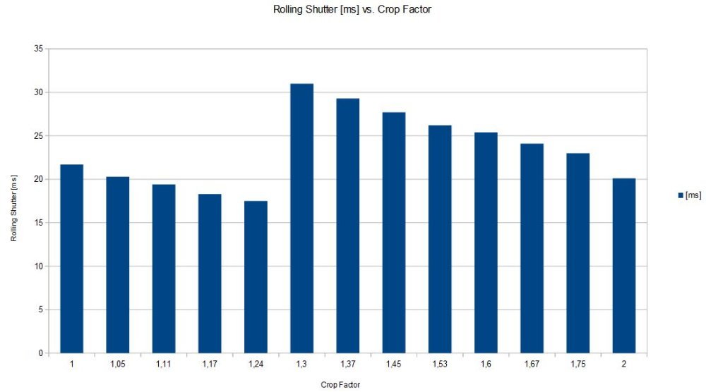

amweber21 Posted October 27, 2022 Share Posted October 27, 2022 13 minutes ago, Andrew Reid said: The Fp-L starts oversampling around 1.37x And looks very nice and crisp up to around 2x, maybe even a bit further The full frame and 1.1/1.2x crops are binned but still look very nice. I just wish it had a 2.8K RAW mode oversampled from 4K RAW to save on file size. You can see the jump at 1.30x based on this rolling shutter graph, but you're right, it looks great all the way to 2.5x. Haven't seen any evidence for 1.67x on 1080p, outside of my own observations. Give it a try if you're doing any testing. I'd be curious if you notice anything also. I've sent a request to Sigma for something similar. 2.5K-2.8K would allow up to 60p 12bit right around the bandwidth of current 4K 30p and a big improvement on 1080p. 2.4:1 4K should also allow full 1.0x width shooting based on the amount of data needed to be read off. Link to comment Share on other sites More sharing options...

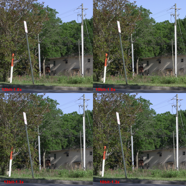

amweber21 Posted October 27, 2022 Share Posted October 27, 2022 Here was my test on 4K crops at 100%. 1.0x looks okay, but some heavy aliasing. Probably okay if finishing in 1080p. Clean at 1.3x and on. No problem in 10bit or 8bit. So I will drop to 10bit if I need to stay wider. 10bit still has fantastic flexibility. Noticed something similar in 1080p but needed an even higher crop. Don't have any test shots to show though. The bitrate didn't seem to affect it, however. Still showed up at 10 and 8bit for whatever reason. Link to comment Share on other sites More sharing options...
Administrators Andrew - EOSHD Posted October 27, 2022 Author Administrators Share Posted October 27, 2022 Are those 1.3x? You need to go 1.37x before the oversampling kicks in. Link to comment Share on other sites More sharing options...
amweber21 Posted October 27, 2022 Share Posted October 27, 2022 32 minutes ago, Andrew Reid said: Are those 1.3x? You need to go 1.37x before the oversampling kicks in. Yeah, it's with 1.30x. Anything 1.24x and lower is definitely skipped in 12bit mode. Sigma's fp lead Wakamatsu gave recommendations for crops: For the best Resolution, x1.3 – 2.48 For phase detection AF, x1.0 and x1.53 For best dynamic range, x1.24 majoraxis 1 Link to comment Share on other sites More sharing options...
Administrators Andrew - EOSHD Posted October 27, 2022 Author Administrators Share Posted October 27, 2022 Interesting that he would give 1.24 for best dynamic range, do you have a link to the interview with Wakamatsu? Maybe the binning / oversampling different in SSD DNG 12bit vs internal 8bit DNG? However your 1.30x shots look pixel binned and all the same detail. Different sharpening maybe. From memory of my tests the other month, I am 99% sure it needs to be at 1.37x and anything less is similar in detail to the 1.0x full frame. Maybe Wakamatsu's ghost writer got the numbers slightly wrong... Someone also needs to tell him to get back to work from the motorbike track and put a LOG profile in there pronto 🙂 Wonder what the deal is with that still not being in? And an articulated screen would also be a great edition to future entries. Link to comment Share on other sites More sharing options...
amweber21 Posted October 28, 2022 Share Posted October 28, 2022 1 hour ago, Andrew Reid said: Interesting that he would give 1.24 for best dynamic range, do you have a link to the interview with Wakamatsu? Maybe the binning / oversampling different in SSD DNG 12bit vs internal 8bit DNG? However your 1.30x shots look pixel binned and all the same detail. Different sharpening maybe. From memory of my tests the other month, I am 99% sure it needs to be at 1.37x and anything less is similar in detail to the 1.0x full frame. Maybe Wakamatsu's ghost writer got the numbers slightly wrong... Someone also needs to tell him to get back to work from the motorbike track and put a LOG profile in there pronto 🙂 Wonder what the deal is with that still not being in? And an articulated screen would also be a great edition to future entries. It was from cined's review of the fp L when it was first launched: https://www.cined.com/sigma-fp-l-review-and-sample-footage/ They were collaborating with Wakamatsu regarding the testing. Not sure how 1.24x gives the best dynamic range, but from the testing it gives the best rolling shutter which makes sense. In a later interview they retracted their promise on a log profile stating it was a hardware limitation, so that looks to be all but dead. Here's a quick visual to show the crossover point on both 4K and in 1080p. 1.30x for 4K and 1.67x for 1080p. No adjustments outside of the crop function. Should show the huge fine detail increase in both. Link to comment Share on other sites More sharing options...
