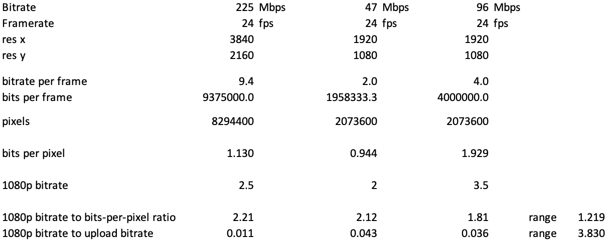

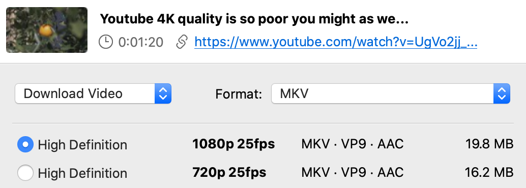

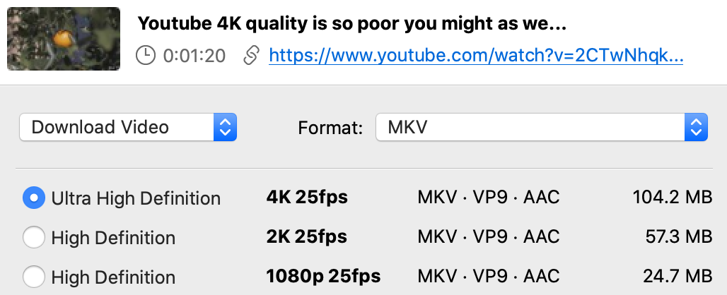

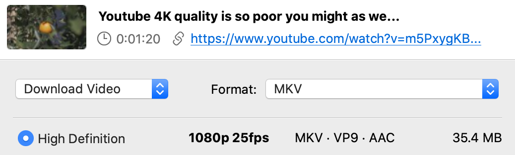

kye Posted September 7, 2020 Author Share Posted September 7, 2020 Here's some data... Original 4K upload 225Mbps: 1080p upload 47Mbps: 1080p upload 96Mbps: So: 4K at 225Mbps upload gives a 1080p stream at 2.5Mbps 1080p at 47Mbps upload gives a 1080p stream at 2.0Mbps 1080p at 96Mbps upload gives a 1080p stream at 3.5Mbps I'm willing to call that conclusive.. Uploading at a higher resolution is not the answer to people watching in lesser resolutions. Link to comment Share on other sites More sharing options...
kye Posted September 7, 2020 Author Share Posted September 7, 2020 Here are the videos if you are curious to pixel peep... 4K 225Mbps: 1080p 47Mbps: and 1080p 96Mbps: Link to comment Share on other sites More sharing options...

Neumann Films Posted September 7, 2020 Share Posted September 7, 2020 @kye, that seems to tell me that the way to get YouTube to encode and show the highest quality stream (ie. the largest file) is the 4K version, right? The 4K version was over 100MB while the largest 1080p was 35. For me, there are two things to consider. The file size and the viewport. The quality/resolution setting should be viewed more like a data rate setting. Your viewport is your viewport, 720p, 1080p, or 2160p. You can choose to view a 35MB file in said viewport, a 100MB file or a 200+MB file (with 8K). I'm not the most technically minded person so I very well could just be missing something super obvious. To me it seems like the larger the file size>more data rate>better stream/encode. Link to comment Share on other sites More sharing options...
Neumann Films Posted September 7, 2020 Share Posted September 7, 2020 29 minutes ago, kye said: 4K at 225Mbps upload gives a 1080p stream at 2.5Mbps 1080p at 47Mbps upload gives a 1080p stream at 2.0Mbps 1080p at 96Mbps upload gives a 1080p stream at 3.5Mbps I just re read your comment and I do think I know what you're saying now (and that you're correct...I think). I'm pretty sure I'm trying to make a different/alternate point. My point has more to do with 8K vs. 4K. vs. 1080p, not 8K (1080p setting) vs. 4K (1080p setting) vs. 1080p Original. Does that make sense? I'm more concerned with the 100MB file that the 4K at 225Mbps gives you vs. what the 1080p re encode of that file gives you. It is odd that YouTube encodes a 1080p proxy from a 4K file more strictly than it does a 1080p direct upload. It also makes sense though, the more proxies they have to make the more data required for each video. An 8K upload requires a whopping NINE proxies. 8K/4K/1440p/1080p/720p/480/360/240/144. From a storage/bandwith point of view it makes sense to give encoding priority to the highest/native resolution and then choke the lower ones. Link to comment Share on other sites More sharing options...
kye Posted September 7, 2020 Author Share Posted September 7, 2020 16 minutes ago, KnightsFan said: I haven't used YouTube in many years, but here are two facts: 1. YouTube re-encodes everything you upload 2. The more data an encoder is given, the better the results While the 1080p bitrate is the same for the viewer whether you uploaded in 4k or HD, it's possible (but not a given) that any extra information that YouTube's encoder is given makes a better 1080p file. Though my intuition is that the margin there is so small, uploading in 4k will not give any perceptible difference for people streaming in 1080p. 1) yes, 2) not necessarily. The 4K file was uploaded at over twice the bitrate as the better 1080p upload, yet the 1080p from it was only 70%. It might be that a 4K reference file might give a slightly better IQ per bitrate stream, that 'bump' is competing with a 70% bitrate, and considering we're talking FHD at 2.5Mbps - I'd think the bitrate would win. Just now, Neumann Films said: @kye, that seems to tell me that the way to get YouTube to encode and show the highest quality stream (ie. the largest file) is the 4K version, right? The 4K version was over 100MB while the largest 1080p was 35. No. The 4K file was uploaded at over twice the bitrate as the better 1080p upload, yet the 1080p from it was only 70%. Judging from this, the logical conclusion is that more bitrate at the same resolution helps, and the same bitrate at a higher resolution HURTS. I suspect that YT might be looking at bitrate-per-pixel, which would explain why the 47Mbps 1080 was closer to the 225Mbps 4K file. Let's summarise that again, but looking at bitrate-per-pixel: Notice that the bits-per-pixel matches much more closely than the absolute bitrate.. still some variation, but much closer. Link to comment Share on other sites More sharing options...
kye Posted September 7, 2020 Author Share Posted September 7, 2020 36 minutes ago, Neumann Films said: I just re read your comment and I do think I know what you're saying now (and that you're correct...I think). I'm pretty sure I'm trying to make a different/alternate point. My point has more to do with 8K vs. 4K. vs. 1080p, not 8K (1080p setting) vs. 4K (1080p setting) vs. 1080p Original. Does that make sense? I'm more concerned with the 100MB file that the 4K at 225Mbps gives you vs. what the 1080p re encode of that file gives you. It is odd that YouTube encodes a 1080p proxy from a 4K file more strictly than it does a 1080p direct upload. It also makes sense though, the more proxies they have to make the more data required for each video. An 8K upload requires a whopping NINE proxies. 8K/4K/1440p/1080p/720p/480/360/240/144. From a storage/bandwith point of view it makes sense to give encoding priority to the highest/native resolution and then choke the lower ones. I agree that a 4K upload watched at 4K is WAY better than a 1080p upload watched at 1080p. Absolutely. The challenge with uploading 6K and 8K is that people won't watch at 6K or 8K, they'll watch at 4K or 1080p. It's kind of like me saying that you're going to love my new video because I shot it in 25K, and you have to watch it in 25K or you'll miss out. Not going to happen. At some point you have to optimise your viewing experience for the people watching, rather than the best possible experience if a viewer sells their car to setup a system. For many that's people watching in 4K, for most it's people watching in 1080p, or even 720p. Neumann Films 1 Link to comment Share on other sites More sharing options...

KnightsFan Posted September 7, 2020 Share Posted September 7, 2020 25 minutes ago, kye said: 1) yes, 2) not necessarily. The 4K file was uploaded at over twice the bitrate as the better 1080p upload, yet the 1080p from it was only 70%. It might be that a 4K reference file might give a slightly better IQ per bitrate stream, that 'bump' is competing with a 70% bitrate, and considering we're talking FHD at 2.5Mbps - I'd think the bitrate would win. My second fact wasn't about whatever YouTube is doing, I was just stating that encoders almost universally do better with more input data. So if in YouTube's case the quality is lower from the 4K upload, then they must be encoding differently based on input file--which would not be surprising actually. So I have no idea what YouTube is actually doing, I'm just explaining that it's possible @fuzzynormal does see an improvement. Link to comment Share on other sites More sharing options...

kye Posted September 7, 2020 Author Share Posted September 7, 2020 4 hours ago, KnightsFan said: My second fact wasn't about whatever YouTube is doing, I was just stating that encoders almost universally do better with more input data. So if in YouTube's case the quality is lower from the 4K upload, then they must be encoding differently based on input file--which would not be surprising actually. So I have no idea what YouTube is actually doing, I'm just explaining that it's possible @fuzzynormal does see an improvement. I have bolded the most significant word in your post... "almost" 😂😂😂 I suspect that YouTube might make some kind of allowance for making 1080p videos better in 1080 than 4K videos are, as there's kind of a relationship between upload resolution and who watches stuff. People that have channels with nothing to do with aesthetics aren't likely to chase the highest resolutions. There will be exceptions of course, but as a general principle I think it holds up. I expect that @fuzzynormal probably does see a difference. I can see a difference, and once I learned where to look and what to look for, I think I could probably see that difference even if there weren't comparable shots. Perhaps the most interesting thing about this thread is that there wasn't consensus about if it was visible, or for those who had a preference, which one was even best. I think it's one of those things where being right doesn't necessarily align you with popular opinion, and it may not actually give you any kind of advantage in the end anyway. By the time we factor in all the overheads, which may be hidden for many people at this point but are real nonetheless, I think that for many 4K isn't worth it. 32 minutes ago, newfoundmass said: I'm not sure how you'd test this, but I have heard that certain channels, particularly ones with a lot of subscribers, get higher quality encoding and improved audio quality. If true I wonder how much of a bump those channels get? That's easy.. we'll all need to go on a prolonged campaign to blow up my channel and get it to a million subs, then I promise I'll do the test 🙂 newfoundmass 1 Link to comment Share on other sites More sharing options...
