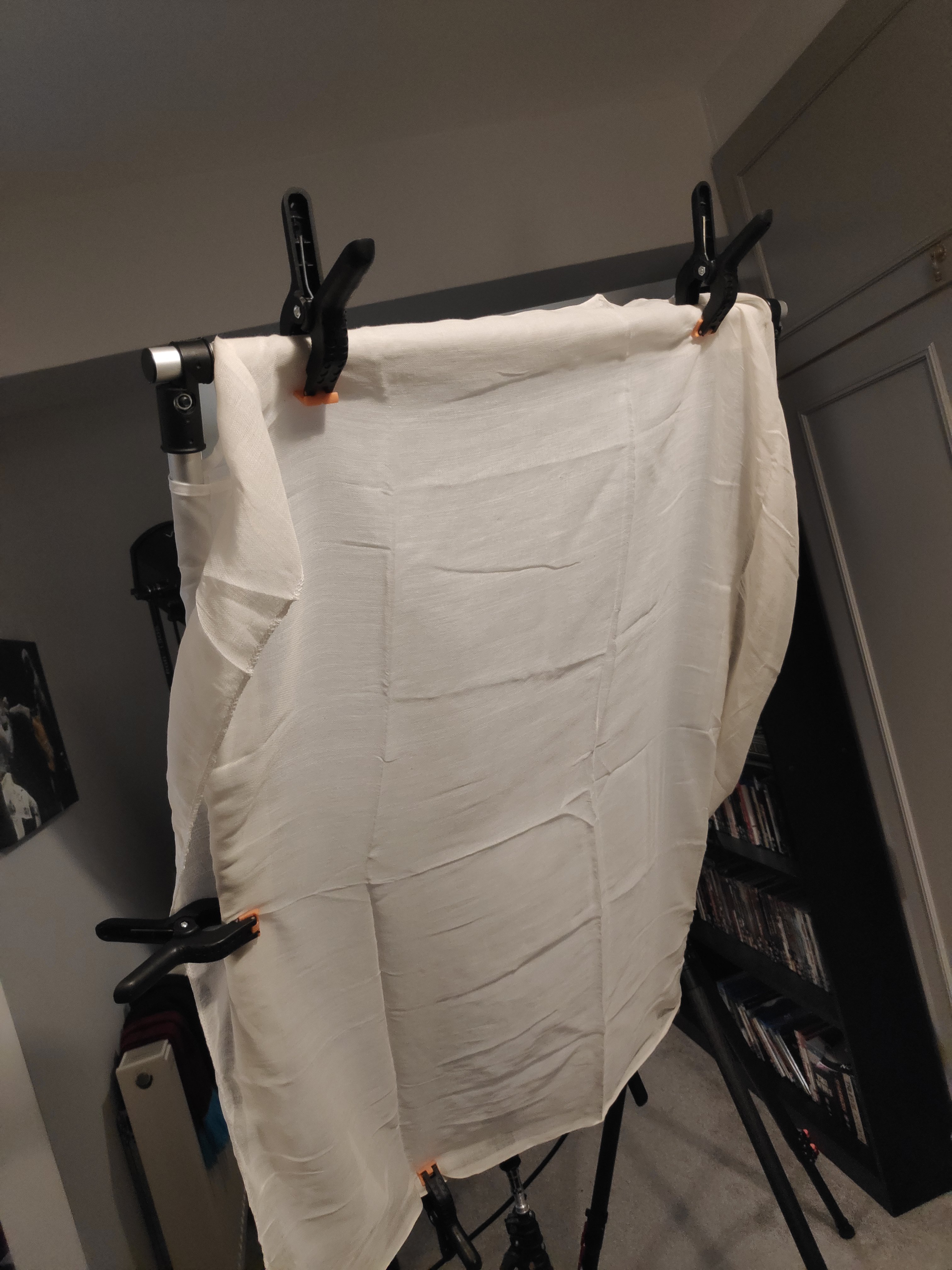

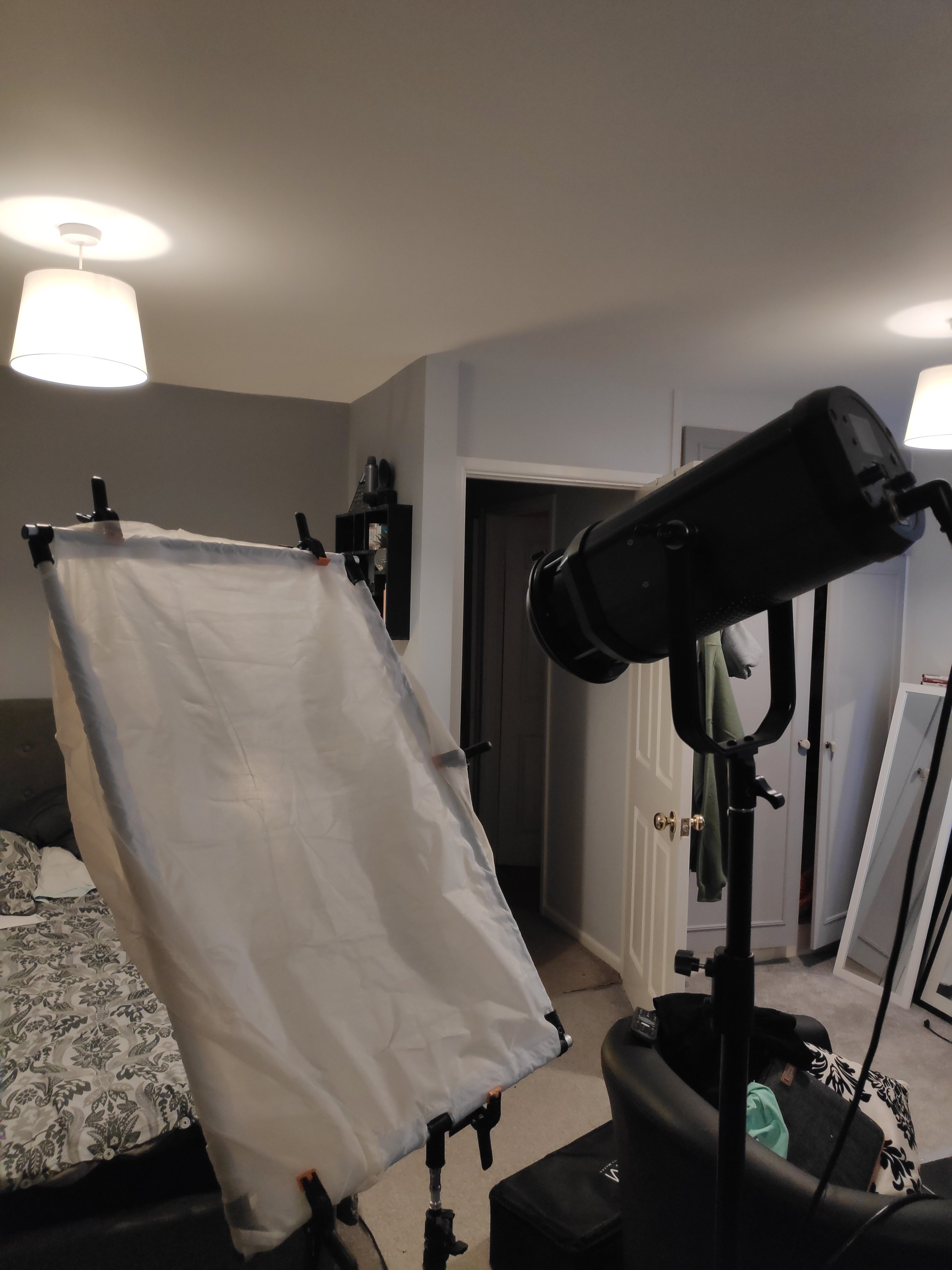

AlexTrinder96 Posted April 5, 2020 Share Posted April 5, 2020 Another possibility... you could use a softbox and grid on your light panel to soften and control the light, then have it push through a second diffuser frame/panel etc. The grid will help combat the spill. I bought this frame for around £35 on amazon a few years back. Unbleached muslin on top of the standard diffusion. https://www.ebay.co.uk/itm/Light-Reflector-5in1-Flag-Panel-80x100cm-Photography-Multi-Studio-Frame-Diffuser/372671319007?hash=item56c4f10bdf:g:tgAAAOSwkLtc3WAS quick and dirty test with the setup Best of luck mate heart0less and Dustin 2 Link to comment Share on other sites More sharing options...
