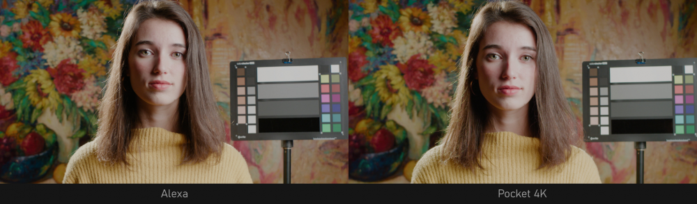

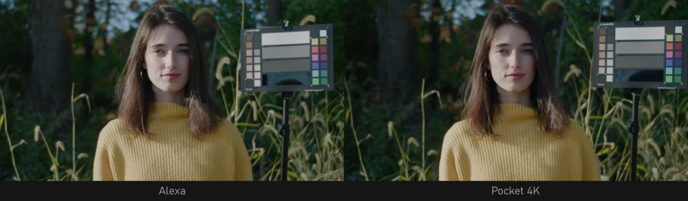

Popular Post Sage Posted November 26, 2019 Popular Post Share Posted November 26, 2019 "Pocket 4K footage is precisely transformed to match the color science of the Arri Alexa, without compromise. This is achieved without artifacts, while introducing a smooth, organic rolloff." For the better part of the last year, I've been working to map the color of P4K BMDFilm to match my Alexa's LogC, as measured under sunlight and halogen. To do this, I wrote an interpolation program in C++ that can accept an enormous amount of data (~40k samples per camera), and interpolate smooth internal contours, or 'waves' between them. Exposure compensation conversions were made with the same interpolation engine (transforms replicating sensor color response with variant exposure). Another significant element of the project was to recreate Arri's Rec709 to maintain the entirety of recorded LogC gamut, in a film-derived envelope (for the display variations). This was particularly difficult, as the correct RGB primary behavior needed to be exactly replicated within contiguous 709, but smoothly diverge to HDR-like handling of far gamut (where Arri's Rec709 ends). This new envelope (EC Gen.4) is particularly impressive, and I may release it for the Arri, as it is significantly preferable to normal Arri Rec709. P4Ka PDF Emotive Color heart0less, austinchimp, Ishak Sahertian and 13 others 7 9 Link to comment Share on other sites More sharing options...
Shell64 Posted November 26, 2019 Share Posted November 26, 2019 Bro you got it to match perfectly. They look the same! If I ever get this camera I’m picking up this out for sure! Thanks a lot for these awesome LUTs. Sage 1 Link to comment Share on other sites More sharing options...
Sage Posted November 26, 2019 Author Share Posted November 26, 2019 2 minutes ago, Shell64 said: Bro you got it to match perfectly. They look the same! If I ever get this camera I’m picking up this out for sure! Thanks a lot for these awesome LUTs. Thanks so much Shell! Gen.4 is on a new level, and GHa really needs it. I intend to bring Gen.4 to GHa very soon deezid and Shell64 2 Link to comment Share on other sites More sharing options...

majoraxis Posted November 26, 2019 Share Posted November 26, 2019 @Sage Incredible job! I actually like the Pocket 4K version better, though they are very, very, very, close. Congratulations - this is quite an accomplishment! Sage 1 Link to comment Share on other sites More sharing options...
Sage Posted November 26, 2019 Author Share Posted November 26, 2019 13 minutes ago, majoraxis said: @Sage Incredible job! I actually like the Pocket 4K version better, though they are very, very, very, close. Congratulations - this is quite an accomplishment! Thanks so much Majoraxis! Its been quite a journey Link to comment Share on other sites More sharing options...
