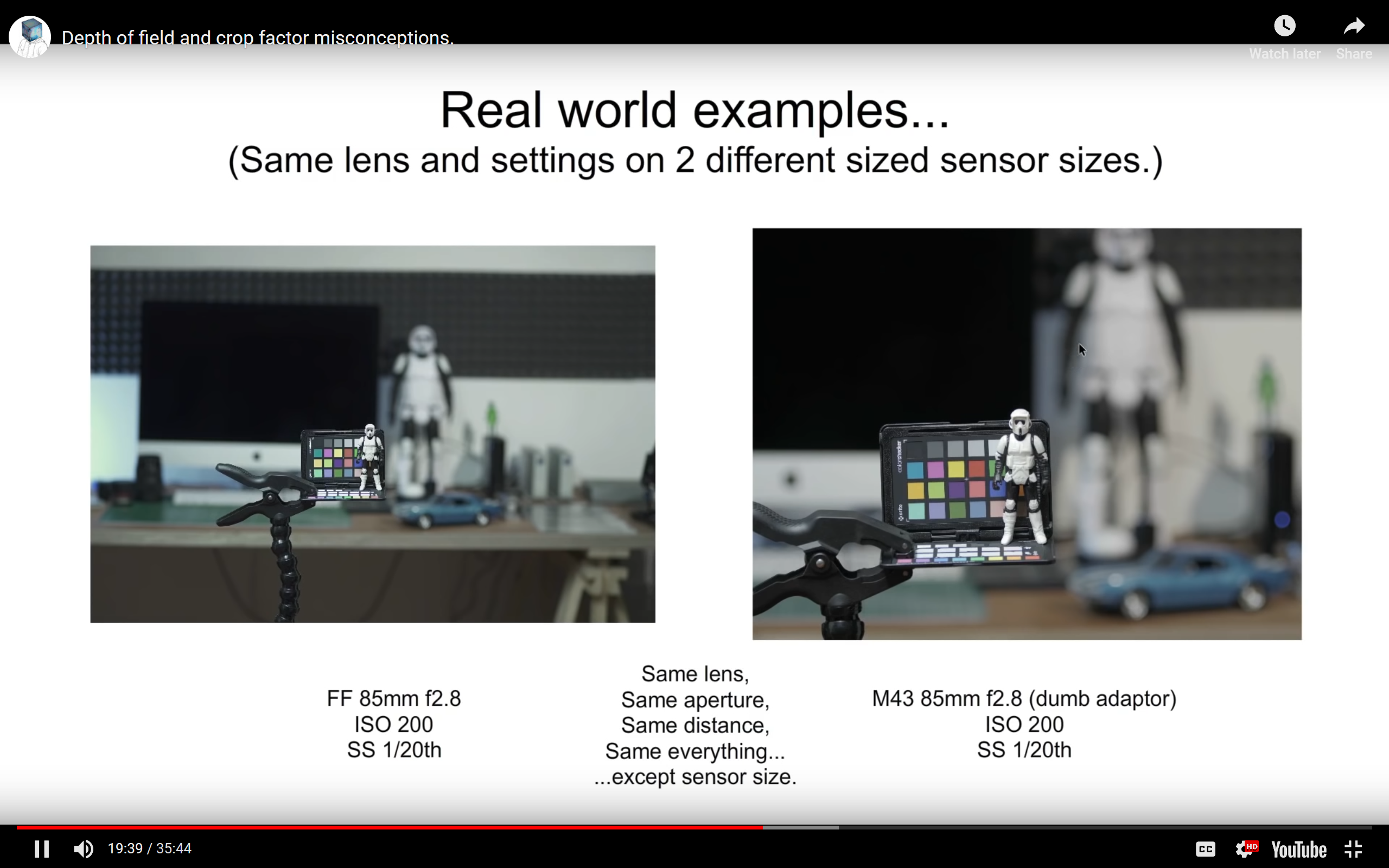

webrunner5 Posted June 29, 2019 Share Posted June 29, 2019 This video sort of, well kind of proves, but shows MF to M4/3 really using an equivalent lens all look the same. There is no Magic MF look. You can use any camera and make stuff work. Link to comment Share on other sites More sharing options...
Administrators Andrew - EOSHD Posted June 29, 2019 Administrators Share Posted June 29, 2019 What an obnoxious bird brained bro, the guy in this video Anybody can make a large sensor look like a smaller one by massively stopping down a lens! The harder part is finding glass fast enough for a small sensor to make it look as good as a large sensor and having it render the same. On the GH5 for example, yes you can make it look the same as full frame, but you need F0.95 to get F2 full frame look... Or a Speed Booster. This can all end up relatively expensive. On full frame you can stick a bunch of cheap 50mm F2 lenses on there and immediately for £50 you have a very nice rendering for portraits. In addition, all glass is designed with a specific sensor size in mind... And all lenses render differently, some vastly different. The Kern Switar 26mm F1.1 for instance has a unique look, and only on Micro Four Thirds and Super 16mm. Put it on full frame and it's not usable, the end. Yes, for crop sensors a Speed Booster adapter is great as we know... on this site and forum we were the first people in the world to make use of it en-masse for video... But it does have its limitations for landscape and wide angle shooting where the frame edges need to be sharp at fast apertures. You need to stop right down for the edges. For this, medium format fast primes are a much better choice on something like a GFX 50R. Then also conveniently ignored in the video (ignorance is bliss)... The fastest medium format prime from Fuji right now may be F2, but you can put a shitload of full frame glass on it via an adapter, with no vignetting... and you see into the corners of vintage full frame glass on the larger sensor for the first time in photographic history. Instant new look, it's revelatory. Canon FD 85mm F1.2L on the 50S and 50R is stunning and you CANNOT mimic the same rendering, or even the amount of DOF on a camera with an APS-C or Micro Four Thirds sensor... Speed Booster or no Speed Booster. Fucking clickbait. I hate it. It's creating a deep well of misinformation that takes years to clear up and pushes people into bad decisions and bad misconceptions, all because some twit at Fstoppers wants a few extra bucks in ad revenue. And I hate that clickbait routinely wins the most attention, the most discussion and the most views on YouTube and elsewhere, whereas content creators and actual pro filmmakers are putting quality stuff out there and don't have a fraction of the same attention. If anything is more annoying than a lack of talent, it's a rewarded lack of talent. Link to comment Share on other sites More sharing options...
