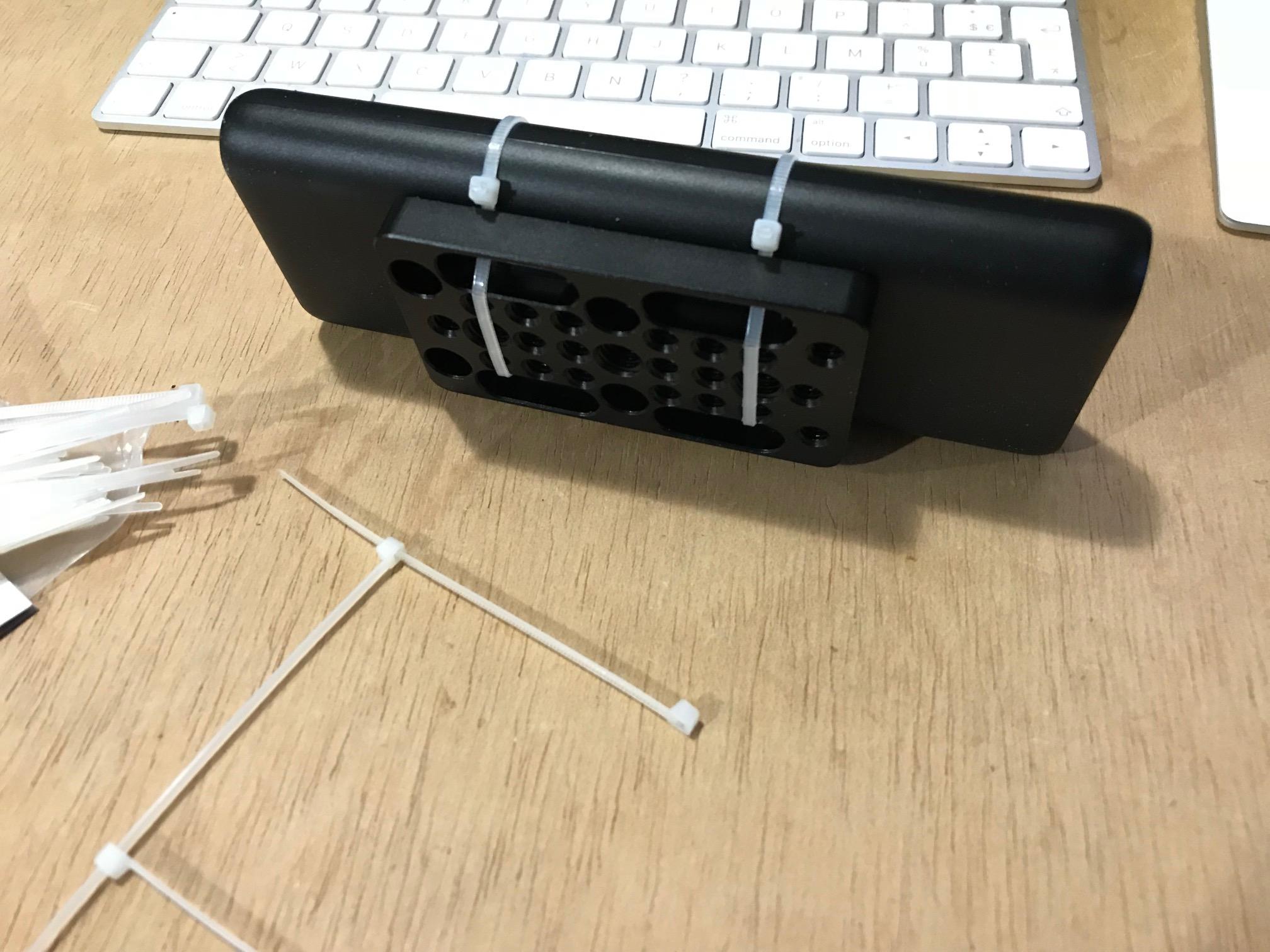

BrunoCH Posted January 27, 2019 Share Posted January 27, 2019 @Attila Bakos It's a little bit off topic but not too much because the XT3 can be powered by Anker batteries. Here is the solution I found to hold my battery: https://www.amazon.fr/gp/product/B00X752FNA/ref=ppx_yo_dt_b_asin_title_o00__o00_s00?ie=UTF8&psc=1 + cable tie After just attach it to any monitor or LED holder mount. Curious to know if someone has found another solution? Link to comment Share on other sites More sharing options...
Attila Bakos Posted January 27, 2019 Share Posted January 27, 2019 25 minutes ago, BrunoCH said: @Attila Bakos It's a little bit off topic but not too much because the XT3 can be powered by Anker batteries. Here is the solution I found to hold my battery: https://www.amazon.fr/gp/product/B00X752FNA/ref=ppx_yo_dt_b_asin_title_o00__o00_s00?ie=UTF8&psc=1 + cable tie After just attach it to any monitor or LED holder mount. Curious to know if someone has found another solution? Looks good, I use this phone holder until I get something better: https://m.aliexpress.com/item/32797019174.html?trace=wwwdetail2mobilesitedetail&spider=y&productId=32797019174&productSubject=Ulanzi-IRON-MAN-II-Aluminum-Metal-Smartphone-Tripod-Mount-with-Cold-Shoe-Mount-Cell-Phone-Tripod BrunoCH 1 Link to comment Share on other sites More sharing options...
