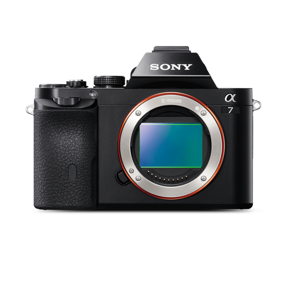

ntblowz Posted July 27, 2018 Share Posted July 27, 2018 48 minutes ago, noone said: I don't think it has much to do with the mount size but simply that the smaller the sensor, the easier it is to stabilize. Look at this photo, how much space can sensor move around without being blocked by the mount? Link to comment Share on other sites More sharing options...
webrunner5 Posted July 27, 2018 Share Posted July 27, 2018 1 hour ago, ntblowz said: Look at this photo, how much space can sensor move around without being blocked by the mount? The sensor is behind the mount. And I agree with @noone. I can clean the heck out of my A7s also without much worry. I grew up with no IBIS, no stabilized nothing. So no big deal to me. I think people try to hard to make their stuff flawless. That was sort of the character of 8mm, 16mm film. Now I am not talking shooting like a Drunken Sailor LoL, but.. Picture of the Sony A7 mk II IBIS assembly. Not sure how they fit all of that in a A7 body! Link to the tear down of the camera. https://www.lensrentals.com/blog/2015/02/the-a7ii-teardown-a-look-inside-sonys-new-camera/ Link to comment Share on other sites More sharing options...

ntblowz Posted July 27, 2018 Share Posted July 27, 2018 1 hour ago, noone said: But that doesn't affect how WELL it works, it MIGHT affect the edges for coverage (but I still am not sure). It isn't that people say the centre of Sony IBIS images are as good as M43, it is that stabilization doesn't work as well. If it WAS the mount, then I would think Sony images and video would be well stabilized in the centre and less so at the edges but that doesn't happen. The sensor can still move around behind the mount. It can't move too much since the edge will be blocked by the lens mount, so that why it was limiting how much it can compensate for movement, of course it can move what ever behind the mount but it have to be within certain axis before the light aka image get blocked by the lens mount. Perfect example will be GH5 with Speedbooster XL and Sigma 18-35mm, doing slow movement you don't see vignetting, but any big action stuff you can see dark corners because sensor is moving bigger distance to compensate big movement, but that is over the image circle provided by Sigma lens. Similar thing to Sony's IBIS, the sensor movement distance is limited by that mount, it can't move big distance to compensate for big movement like walking for example. Link to comment Share on other sites More sharing options...

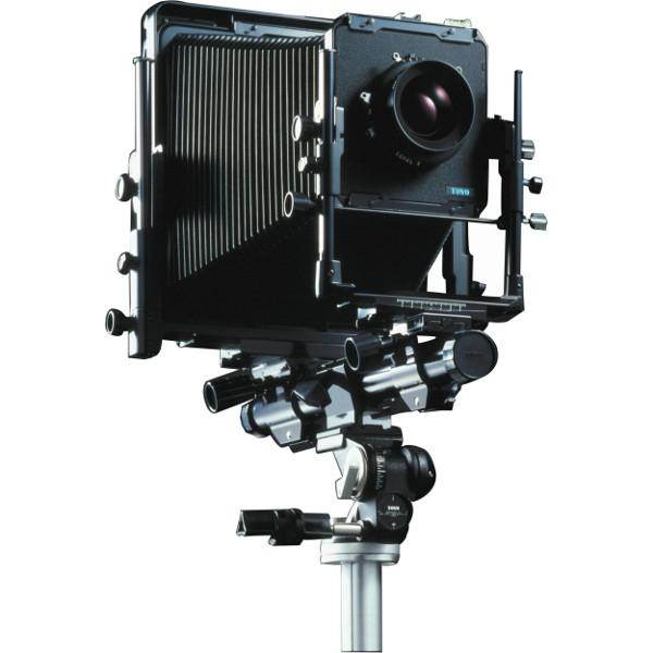

tupp Posted July 27, 2018 Share Posted July 27, 2018 @ntblowz The throat diameter of a lens mount usually has little to do with the size of the image circle from a lens. Consider an 8"x10" view camera: That relatively small lens creates an image circle that fully covers the camera's 8"x10" film. Not only that, but it has an even larger image circle than required for 8"x10", because the lens has to allow for tilt, swing and shifts. In addition, the hole in the camera's lens board is even smaller than the front element of the lens. So, even though the lens mount is a small fraction of the size of an 8"x10" sheet of film, the lens has no problem covering an area of significantly more than 8"x10". The same principle applies to smaller formats. In regards to larger sensors being easier to stabilize than smaller sensors that have less mass, that is a misguided assumption. The lower a sensor's mass, the less work required form the sensor stabilization actuators. Such an IBIS scenario is differs from the general principle that heavier cameras are more stable. With a simple heavier camera, the lens and sensor move together, so extra mass reduces overall jitter. However, with IBIS, the sensor has to be moved relative to the lens to compensate for overall jitter. Link to comment Share on other sites More sharing options...
noone Posted July 27, 2018 Share Posted July 27, 2018 56 minutes ago, ntblowz said: It can't move too much since the edge will be blocked by the lens mount, so that why it was limiting how much it can compensate for movement, of course it can move what ever behind the mount but it have to be within certain axis before the light aka image get blocked by the lens mount. Perfect example will be GH5 with Speedbooster XL and Sigma 18-35mm, doing slow movement you don't see vignetting, but any big action stuff you can see dark corners because sensor is moving bigger distance to compensate big movement, but that is over the image circle provided by Sigma lens. Similar thing to Sony's IBIS, the sensor movement distance is limited by that mount, it can't move big distance to compensate for big movement like walking for example. The sensor is not blocked by the lens mount for movement. If it moves too much it might be "blocked" for vignetting but there is room under the mount and above the sensor at least in the cameras I have seen. There may only be a small (in terms of height) space but it is certainly big enough to allow the sensor to move. If you use an APS camera, or any of the IBIS FF Sony's in crop mode there is little vignetting too (and even Canon APSC lenses made for 1.6x sensors cover FF from around 24mm and up on FF E mount). There are different types of IBIS. Pentax uses a different method to most for instance. Link to comment Share on other sites More sharing options...
UncleBobsPhotography Posted July 27, 2018 Share Posted July 27, 2018 1 hour ago, tupp said: @ntblowz The throat diameter of a lens mount usually has little to do with the size of the image circle from a lens. Consider an 8"x10" view camera: That relatively small lens creates an image circle that fully covers the camera's 8"x10" film. Not only that, but it has an even larger image circle than required for 8"x10", because the lens has to allow for tilt, swing and shifts. When it comes to the mount blocking the sensor it's obvious that the flange distance is crucial. It shouldn't be necessary to point out that scenario is completely different for a 100mm flange distance and the e-mount's 18mm. tupp 1 Link to comment Share on other sites More sharing options...
tupp Posted July 27, 2018 Share Posted July 27, 2018 5 hours ago, UncleBobsPhotography said: When it comes to the mount blocking the sensor it's obvious that the flange distance is crucial. It shouldn't be necessary to point out that scenario is completely different for a 100mm flange distance and the e-mount's 18mm. To get to the point at which the throat diameter might "block" the sensor on full frame, the flange distance has to be significantly shallower and the throat diameter has to be smaller than those of an E-mount. It's not even close (so to speak) in this case, as full frame requires a 43.27mm image circle and the throat diameter of an E-mount is 46.1mm. With the E-mount, there's plenty of room for IBIS and even for tilt/shift. Link to comment Share on other sites More sharing options...
