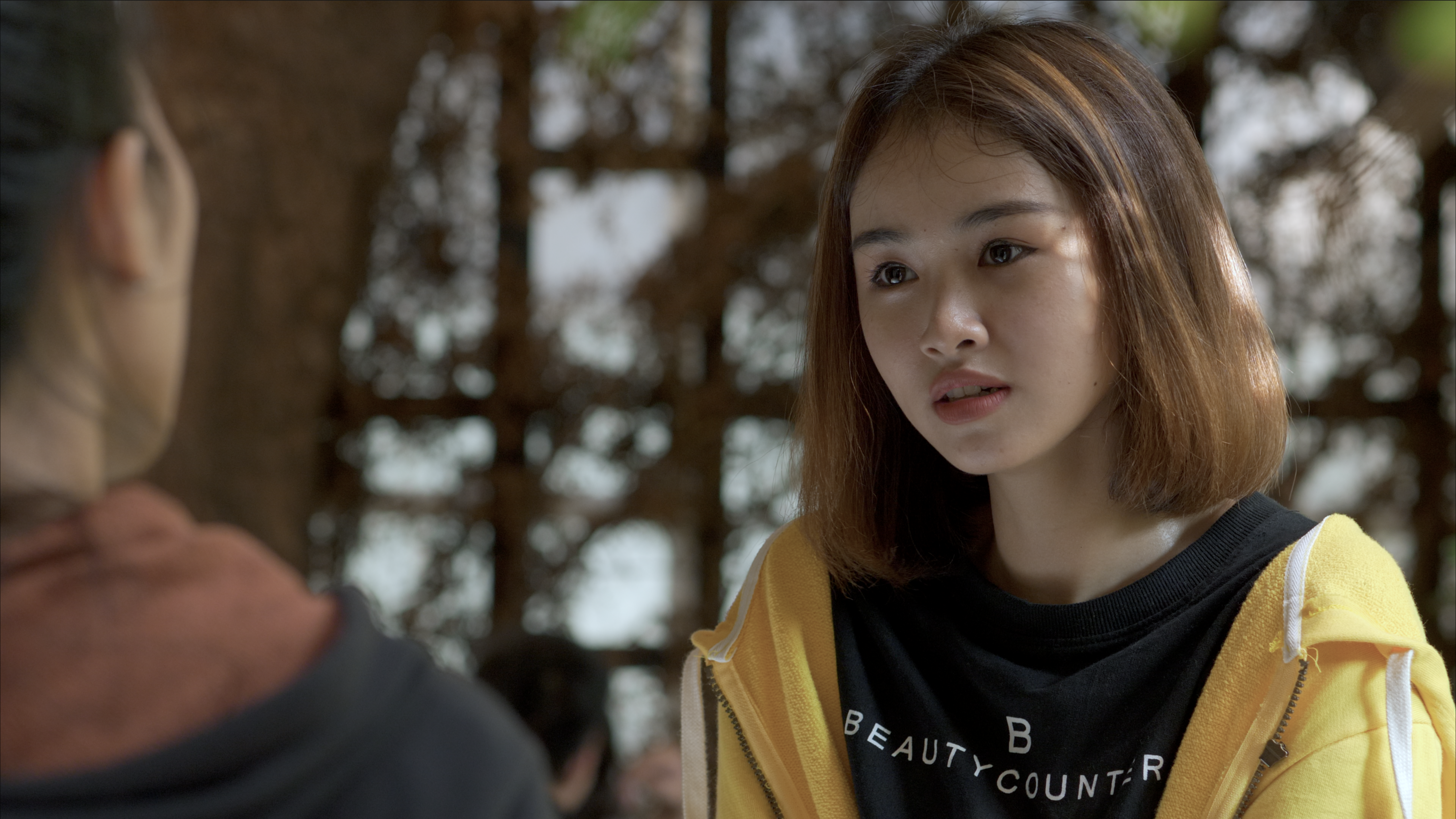

jonpais Posted May 1, 2018 Share Posted May 1, 2018 1 hour ago, Kisaha said: GH5S is not just a GH camera. In all the reviews and tests we have posted here it has the best color science of them all. First, let me correct my .9801% statement. I meant to type 98.01%, though the first figure might be more accurate. As far as GH* cameras go, the GH5 has outstanding color, even if the GH5s has better color. It's really all about the skills of the operator, color correction and grading. Lots of ppl talkin' few have examples of their own work to show. Link to comment Share on other sites More sharing options...
jonpais Posted May 1, 2018 Share Posted May 1, 2018 And here's a screen grab from a color correction tutorial I worked on this morning. Far from shitty color science. (click twice to enlarge) Link to comment Share on other sites More sharing options...
