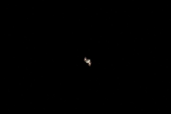

Popular Post Roberto Tolin Sommer Posted November 29, 2017 Popular Post Share Posted November 29, 2017 5 years ago i made a photo of the ISS with my GH3. I made it in photo mode with a old russian 1.000mm catadioptric lens. It was incredibly difficult to find the tiny point in the viewfinder and mantain the hight speed across the sky. I made a few dozens shots and one was sharp. It was pure luck at 1/125s. This is a 100% pixels crop. Andrew - EOSHD, webrunner5, iamoui and 9 others 11 1 Link to comment Share on other sites More sharing options...

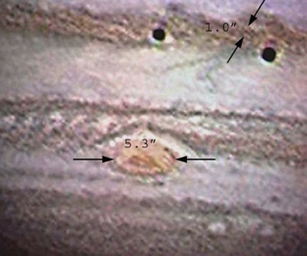

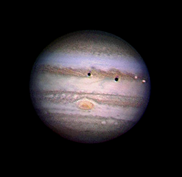

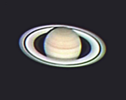

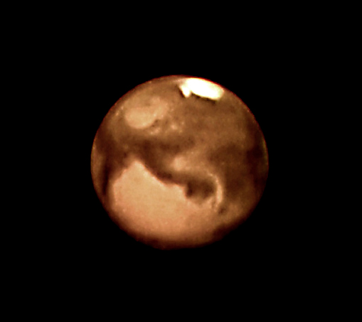

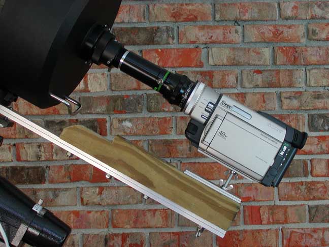

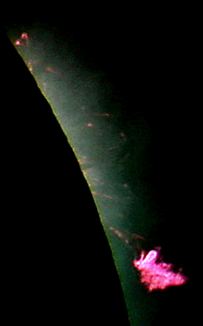

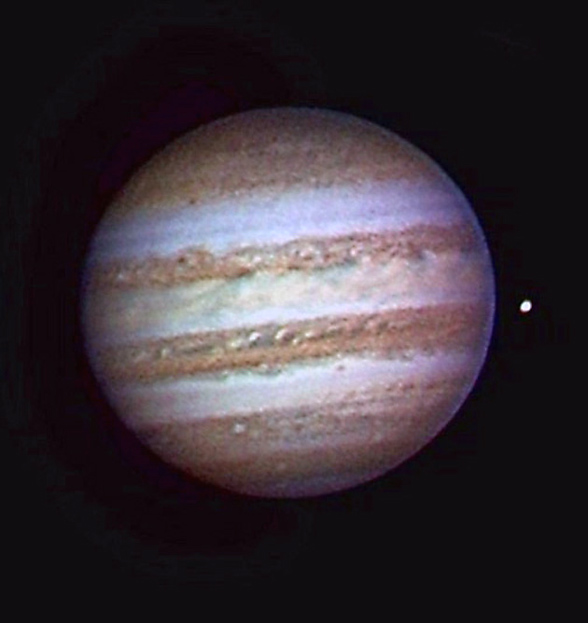

Peter Berry Posted November 29, 2017 Share Posted November 29, 2017 5 hours ago, Andrew Reid said: I know nothing about telescopes. Any info, bring it on. Here's a sort of uber-imaging setup with a 9.25" aperture/2350mm f/10 Schmidt-Cassegraine compound scope with an afocal imaging setup about 15 years ago: Sony TRV-900 3-CCD VHF camcorder with full man. controls, SS down to 1/2 sec connected to a telescope eyepiece (this is the "afocal" setup) which is connected to a 3X TC (Barlow lens in astro lingo). The Jupiter images filled about 2/3 frame height with the Sony at about 10X zoom. This method makes finding the object pretty easy zoomed out, works well in spite of the huge # of optical elements involved, and zoomed-in gives enormous mag. - maybe ~ 20-25 meters EFL @ f/100? The film clips were processed in Registax, which selected the sharpest (due to brief reductions in atmospheric turbulence), stacked 400-600, which accentuated common detail features, than a complex multistage "wavelet" sharpening routine. The first Jupiter image was from the steadiest "seeing" conditions I've ever had - in the Florida Panhandle. The Mars image at it's historic closest approach in 9/3/03, from southern Mexico. Jonny, buggz, Mark Tincho and 2 others 5 Link to comment Share on other sites More sharing options...

Administrators Andrew - EOSHD Posted November 30, 2017 Author Administrators Share Posted November 30, 2017 7 hours ago, Roberto Tolin Sommer said: 5 years ago i made a photo of the ISS with my GH3. I made it in photo mode with a old russian 1.000mm catadioptric lens. It was incredibly difficult to find the tiny point in the viewfinder and mantain the hight speed across the sky. I made a few dozens shots and one was sharp. It was pure luck at 1/125s. This is a 100% pixels crop. Amazing shot. Link to comment Share on other sites More sharing options...

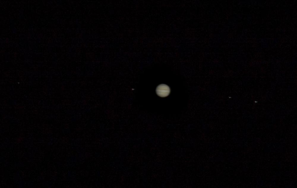

gethin Posted November 30, 2017 Share Posted November 30, 2017 its all the framing: That thing moves across the sky fast. I connected my gx85 to a mates gimbal mounted 600mmf4 with 2x teleconverter. chasing that thing accross the sky was hilarious. I thought they were all blurry , but a while later I found a couple of shots where you could discern the shape. This is jupiter shot the same night with the d810: The gx85 was shot wide open, stopping down a bit helped a lot, but M43 not great when pushing isos, so the final results from d810/ gx85 were about the same. The takehome was: plan like buggery: dont try to follow it accross the sky, use a telescope Link to comment Share on other sites More sharing options...

Roberto Tolin Sommer Posted December 1, 2017 Share Posted December 1, 2017 Another attempt with the GH3 and the 1.000mm catadripotic tele. Jupiter and four moons, Europa, Io, Ganimede and Callisto. Peter Berry, buggz and Orangenz 3 Link to comment Share on other sites More sharing options...
