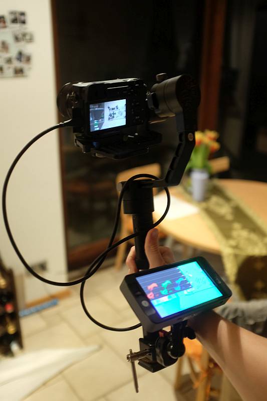

Phil A 346 Posted February 27, 2017 Share Posted February 27, 2017 On 26.2.2017 at 3:25 PM, mercer said: The screen isn't as hard to see when you set it for rec709 output while shooting 4K in sLog2. It's still faint but it's easier. Supposedly a cage will help dissipate the heat. Smallrig is releasing their a6500 cage and it looks like a great option. There probably is some type of dummy battery adapter that would help to get a major source of heat out of the camera... but I'm not sure With manual lenses, you have full 5-axis IBIS and it works really, really well, so if you plan on shooting handheld... which you will once you try it, you will not want to make your rig any heavier with an added monitor... imo. If it's the same screen dimming as the A6300, it works okish on cloudy days but if it's sunny (imagine on a tropical beach, in the desert, etc.) it's invsible. You'll want to use the EVF then or a screen loupe. About the cage, just keep in mind that you will probably not be able to balance the camera with the native lenses (16-50mm kit, 35mm 1.8, etc) on a gimbal if you put it in a cage. At least I can't get the A6300 in SmallRig cage balanced on the Zhiyun Crane. By the way, the A6500 is supposed to show the overheating warning but not shut down like the A6300. That's how I use it, just waiting on my UltraThin HDMI cable at the moment: I have quick release plates on the camera and the crane so they can quickly go on my mini-tripod or tripod with fluid head. I also use some small quick releases specific for accessories so I can swap the arm with the monitor between the crane and my shoulder brace. mercer and Mark Romero 2 2 Quote Link to post Share on other sites

Phil A 346 Posted February 28, 2017 Share Posted February 28, 2017 1 hour ago, Cubanito said: Phil, Where did you buy the UltraThin HDMI cable? I ordered from toneart-shop here in Germany, it's the Sanho HyperThin HDMI cable. There's also websites selling them in the US (way cheaper there, 20 US$ vs 32€). One disadvantage I forgot to mention: when you use a HDMI cable in the A6300 you can't plug in the angled Crane control cable. Quote Link to post Share on other sites

Axel 666 Posted February 28, 2017 Share Posted February 28, 2017 2 hours ago, Phil A said: One disadvantage I forgot to mention: when you use a HDMI cable in the A6300 you can't plug in the angled Crane control cable. Imagine you just bought a new monitor (this would be my fourth, sold the others long ago), you bought the goddam cable, figured how best to attach it to the compact and lightweight Zhiyun and how to avoid cable spaghetti when the gimbal moves - and the next day Sony unapologetically announces a new firmware: • fixes an issue where the poor tiny display went dark if used in movie mode ... - wouldn't you grind your teeth? BTW: good setup. What is it? A smallHD? Quote Link to post Share on other sites
Phil A 346 Posted February 28, 2017 Share Posted February 28, 2017 @Axel Yes and no. It would of course make the monitor unnecessary for most applications. But then the monitor can use a sun shade (you will always struggle to see the camera screen in really sunny environments), has custom LUT preview, custom aspect ratio markers, false color, etc. so I would still find use for it. After all you can use the monitor also when on a shoulder rig or tripod, plus it has a full HD screen so it helps with manual focus. And yes, it's the SmallHD 501. Bought it when it was on sale for like 600$ at B&H. Axel 1 Quote Link to post Share on other sites
