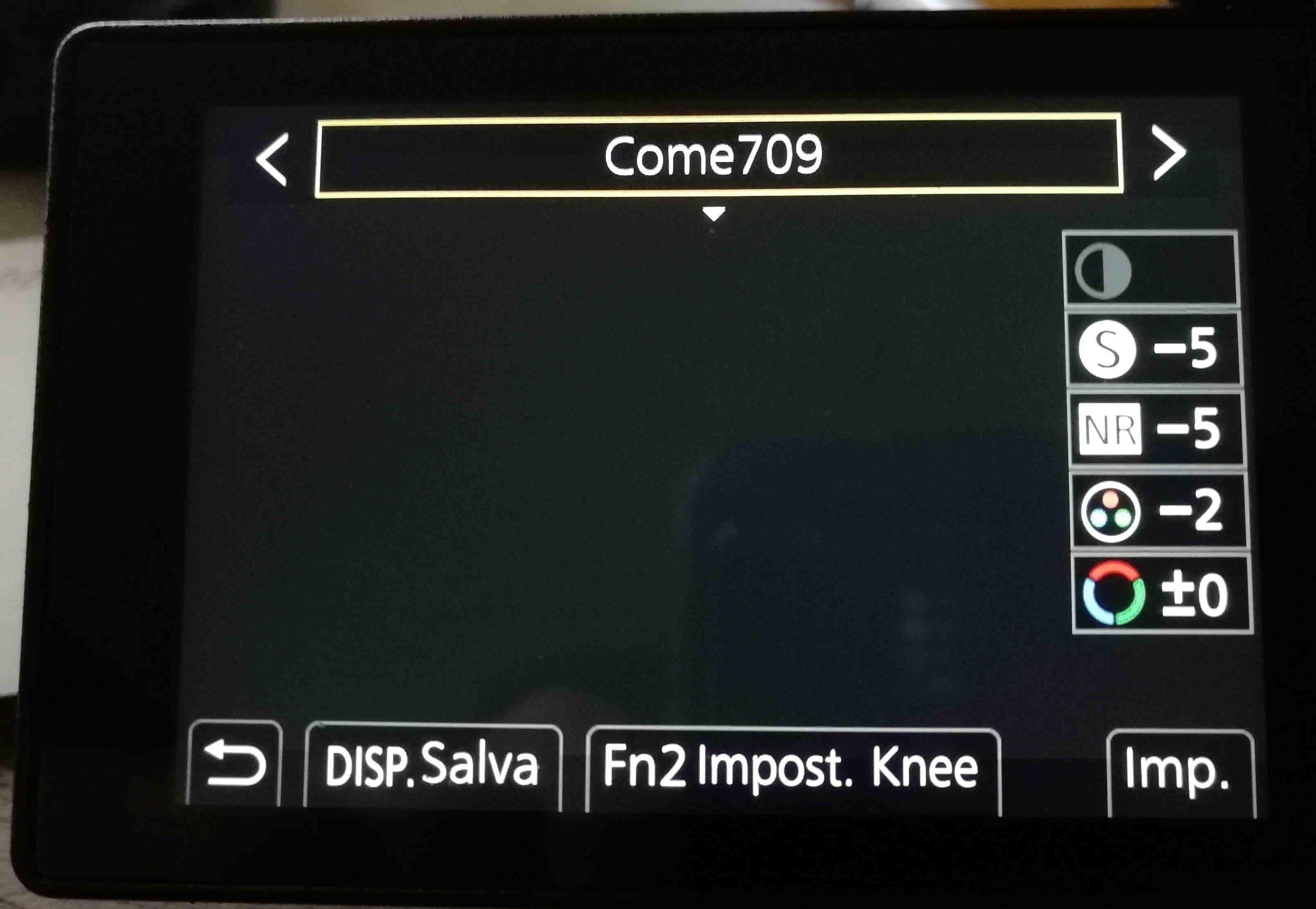

tonysss,
I take a lot of interest too about "like 709" profile after your suggestions and I'd like to do some tests. I hope you can help me again because I don't know if I understood everything about what you wrote me. I speak a little english.
In the meantime I made changed somenìthing in my Menu.
I put: Master Pedestal Level + 10  Luminance level 16-235 and about "Like 709" settings I put Sharpness = -5,  NR = -5,  Saturation = -2. Look at the pic of my attacment please. Then I put POINT-80 SLOPE-99. Do I have to change something else in the Menu? I thank you for your reply.
Do you think "Like 709" is OK even shooting black people in a remote areas and environment with red earth and a lot of light like in Africa?

Yes, your setting is correct, and our English is very similar, similarly bad ?
I shooting all the time in 50p 8bit, and use usually high shutter speed, I no longer use it variable ND filter. If you are shooting in 50p you can, high shutter speed not see so much. But  project in timeline has always in 25p. It is also possible to use it in project slow motion 50%. At GH5, the 25p vs 50p quality is the same.
But try what suits you, 100 people = 200 eyes ?  ,everyone likes something different, test what suits you.

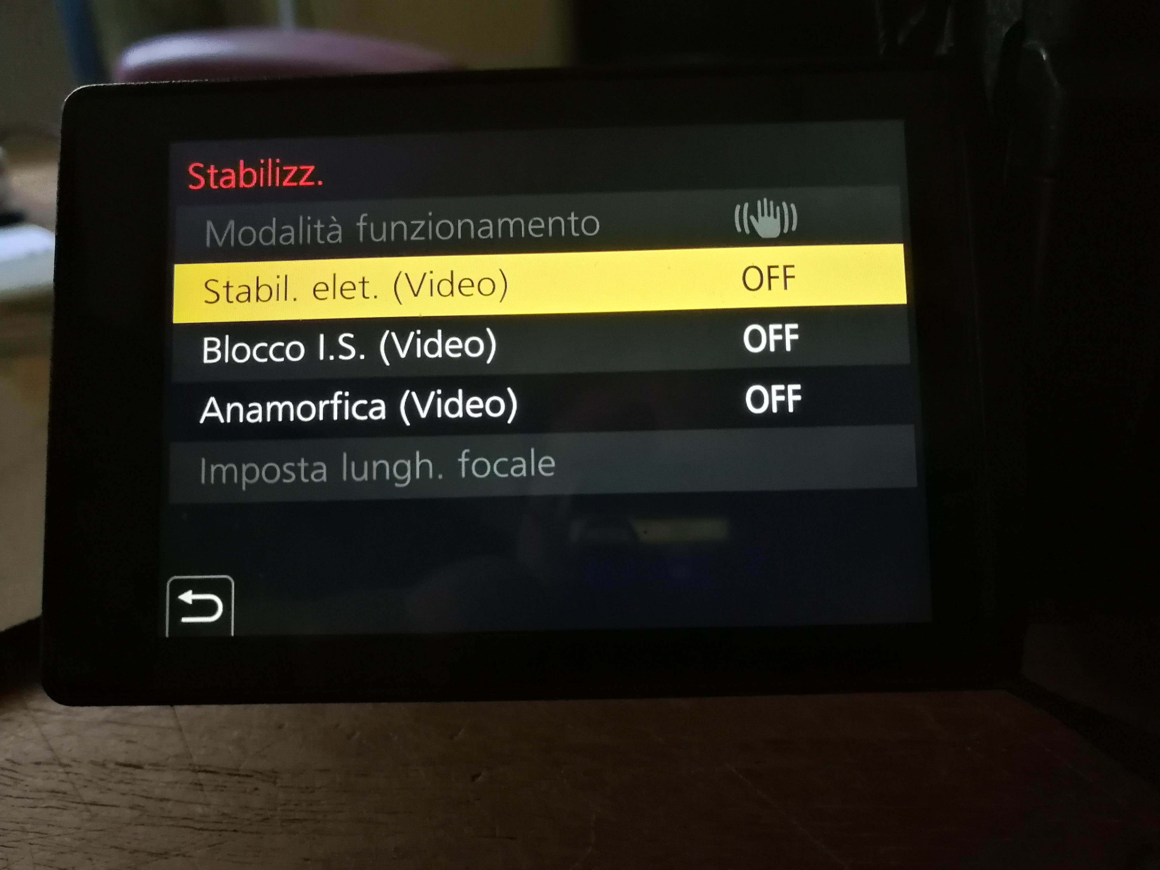

Hello, I noticed a very strange thing: yesterday for the first time I removed the Leica 12-60mm and mounted the lens Lumix G Vario 14-140mm. Well I must say that with the lens Leica 12-60mm I have absolutely no stabilization as good as with the Lumix G Vario 14-140mm. Even with higher zoom the Lumix G Vario is much more stable. These buttons are on "On", therefore they are enabled. Why does this happen to me? Even when I film with the wide angle of Leica, I notice that nothing is fluid. Maybe I configured something wrong in the Menu? However the Manual is very bad. The fact is if I will use the Leica less and less for the benefit of the Lumix G Vario. In the Menu of my GH5 I see the "Operating mode" deactivated. Why? Can you help me to configure that Menu? This is what I see in the Menu:
