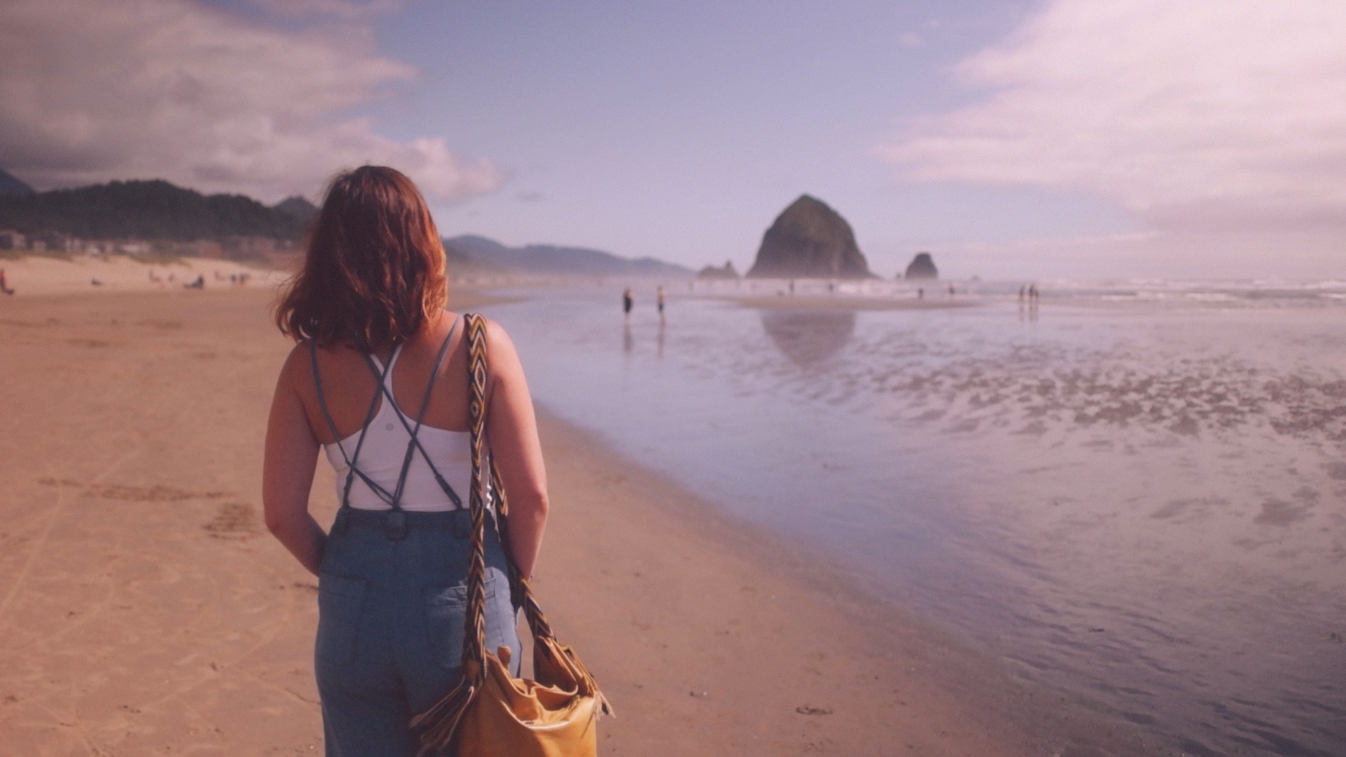

Hene1 Posted July 25, 2016 Share Posted July 25, 2016 It's really red. No need for that "0.95x green" setting anymore. Still too red. iamoui and Marco Tecno 2 Link to comment Share on other sites More sharing options...
iamoui Posted July 25, 2016 Share Posted July 25, 2016 18 minutes ago, Hene1 said: It's really red. No need for that "0.95x green" setting anymore. Still too red. I just observed the same thing. Every clip leaning toward magenta. I also usually run my WB settings toward magenta. No more! Link to comment Share on other sites More sharing options...
iamoui Posted July 25, 2016 Share Posted July 25, 2016 1080p 60fps 180mbps Vasile bitrate hack OOC. Contrast -3, Saturation -4, green: -0.95. WB Daylight with a few clicks toward magenta. Canon FD 24mm F2 wide open, Tiffen Black Pro Mist 1/4, Genus Eclipse Vari ND. Film Convert Applied (Normal, Contrast -4, Saturation -2 Profile). Adjustment to Overall color in FCPX toward green to bring back to neutral. Link to comment Share on other sites More sharing options...

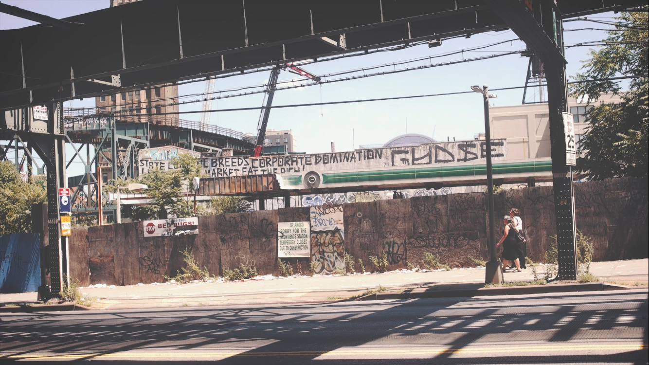

kidzrevil Posted July 28, 2016 Author Share Posted July 28, 2016 On July 25, 2016 at 10:36 AM, NX1user said: The choices are: Normal Gamma C Gamma DR Normal (cont -4, sat -2) Gamma DR (cont -4, sat -2) Let the arguing begin! I have to ask them which picture profile they used for the Normal gamma option. I assume its the Standard picture profile. Either way I would avoid the normal gamma profile and use the gamma c and gamma dr options. Also its time to put the 0.94x green channel thing to rest. I shot this in gamma dr -4 contrast,-2 saturation Link to comment Share on other sites More sharing options...
neosushi Posted July 28, 2016 Share Posted July 28, 2016 2 hours ago, kidzrevil said: I have to ask them which picture profile they used for the Normal gamma option. I assume its the Standard picture profile. Either way I would avoid the normal gamma profile and use the gamma c and gamma dr options. Also its time to put the 0.94x green channel thing to rest. I shot this in gamma dr -4 contrast,-2 saturation Nice I still get this super red image I don't understand why... I seem to have better results using RED MX profiles... Link to comment Share on other sites More sharing options...
iamoui Posted July 28, 2016 Share Posted July 28, 2016 43 minutes ago, neosushi said: Nice I still get this super red image I don't understand why... I seem to have better results using RED MX profiles... Link to comment Share on other sites More sharing options...
kidzrevil Posted July 28, 2016 Author Share Posted July 28, 2016 @neosushi you have to grade out the red. I used DeLuts after filmconvert to get this look Link to comment Share on other sites More sharing options...

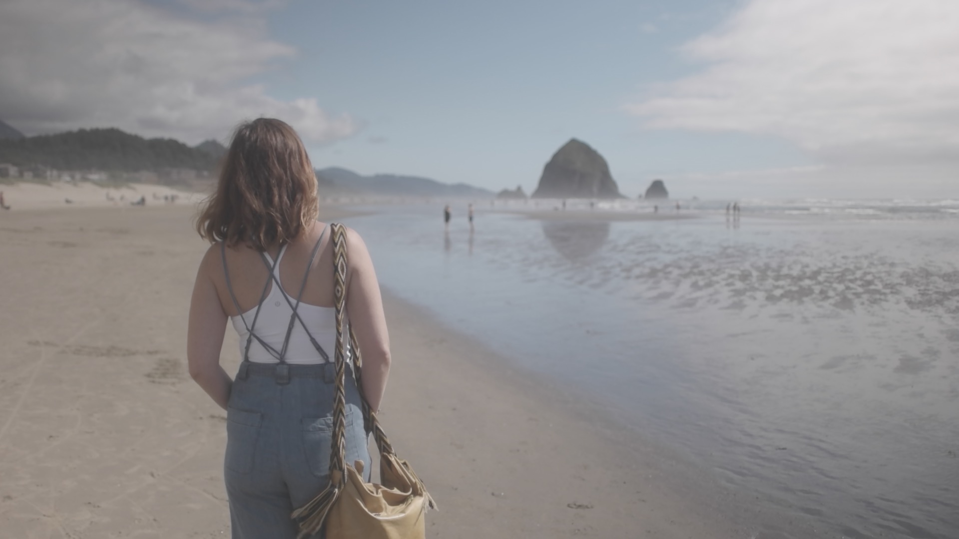

Antonis Posted August 2, 2016 Share Posted August 2, 2016 Here are some more NX1 screenshots from past weekend: //Edit// CLICK on picture to see full quality 4K & 1080p 120fps, Samyang 85mm F1.4 & Samsung 30mm F2 Settings: Portrait, Normal Gamma, Sharpness -10, BMP +15, Green 0.97 Film Convert settings: Default 709 profile, FJ Astia 100 stock, Saturation 132. Lumetri settings: Tint +9 iamoui, Liam and Adept 3 Link to comment Share on other sites More sharing options...
