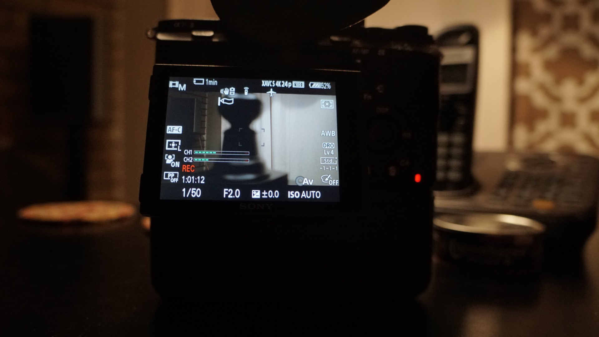

Shield3 Posted April 26, 2016 Share Posted April 26, 2016 As one who shot 5d3 raw back in May 2013 with a camera that cost about as much as the a7r2, I figured what the hell. I can confirm this works perfectly with the a7r Mark II. I threw the grip on to see how long it'd run. I got 1 hour 4 minutes before I ran out of disk (64GB card). Keep in mind this isn't a "firmware" update or anything - it's simply a Playmemories app to install. Simple and easy and takes literally 3 minutes. Link to the "hack" app. https://sony-pmca.appspot.com/apps Thanks to this I can let my a7r2 run for a while now and not worry about it for long shoots. No overheating icon the entire time either. See attached pic of a7r2 w/grip... Nikkor, Franz Schuier and Don Kotlos 3 Link to comment Share on other sites More sharing options...
