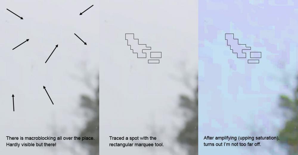

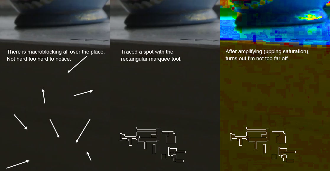

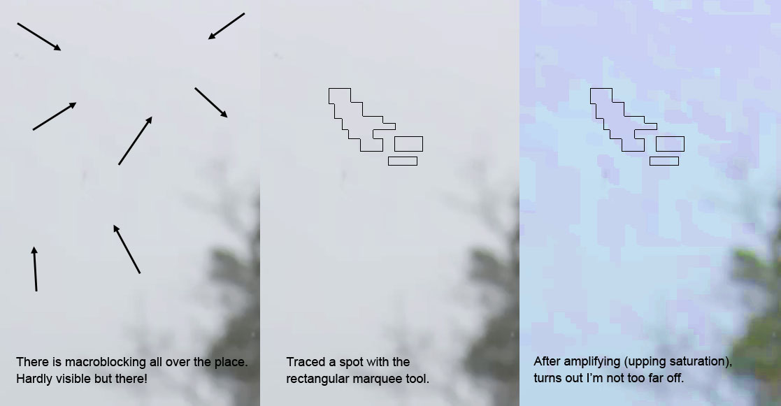

bunk Posted March 26, 2016 Share Posted March 26, 2016 Thanks for sharing the files Mattias. I was surprised by the amount of macro blocking in the window footage as the shot of gunpowder had hardly any. CC-ing gunpowder (no grade) felt really nice, the window shot though felt like the footage fell apart. Don’t think I will buy a JVC any time soon. Link to comment Share on other sites More sharing options...
Super Members Mattias Burling Posted March 26, 2016 Author Super Members Share Posted March 26, 2016 14 minutes ago, bunk said: Thanks for sharing the files Mattias. I was surprised by the amount of macro blocking in the window footage as the shot of gunpowder had hardly any. CC-ing gunpowder (no grade) felt really nice, the window shot though felt like the footage fell apart. Don’t think I will buy a JVC any time soon. How did you grade,because I wasn't able to replicate your problem with macro blocking, no matter how much I pushed? And if you get it, remember, this is 8-bit 4K just like a GH4, A7sii or something, they can't be treated as raw. And the camera does shoot 10-bit 4:2:2 if one really wants to grade. I won't make the decision if its worth to buy by looking at two clips, that seems pretty harsh. Specially since that means you pretty much only have the fs7, c300 and c300ii left to choose from. BrorSvensson 1 Link to comment Share on other sites More sharing options...
bunk Posted March 26, 2016 Share Posted March 26, 2016 35 minutes ago, Mattias Burling said: How did you grade,because I wasn't able to replicate your problem with macro blocking, no matter how much I pushed? No need to grade, just look at the window frame and even sky , although less visible. Link to comment Share on other sites More sharing options...
Super Members Mattias Burling Posted March 26, 2016 Author Super Members Share Posted March 26, 2016 12 minutes ago, bunk said: No need to grade, just look at the window frame and even sky , although less visible. Sorry, dont see it. Can you be more specific? Link to comment Share on other sites More sharing options...
bunk Posted March 26, 2016 Share Posted March 26, 2016 2 hours ago, Mattias Burling said: Sorry, dont see it. Can you be more specific? I opened the footage in Photoshop. And created two cut outs. Without changing the footage I traced some of the macroblocks at 100% and created outlines. Next I changed saturation ... not precise but not too far off either. I'm on my laptop, maybe that somehow emphases it somehow. Link to comment Share on other sites More sharing options...
