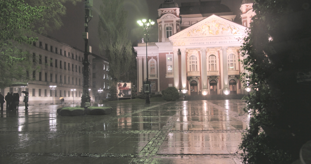

TheRenaissanceMan Posted April 8, 2016 Author Share Posted April 8, 2016 Found this on Facebook's NX1 user group. The difference is pretty amazing imo. Pavel Mašek, iamoui, Geoff CB and 1 other 4 Link to comment Share on other sites More sharing options...
Marco Tecno Posted April 8, 2016 Share Posted April 8, 2016 Fine details are much better with 160mb. I guess that's a sweet spot for 8bit 420. Would be really great to see 10bit and 422, but I doubt it's feasible. TheRenaissanceMan, iamoui, Pavel Mašek and 2 others 5 Link to comment Share on other sites More sharing options...

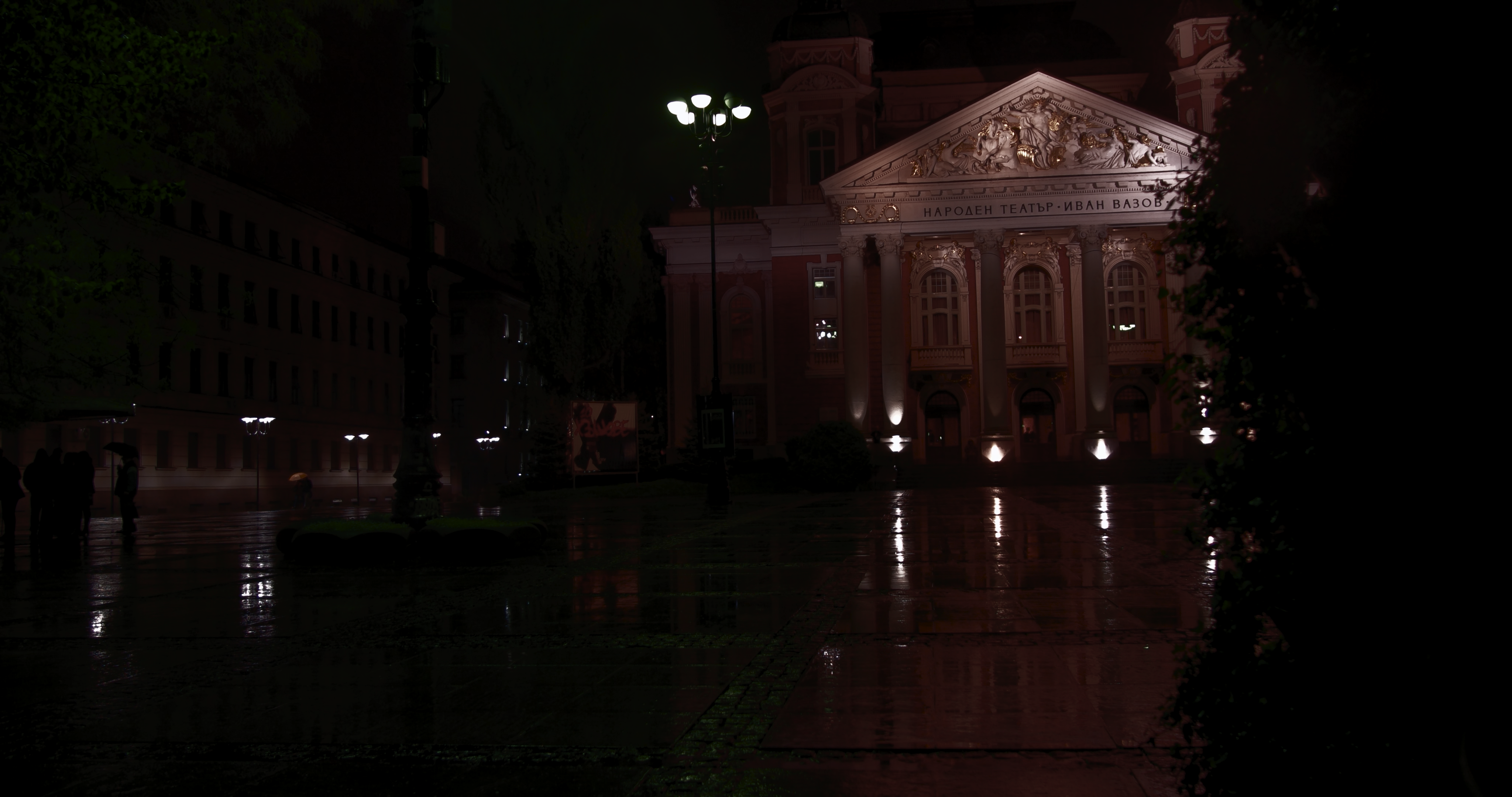

TheRenaissanceMan Posted April 8, 2016 Author Share Posted April 8, 2016 These are re-posted from the hack petition topic. Motion cadence looks hugely improved! Link to comment Share on other sites More sharing options...

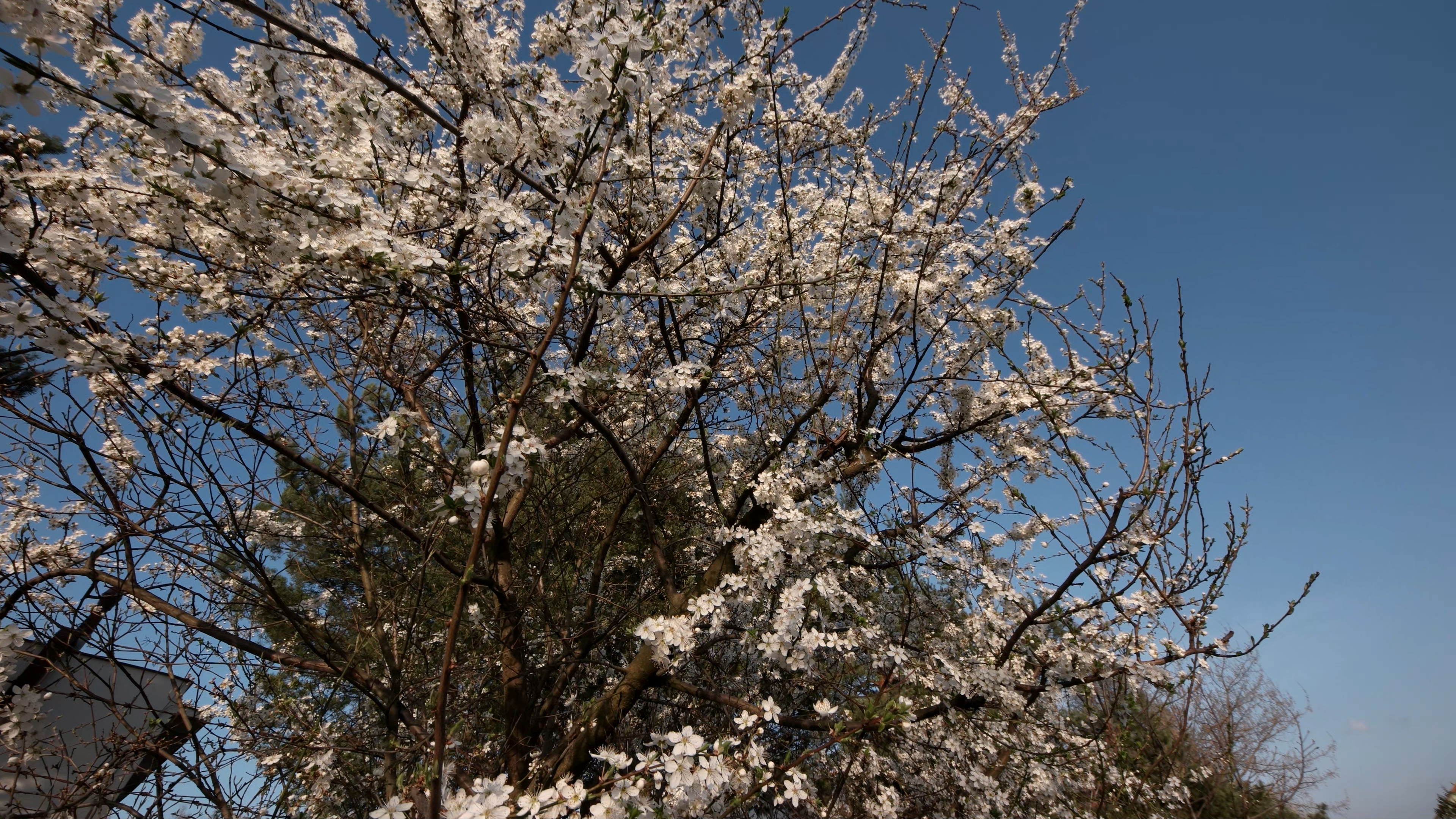

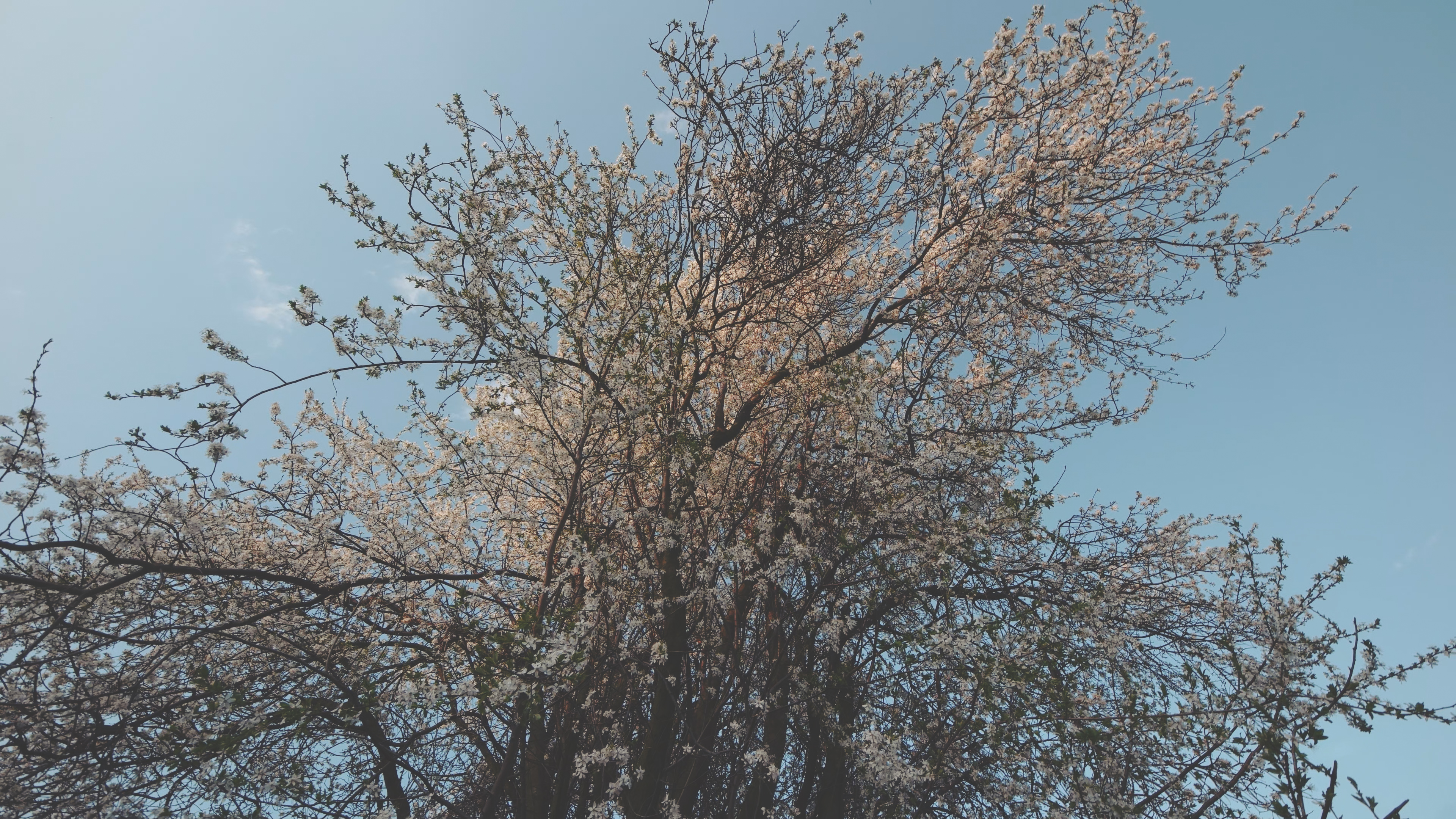

Pavel Mašek Posted April 8, 2016 Share Posted April 8, 2016 2 hours ago, Geoff CB said: Quick test, does not show off fine detail at all, but I do think motion is improved. Forgive my look, I've been very very sick the last couple of days. I think it is just not visible in shallow DOF scenes but definitely in complex scenes where everything is sharp, with some movement and also dark areas (all together). Vimeo clip above proves that even it is just static scene. Below are frames from my 160Mbps video test. Sky would "fall apart" in macroblocking with 80Mbps but it is almost perfect now with incredible details in the branches. Both are shot with some movement (more in ungraded image) - I just walked around the tree with Sigma 8-16mm... Link to comment Share on other sites More sharing options...
Geoff CB Posted April 8, 2016 Share Posted April 8, 2016 26 minutes ago, Pavel Mašek said: I think it is just not visible in shallow DOF scenes but definitely in complex scenes where everything is sharp, with some movement and also dark areas (all together). Vimeo clip above proves that even it is just static scene. Below are frames from my 160Mbps video test. Sky would "fall apart" in macroblocking with 80Mbps but it is almost perfect now with incredible details in the branches. Both are shot with some movement (more in ungraded image) - I just walked around the tree with Sigma 8-16mm... I didn't mean to say that the hack doesn't increase detail, which you show it does. Just that my test, that was mainly done for testing the anamorphic combination wide open, does not show off this aspect of the codec improvements. Pavel Mašek 1 Link to comment Share on other sites More sharing options...

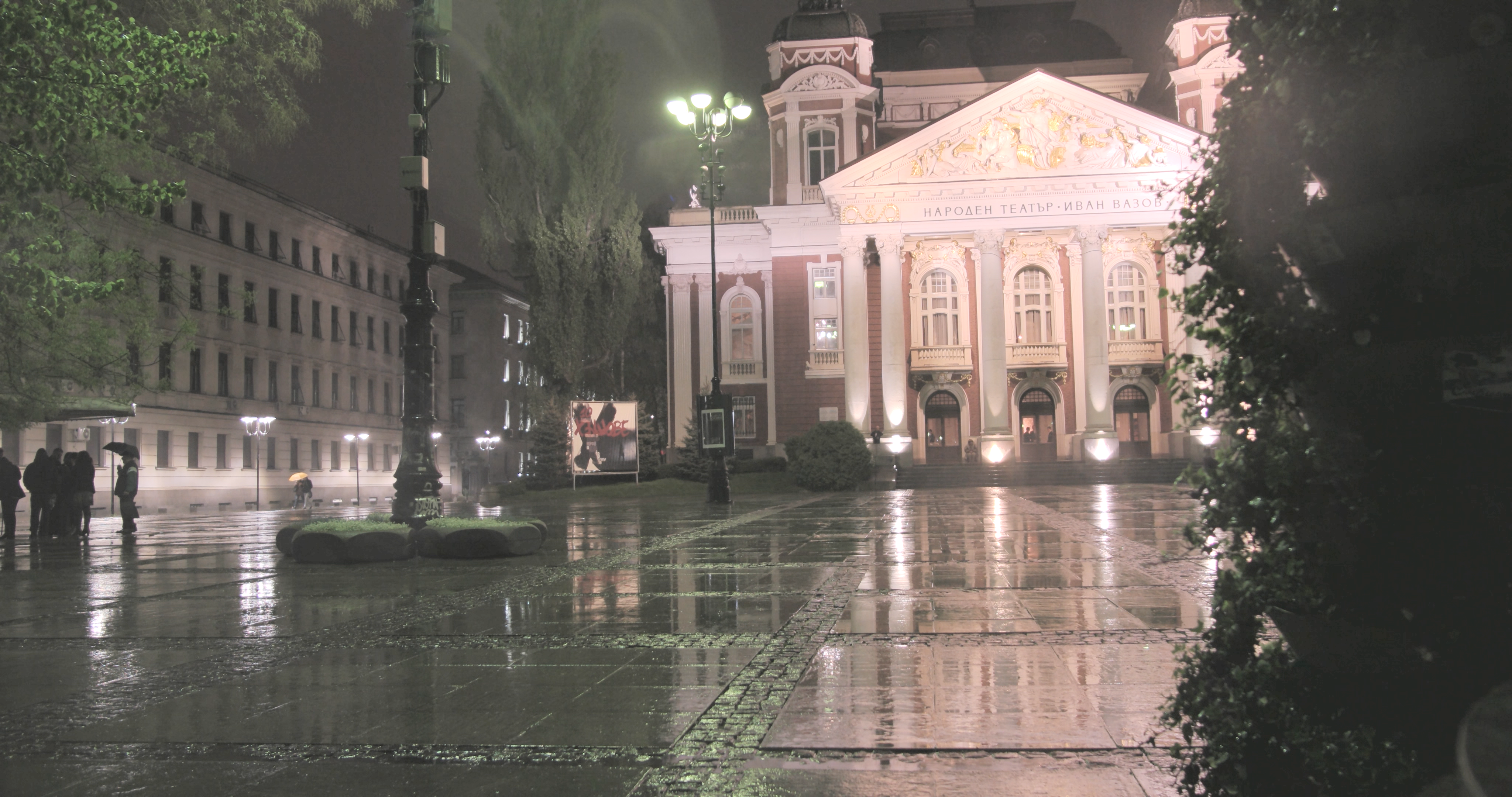

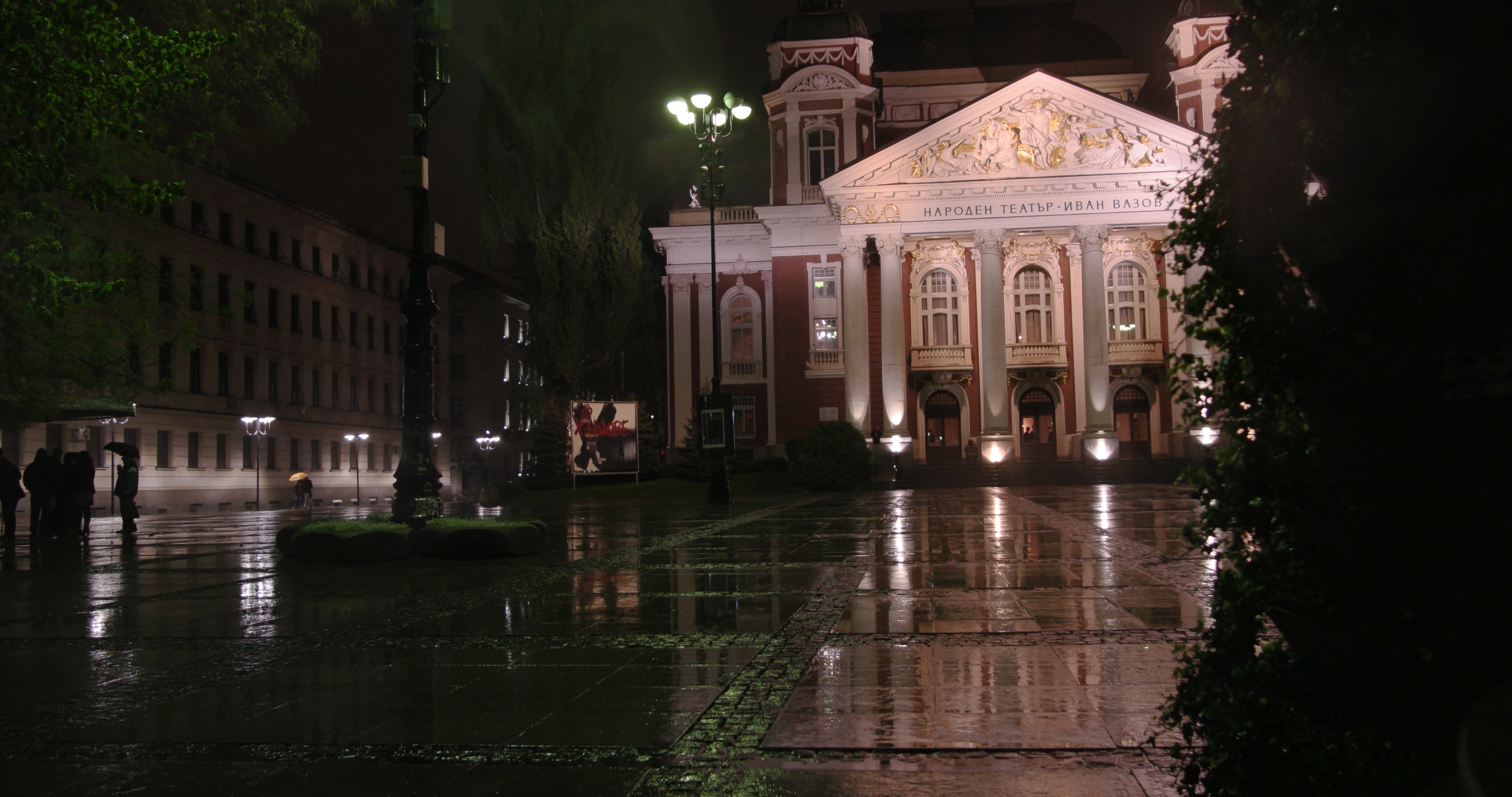

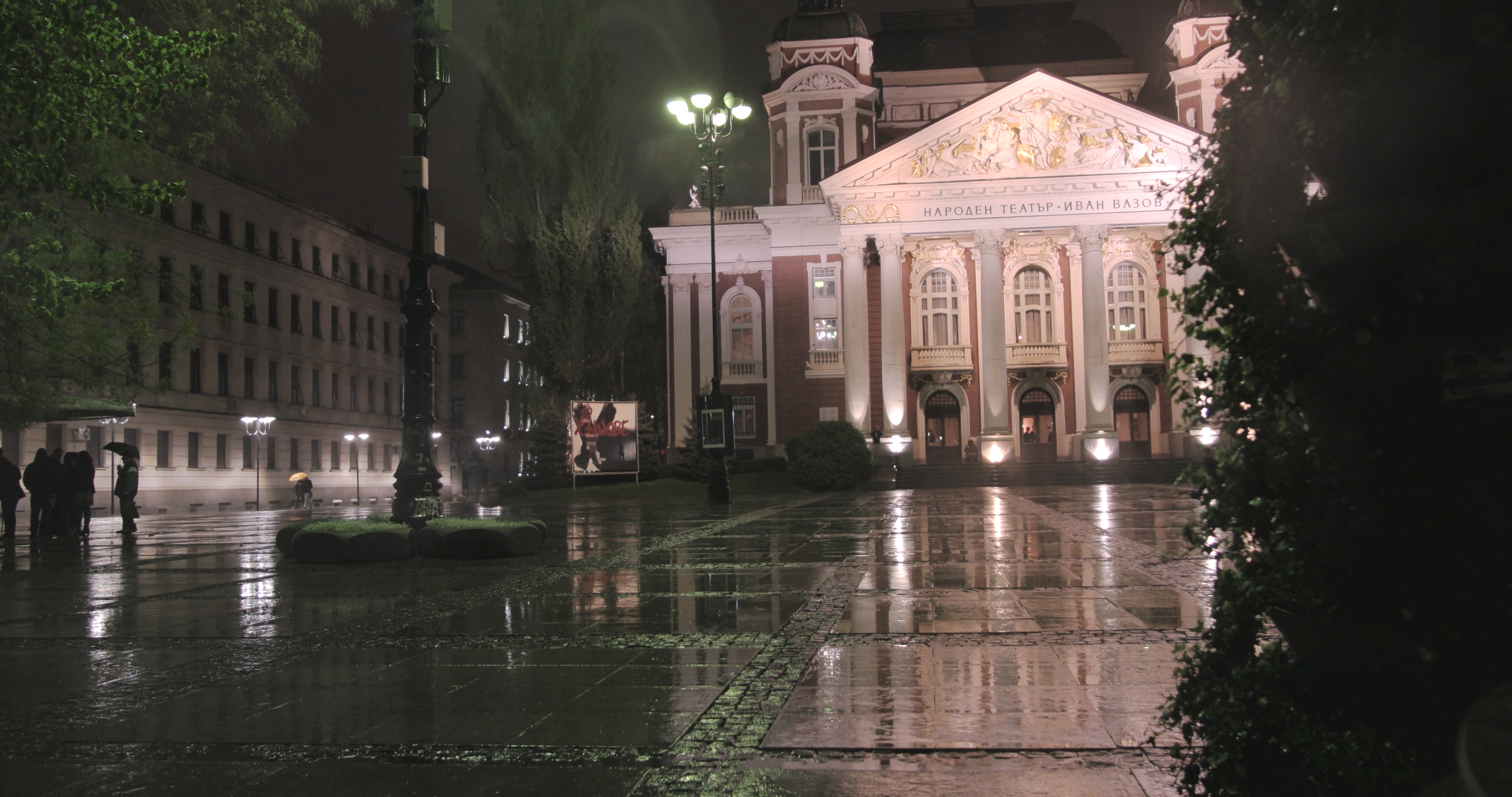

Pavel Mašek Posted April 10, 2016 Share Posted April 10, 2016 Another comparsion: 1. 80Mbps, 2. 160Mbps. Less macroblocking, more details, better gradient (open full size image) While it is just one frame and quite big crop - difference is even more visible in video. Geoff CB 1 Link to comment Share on other sites More sharing options...
Administrators Andrew - EOSHD Posted April 10, 2016 Administrators Share Posted April 10, 2016 On 8 April 2016 at 6:57 PM, Pavel Mašek said: I think it is just not visible in shallow DOF scenes but definitely in complex scenes where everything is sharp, with some movement and also dark areas (all together). Vimeo clip above proves that even it is just static scene. Below are frames from my 160Mbps video test. Sky would "fall apart" in macroblocking with 80Mbps but it is almost perfect now with incredible details in the branches. Both are shot with some movement (more in ungraded image) - I just walked around the tree with Sigma 8-16mm... Is the top one 80Mbit and second one 160? In the top one the sky is still macro blocking quite a lot. Link to comment Share on other sites More sharing options...
Pavel Mašek Posted April 10, 2016 Share Posted April 10, 2016 26 minutes ago, Andrew Reid said: Is the top one 80Mbit and second one 160? In the top one the sky is still macro blocking quite a lot. Both are 160Mbit. Yes, there is still some macroblocking but: 1. I think it is not so bad and not so visible in video as it was done in quite fast movement and it is very codec stressful scene. Second image was from more still so it is completely fine. 2. I will use 180Mbit (no issues with Lexar 2000x) so it could be slightly better. It would be interesting to see how would handle same scene eg. 100Mbit H264 Sony A6300. Link to comment Share on other sites More sharing options...

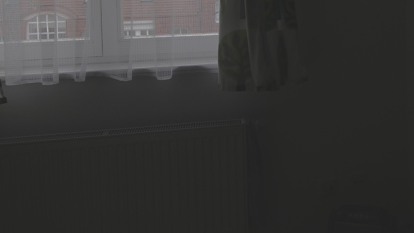

SMGJohn Posted April 10, 2016 Share Posted April 10, 2016 1 hour ago, Marco Tecno said: If the macroblocking is still somewhat present at 160mb/sec, could it be the case where it's not due to compressed bitrate but rather to the way h.265 works? The way HEVC works is definitely contributing to macroblocking and the NR specially which is present even at low 100 ISO. I tested HEVC extensively by converting my huge 400GB Pokémon in original Japanese to 750kbps HEVC. I did probably hundreds of tests and this was back when the X265 was quite young I also tested the H265 in Adobe Media Encoder CC 2015, same issues as always it seems to cause macroblocking in dark areas I also tested a 1080p version with fine grain option of the first episode of Pokémon and HEVC smears the details away, its gotten slightly better with more modern releases but NX1 has old HEVC from 2014 unless they have updated it via firmware which is possible but even then its still out of date from today's versions. Interesting enough I found 8bit saves grain details more than 10bit does which is funny. Not saying recording is same as encoding but HEVC is designed for compression and not for details. When you go higher in bitrate the point of saving space becomes completely lost as H264 10bit seem to perform as good if not better, and this is witnessed in cameras like Nikon which has under 100mbps H264 yet produces beautiful images with very high dynamic range and good shadow details. Pavel MaÅ¡ek 1 Link to comment Share on other sites More sharing options...
kinoseed Posted April 11, 2016 Share Posted April 11, 2016 11 hours ago, SMGJohn said: The way HEVC works is definitely contributing to macroblocking and the NR specially which is present even at low 100 ISO. I tested HEVC extensively by converting my huge 400GB Pokémon in original Japanese to 750kbps HEVC. I did probably hundreds of tests and this was back when the X265 was quite young I also tested the H265 in Adobe Media Encoder CC 2015, same issues as always it seems to cause macroblocking in dark areas I also tested a 1080p version with fine grain option of the first episode of Pokémon and HEVC smears the details away, its gotten slightly better with more modern releases but NX1 has old HEVC from 2014 unless they have updated it via firmware which is possible but even then its still out of date from today's versions. Interesting enough I found 8bit saves grain details more than 10bit does which is funny. Not saying recording is same as encoding but HEVC is designed for compression and not for details. When you go higher in bitrate the point of saving space becomes completely lost as H264 10bit seem to perform as good if not better, and this is witnessed in cameras like Nikon which has under 100mbps H264 yet produces beautiful images with very high dynamic range and good shadow details. I can't agree. Here is a 4K frame from 160Mbps mod, nx500, pushed around to check the latitude for grading. (it was done in the rain, can't tell you the ISO, it's a bit soft as it was shot wide-open, and there are raindrops on the lens ... but it worked for me ) I did put the video on youtube, and it showed banding, macro-blocks and so forth, only after it was converted to h264, here are some frames direct from HVEC (the original is slightly underexposed): Link to comment Share on other sites More sharing options...
