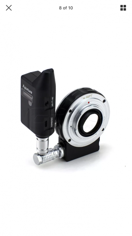

grey Posted October 21, 2016 Share Posted October 21, 2016 This is from Aputure...but is for micro 4/3...but...if we change the rear flange, of course the distance between the lens and the sensor must be adjusted, but we will control the aperture and the focus...probably or it's complete a stupid thing?(and it's a focal reducer too) Link to comment Share on other sites More sharing options...
Marco Tecno Posted October 21, 2016 Share Posted October 21, 2016 33 minutes ago, grey said: This is from Aputure...but is for micro 4/3...but...if we change the rear flange, of course the distance between the lens and the sensor must be adjusted, but we will control the aperture and the focus...probably or it's complete a stupid thing?(and it's a focal reducer too) For me such a tool would be of no interest. I'd like real af for stills shooting with tele lenses. Link to comment Share on other sites More sharing options...
