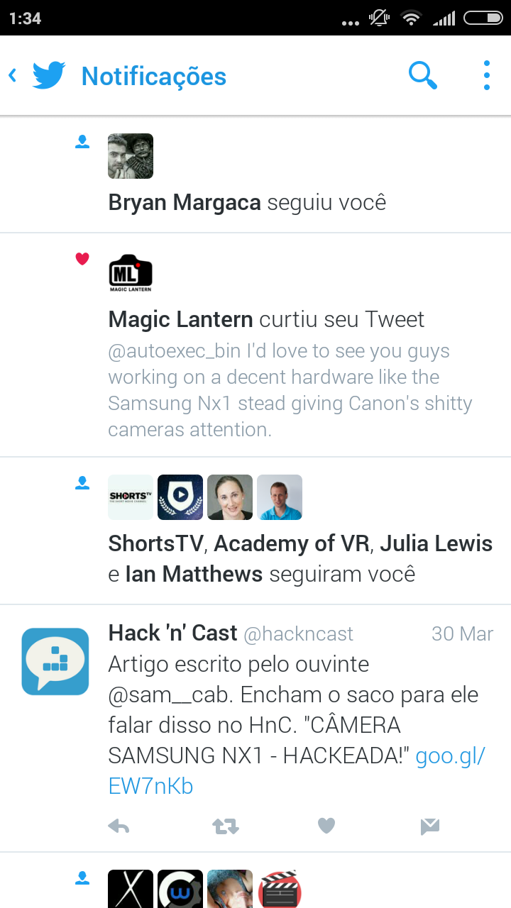

samuel.cabral Posted April 10, 2016 Share Posted April 10, 2016 It would be awesome to have something like a Magic lantern on this camera. And they might like the idea... Link to comment Share on other sites More sharing options...
Marco Tecno Posted April 10, 2016 Share Posted April 10, 2016 otto is working on a gui for the scripts he, vasile and hirsti produced. This is not very far from a magic lantern sw. as to the nr, there is the option to enable or disable it, but I never understood if it affect also video or only jpg stills. It should be investigated and seen if it stores the variable of 'nr on' somewhere, like it happens for bitrate. vaga and kidzrevil 2 Link to comment Share on other sites More sharing options...
