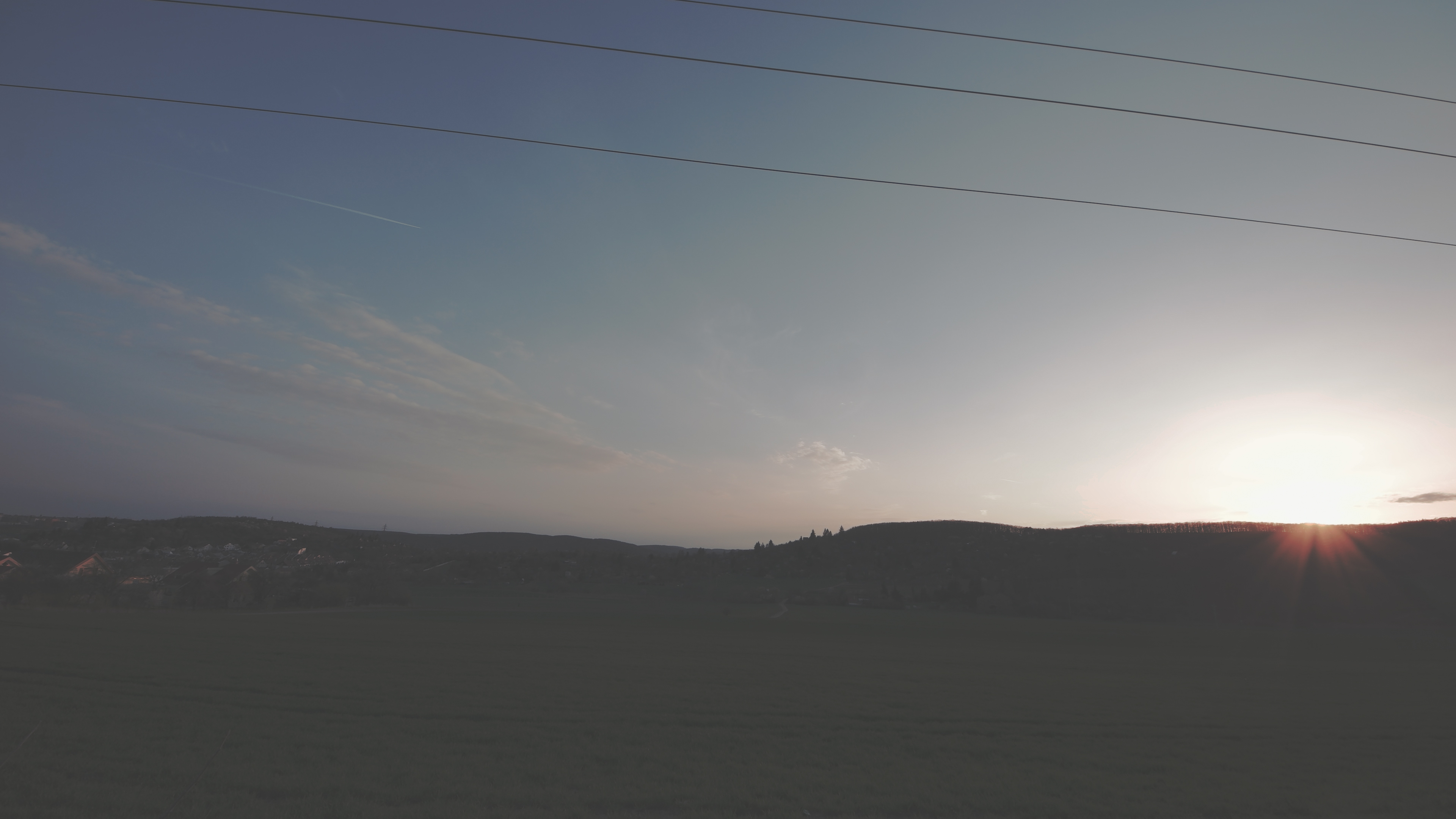

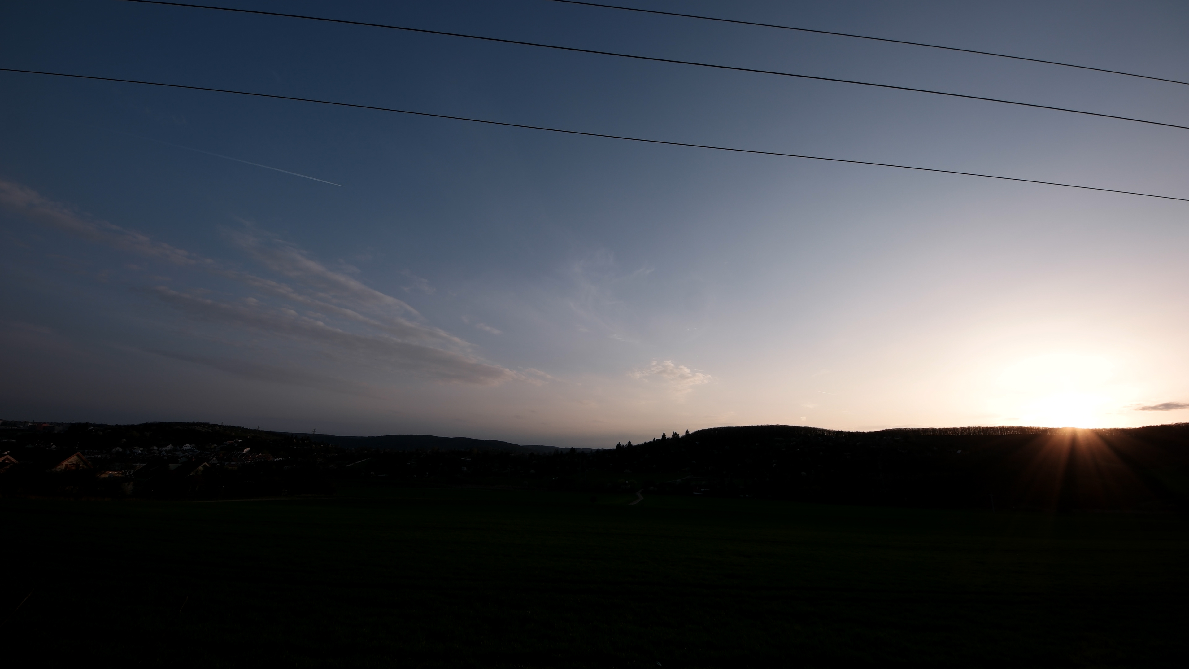

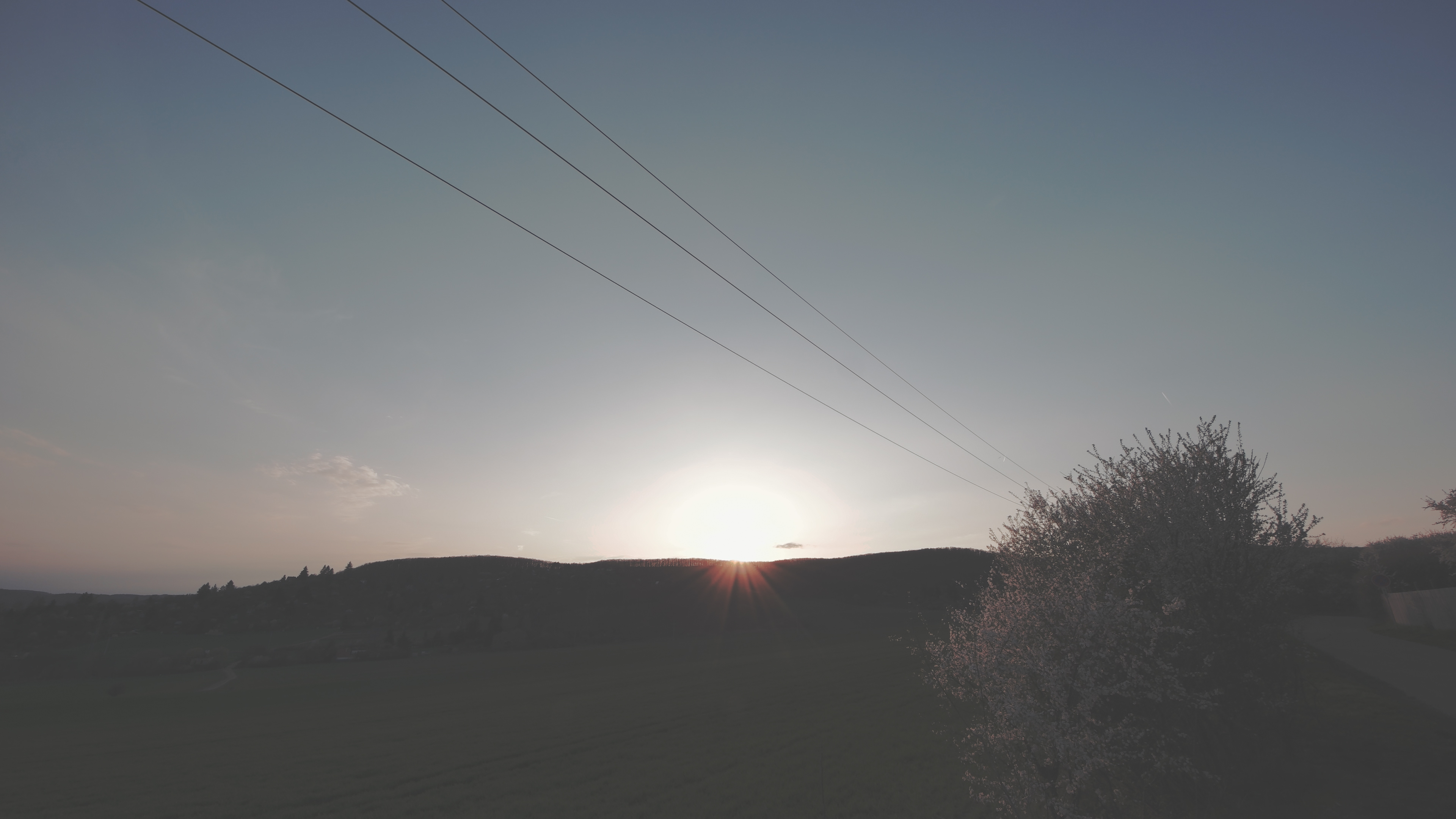

Pavel Mašek Posted April 6, 2016 Share Posted April 6, 2016 I still see some macroblocking in shadows in 120fps but I think it renders details better. Buf for now I will stick to 60 fps when using hack. I think best benefit is in prevention of macroblocking - image is stable and I think also gradient is better. But I did not make any comparsion. Below is screenshot from graded (and one ungraded) 160Mbits, 4k30fps, Standard, 0-255 videoclip kidzrevil 1 Link to comment Share on other sites More sharing options...

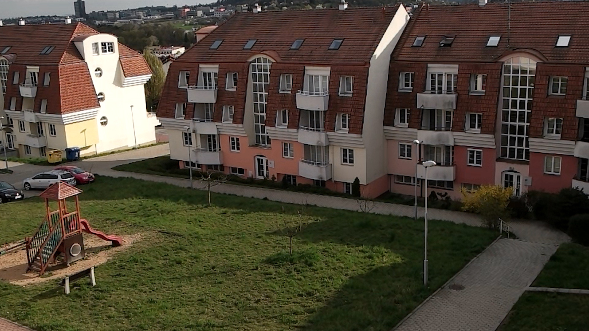

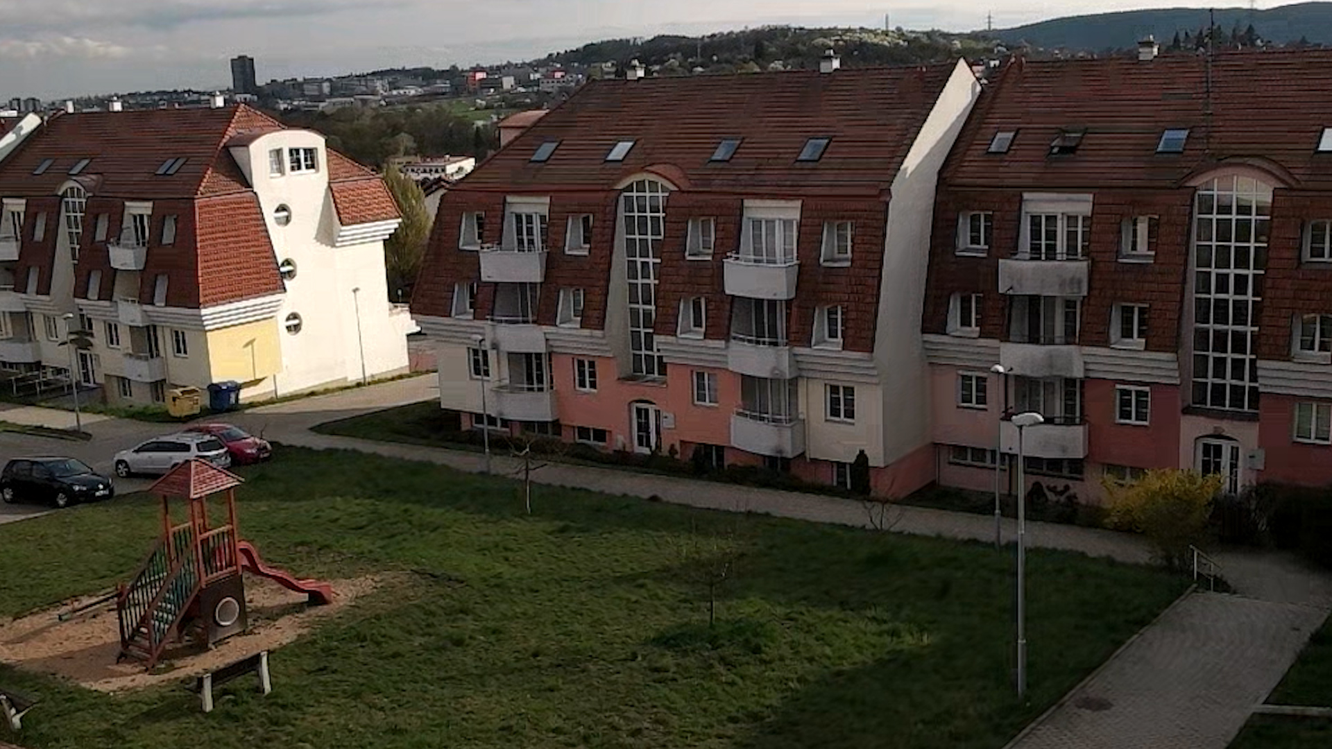

Pavel Mašek Posted April 6, 2016 Share Posted April 6, 2016 29 minutes ago, sandro said: Well 120p is where we should see the best improvements since the bitrate really suffers there. It's not the NR. Here is comparison of hacked and non hacked 120 fps (200% zoom). There is quite big difference in terms of compression and details. Problem is that hacked is just 106 fps according Premiere... First is hacked and second normal: caseywilsondp, saintsimon2016, Marco Tecno and 1 other 4 Link to comment Share on other sites More sharing options...
caseywilsondp Posted April 6, 2016 Share Posted April 6, 2016 Seems like the biggest benefactor of this hack is 1080p, which is great because 120 quality was not awesome before. Link to comment Share on other sites More sharing options...
