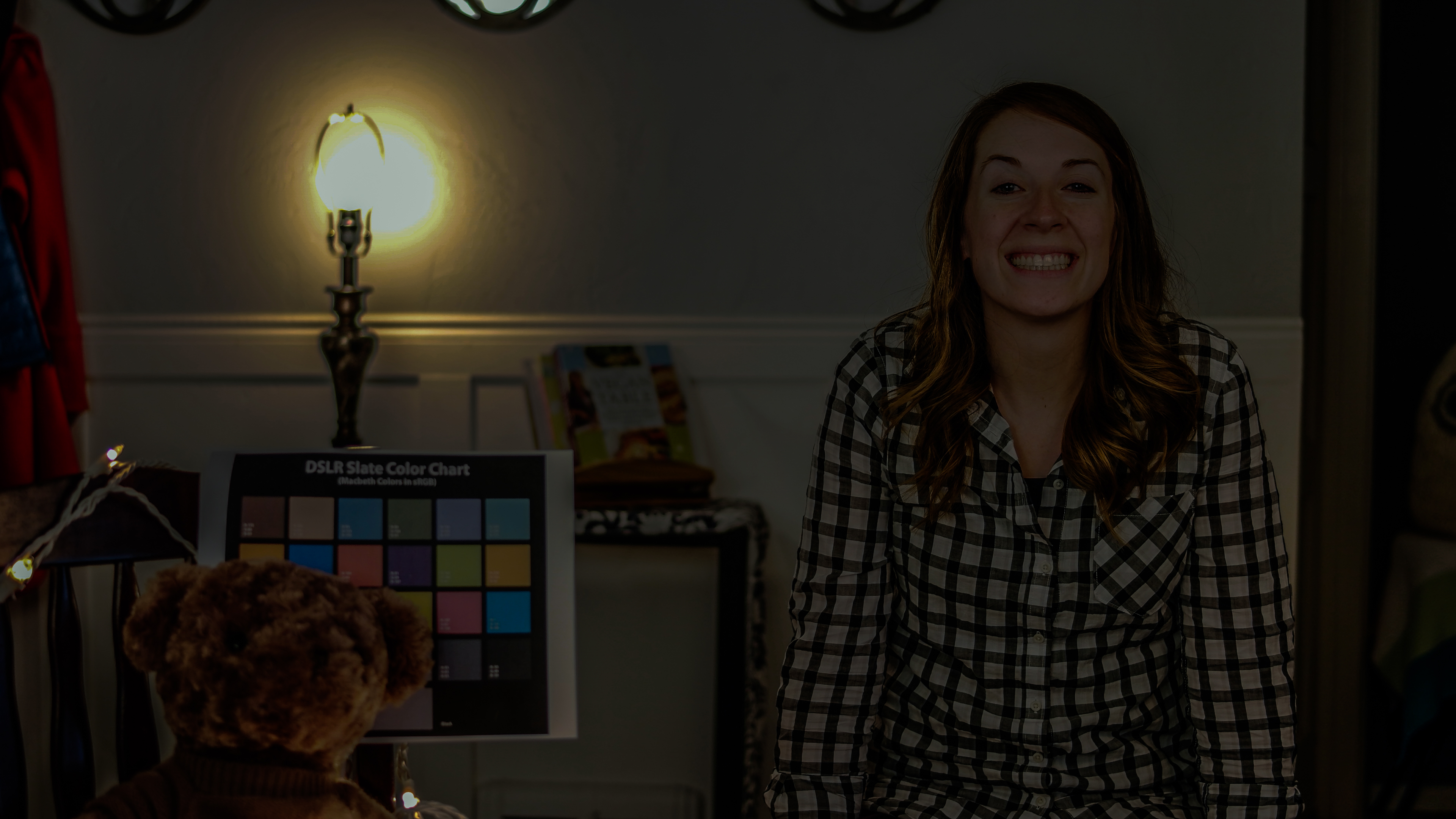

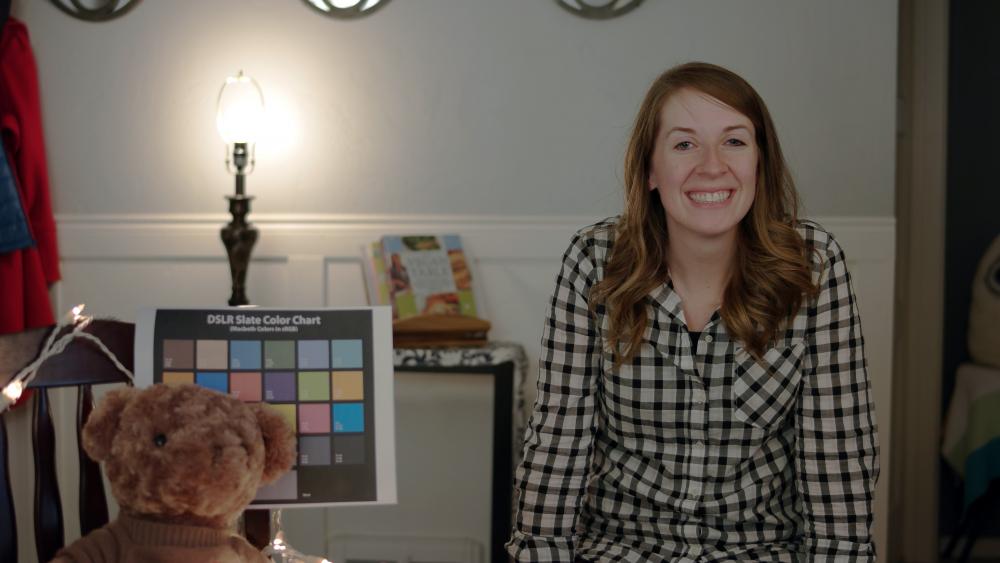

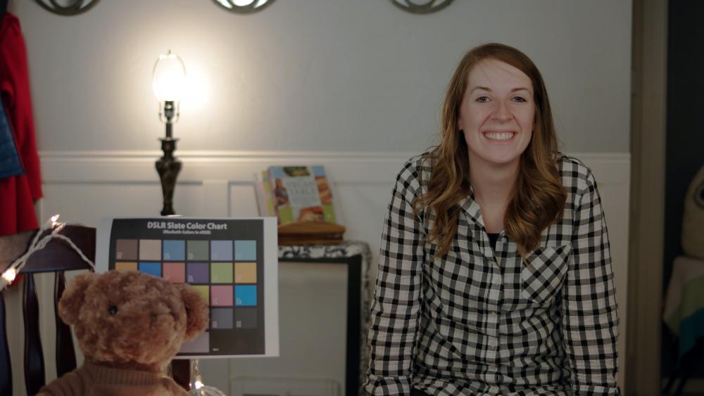

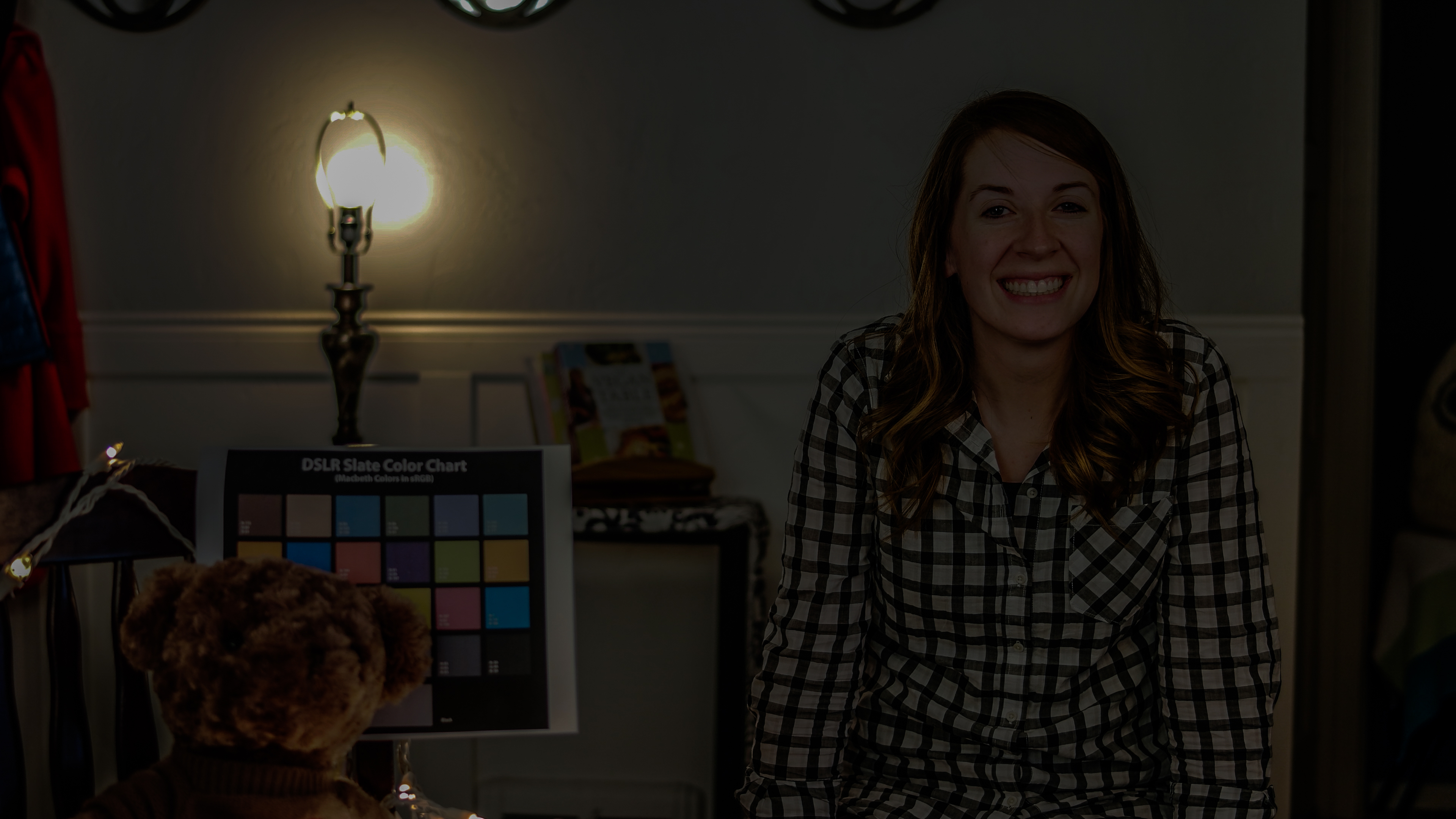

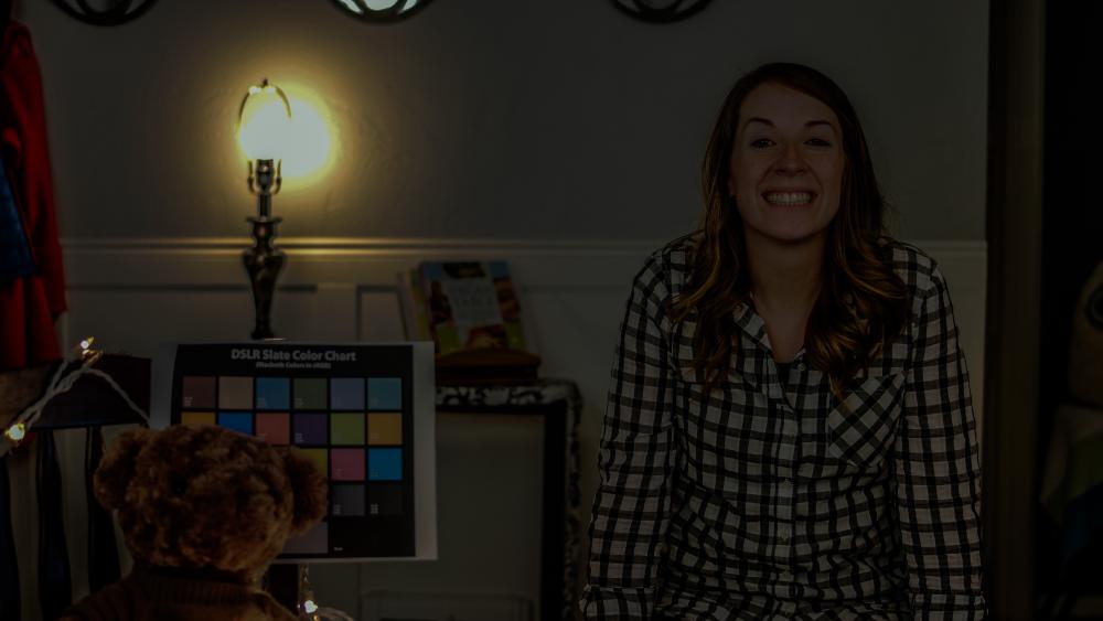

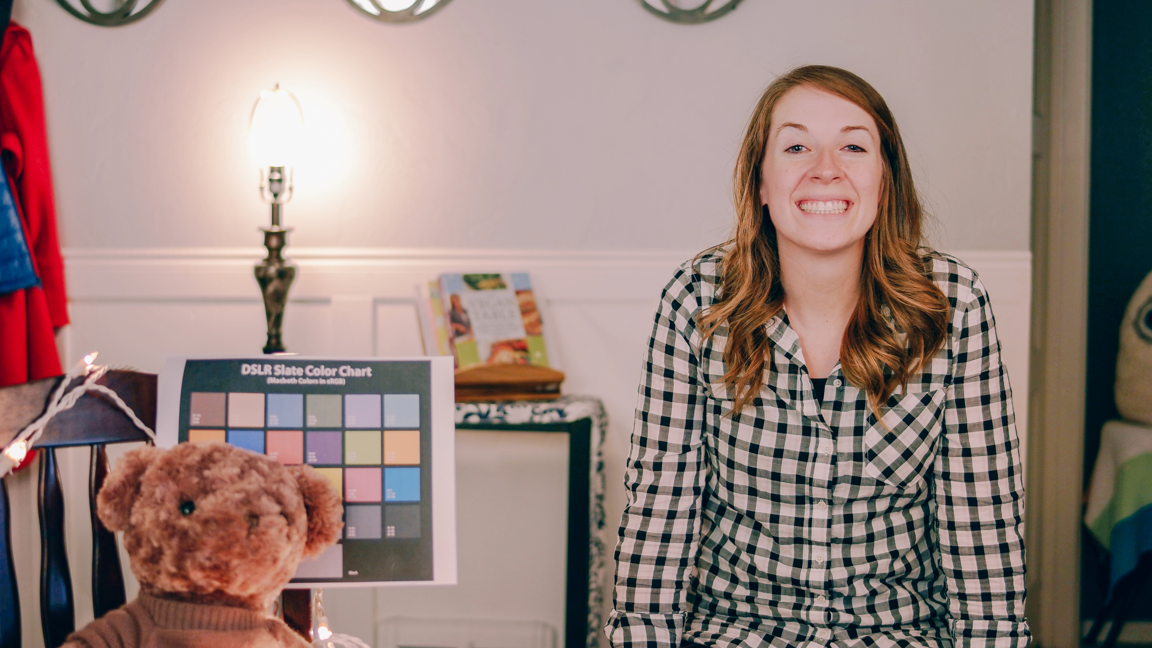

caseywilsondp Posted April 7, 2016 Share Posted April 7, 2016 ok just a quick preview of the test i shot earlier. here are unedited 14 bit jpegs from the timeline. one is at bit rate 80mbps, 180mpbs, and one is 660+ mbps (shogun). can you tell from the stills (shogun might be obvious)? i'll upload the actual video files a little later. if anyone wanted to take a stab at grading these, i'd love to see it. wanted to test banding, shadow detail/macroblocking, skin tones, but had to run the test really quickly so I chose these settings: normal gamma, -10 contrast (to induce banding), -10 sharpness, 16-235 the color chart is just for reference, btw. Pavel Mašek 1 Link to comment Share on other sites More sharing options...

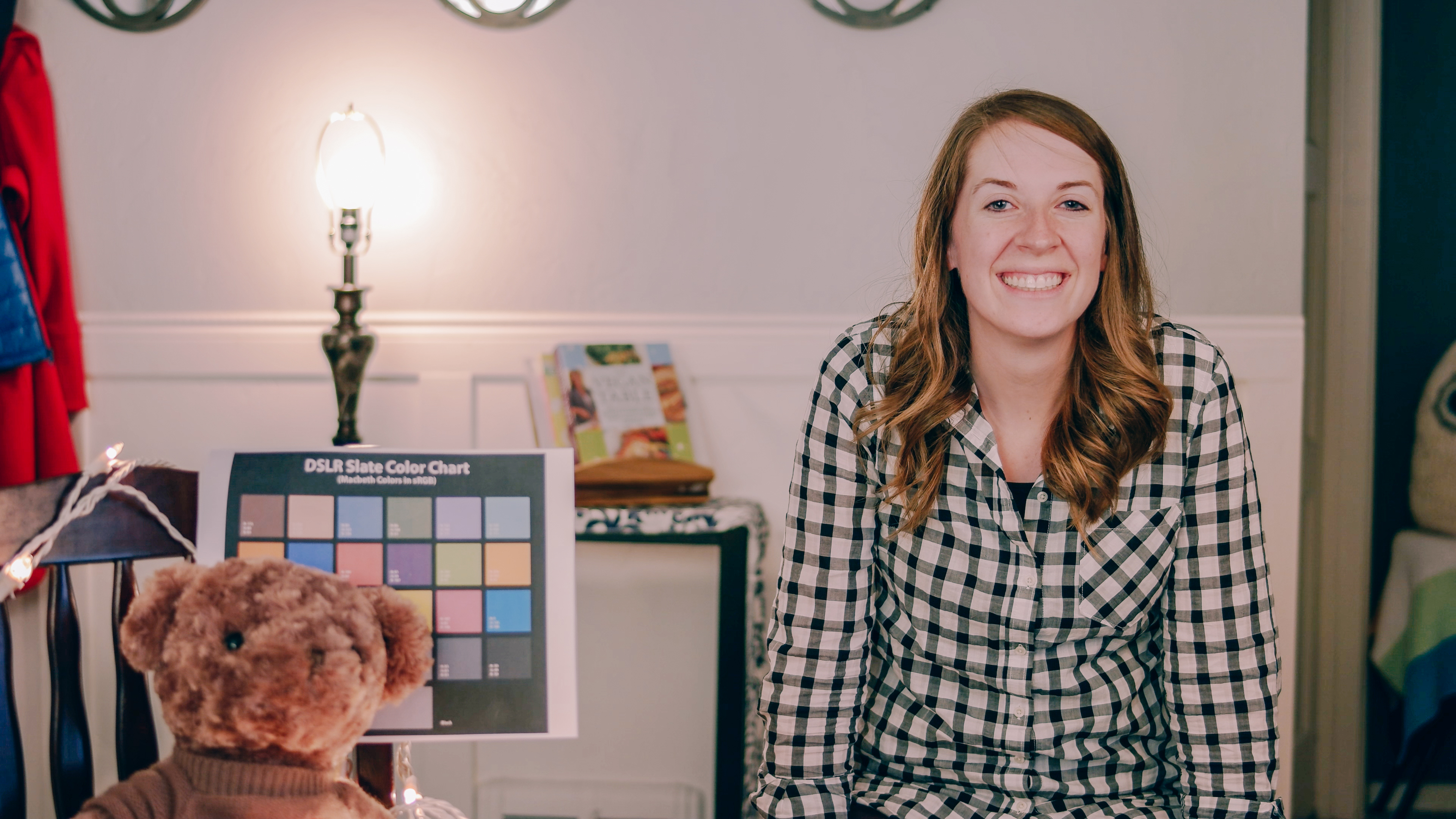

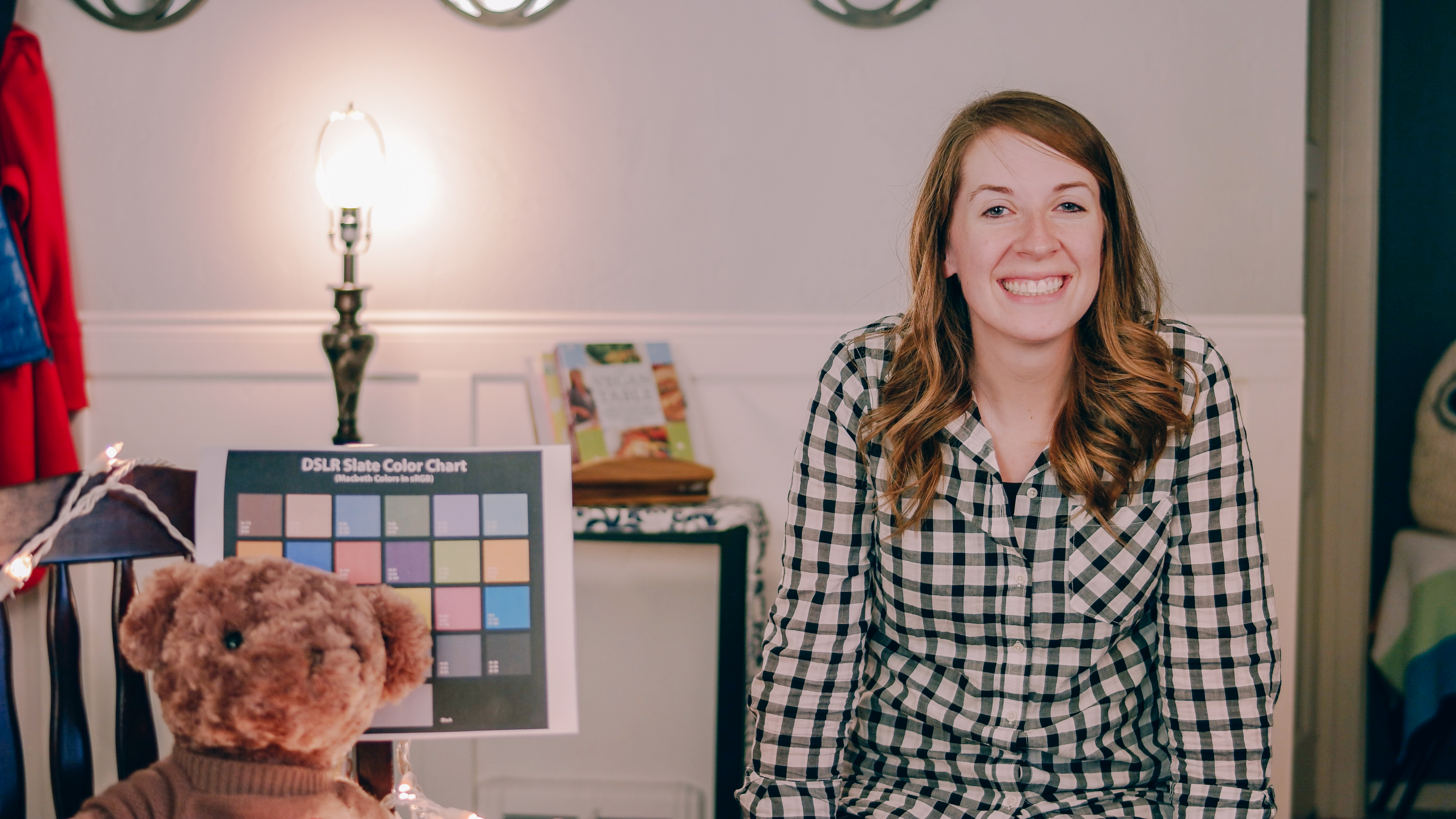

Last Leaves Posted April 8, 2016 Share Posted April 8, 2016 My guess: A= 180Mb/s B= 80Mb/s and C(actually named "D")= Shogun My fast pass CC (could not get anything that I was happy with)- same order as yours: Stress test to show light bulb roll-off/banding (same order as yours): Link to comment Share on other sites More sharing options...
