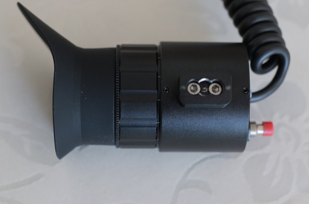

stephen Posted April 30, 2025 Share Posted April 30, 2025 Recently saw a second hand Sony ZV-E1 on a local online market place. Price was good and I bought it. Great video camera but lacks EVF. Same is true for it's pro oriented brother FX3. Typically those type of cameras are used with external monitor on professional shoots or with camera LCD display only when vlogging. If you like EVFs and want to add one, choice is not great. No external add-on EVF from Sony like the one Sigma FP has. Portkeys LEYE III modified with better loupe is the cheapest one at 450-500 E/$ but I wouldn't call it small. Then Kinefinity EVF for 1250 E/$. Great one but definitely not affordable. There is an obvious gap and need for a relatively small, high quality, affordable external EVFs for cinema / hybrid cameras. I was looking for quite some time on AliExpress for Mini OLED displays (0.39'' to 0.7'') as a building blocks for DIY External EVF. Usually they come with controller board with HDMI input too. Almost bought some components preparing to do some 3D design and printing around them. Surprisingly found an EVF ready to be used. This type of EVFs were designed to be used with industrial instruments and were on AliExpress for quite some time. They all had lower resolution and AV video inputs in the past. For the first time saw one with 1920x1080 resolution on a 0.7'' mini OLED display and HDMI input. Also for the first time this type of EVFs is targeted toward cameras. Price was good too at 230E/$ so I decided to give it a try. Received the EVF few days ago and am happy to report that it is better than expected. Here is the list of things that I like and few that I don't like: What I Like: High resolution 1920x1080 ( equivalent to 6 220 800 dot camera EVF). Cameras EVFs have 4:3 ratio to cover 3:2 frame + some black strips on top and bottom to display information like exposure and other camera settings. The sensor on this one has 16:9 aspect ratio. To get 3:2 ratio the EVF crops the image to 1620x1080. Still great resolution at the level of ~5 mln dots EVFs like the one in Panasonic S1 series. I see in the EVF exactly what I see on the LCD screen of Sony ZV-E1 minus peaking. This is a rather good thing. Solid, all metal outer shell, good, even great quality of craftsmanship. Eye cup is big, made from rubber and fits around the eye much better than traditional camera EVFs. Big and bright screen - has at least 10 levels of brightness that can be changed and controlled manually. Picture inside looks big and bright, quite easy to see. Smooth focusing / diopter correction ring. HDMI cable is integrated, ready to be plugged into a camera. HDMI cable looks to have good quality. No need of additional power or battery. It gets small amount of power (500mA) from HDMI. This is a huge plus for me. Has mounting thread, can easily be mounted on rigs or cages or even on camera hot shoe. Can be tilted and placed in any position you want. Another huge plus. I've simply put it on monitor holder for hot shoe, which is mounted on the camera cage. EVF sits higher and is slightly tilted. It also provides 3rd point of contact and add stability. I am able to hold the camera lower and closer to the chest, which makes it more stable when shooting. Optimal size for me ! Not too small and not too big. Relatively light. Another huge plus. Optics made of glass, look high quality. Great price for what it offers - 200 Euro ($) including shipping and taxes after some Aliexpress discount. Because EVF receives its power from HDMI you don't have to switch it on separately. It has its own ON/OFF switch but if you stop the camera, EVF stops too as it doesn't receive power from HDMI. This is very convenient because it semi integrates with the camera, you don't have to switch it on/off separately. What could be better: While loupe (optics) craftsmanship is high quality, optical schema is probably not the best. Seeing tower end of the frame and in the corners is kind of difficult. In photo mode EVF has to show picture with 3:2 ratio. It crops the display at 1620x1080 to achieve this ratio. Same is true for video. This is great because this way corners of the OLED display are always cropped and dark while picture in the EVF is still high quality and resolution is still great too. So you always look at a picture which is in focus from end to end and you can see the whole of it. Brightness control has many steps but goes only in one direction. Adjusting it when you want to make picture darker or go at the opposite direction is difficult. You have to cycle trough all settings value until arriving before the setting you were a moment ago. Brightness control button is too small and uncomfortable to use. Both are not huge issues because eye cup completely isolates your eye and cuts external light at almost 100%. Once you set the brightness level you rarely need to adjust it. It doesn't have the additional tools a pro external viewfinder usually has - like peaking, False color, zebras, etc. Because it takes power from camera and becomes additional consumer, battery is drained a little faster. Hard to say how much faster. I still prefer this compared to EVF that have their own battery. Picture is not as clear as in a high quality camera viewfinder. Native camera EVF receives video stream that already has noise reduced. Image on HDMI out from the camera is more like RAW video, lots of noise in the shadows at high ISO, some noise even at lower ISO. I guess the same would be with any external EVF, even expensive PRO ones. It's not EVF's fault. I also see sometimes some texture like noise, not sure because of this particular OLED display or because of the HDMI out stream. Overall picture quality is not up to what you see in a camera integrated EVF but it is close. Surprisingly noise in the shadows helps me better judge exposure and use successfully ETTR. I live in a PAL region but camera was set to NTSC to have 24fps. There was a lot of flicker in EVF image even when only natural (sun) light was available. Maybe this can be avoided with some additional camera settings. No such problem when camera is set to PAL and 25fps. Sometimes when adjusting brightness, EVF looses sync and doesn't display any image. Have to switch camera on/off one time and problem is resolved. Not a big deal but it happened once or twice. HDMI cable is integrated. A PRO EVF has just HDMI out socket and you can choose your own HDMI cable. This one can be easily modified IMHO. Size: L=~50mm; Diameter ~43mm; weight 188g with the integrated HDMI cable Overall I like it a lot. There is nothing like it on the market and especially at this price point. I am surprised it took Chinese manufactures so long to figure out that a good market for external EVFs exists. I prefer it over modified Portkey LEYE III because of the smaller size and no need to plug and charge another battery. I may buy another one. 🙂 Now my Sony ZV-E1 has an EVF and a great one too. 🙂 Here is the link: On Aliexpress You can find it on ebay too. Search for V780H EVF Here how it sits on top of Sony ZV-E1 Davide DB, eatstoomuchjam, Noli and 4 others 1 6 Link to comment Share on other sites More sharing options...

eatstoomuchjam Posted April 30, 2025 Share Posted April 30, 2025 For the mounting thread, are there locating pin holes? Link to comment Share on other sites More sharing options...

stephen Posted May 1, 2025 Author Share Posted May 1, 2025 19 hours ago, eatstoomuchjam said: For the mounting thread, are there locating pin holes? Short answer: no. Whole mounting part can be changed but it will require skills and experience to create and make a new one eatstoomuchjam 1 Link to comment Share on other sites More sharing options...
stephen Posted May 1, 2025 Author Share Posted May 1, 2025 Few additional findings and notes: Tested it in bright sunlight conditions. It is great. Fully isolates the eye. Because it perfectly isolates the eye from external light, once brightness is adjusted there is no need to change it. Optics actually are better than thought initially. It has several lenses not just one loupe. Most likely metal housing was designed and used for smaller sensors - 0.5''. Current one is bigger at 0.7'' that's why far end corners aren't perfectly visible. I saw this only when was feeding it with signal from my laptop. When shooting with Sony ZV-E1 as already mentioned it displays a 3:2 crop at 1620x1080px and everything is perfectly visible and in focus. one relatively simple modification would be to cut the current cable and solder a female HDMI and probably glue it to the side of the EVF. This would allow to use better or custom HDMI cables. size is just perfect for cameras like Sony ZV-E1 and all other mirrorless cameras, especially when you don't want to use a rig and have just the camera and a lens, probably also a cage as it is in my case. Nice experience. Makes shooting with an EVF really comfortable. The more I use it, the more I like it 😀 BTM_Pix, matthere, eatstoomuchjam and 1 other 4 Link to comment Share on other sites More sharing options...

Noli Posted May 30, 2025 Share Posted May 30, 2025 I ordered the EVF thanks to this great thread. Shipping took around 3 weeks to Germany and I had to pay 20€ extra. 215€ total. Thats not even half the price of the Sigma FP EVF. Unfortunately it does not work 100% with the Sigma FP. The camera screen flickers when I plug the EVF in and once in a while a frame appears on the EVF. After switching the settings of the HDMI Output in the menu a couple of times it eventually always works. Sometimes it takes 1 minute, sometimes 10 seconds, but after I switch off the camera it's always the same issue again. At first I thought it wouldn't work at all and that the HDMI power of the FP was not strong enough but once the EVF works it does so without a problem until I power off the camera. For focus the image is nice and mirroring the camera display works great, with peaking, false colour, magnification, etc. The blacks are crushed (and have a green tint), so for exposure it is not as useful. If it wouldn't be for that annoying connectivity issue this thing would be perfect. Paired with the 28-200 this finally makes my stripped down "Bolex FP" complete. Being able to adjust the EVF freely and keep the camera close to my chest is really comfortable and the Lens Stabilisation makes the FP viable for handheld while still being compact and light. Think I'll be using this for slow paced personal projects or when I am filming constantly and dont turn off the camera a lot. The form factor and not having to think about extra batteries is great. For photography in sunlight I'll still have to use my diy loupe for the backscreen because waiting up to a minute for the EVF to finally work is just to cumbersome. @Clark Nikolai Do you know if the buttons on the back have any functionality apart from the one that changes brightness? Juank, eatstoomuchjam and Davide DB 3 Link to comment Share on other sites More sharing options...

Noli Posted May 31, 2025 Share Posted May 31, 2025 I am using a loupe on the FP. It works well and is very light. I also thought about modifying one of those foldable coffee cups to have one thats not as bulky. 😄 I tried the EVF on the FP again but put it through a HDMI splitter with a separate power supply. Works without a problem... Guess if I'll want to use this reliably on the FP I need to get a HDMI cables with USB power. John Matthews 1 Link to comment Share on other sites More sharing options...

stephen Posted June 1, 2025 Author Share Posted June 1, 2025 @Noli - IMHO the other 2 buttons are none functional. I don't feel or hear any click. Original functionality of previous versions of this EVF was related to industrial instruments/devices. It was meant to be put on a protective helmet. Video input was AV. This previous version industrial EVF was fit with higher resolution sensor, HDMI input and adapted to another application - camera EVF. After your posting decided to test the EVF with other cameras. Borrowed a Sony A7CR from a friend. With this camera EVF had the same or similar problem to what you describe. Interestingly when I switch HDMI output on Sony A7CR to 1080i interlaced, there is no flickering or garbage but of course split on 2 and can see only the upper half portion. If I choose auto or 1080p - then initially picture in EVF is some flickering garbage. I have found that have to wait certain time, quite long - 5 to 7 min. After this when I switch EVF off / on picture becomes good and clear. It works as it suppose to work. If I a switch briefly camera off / then on again it still works. But if camera is switched off for longer is stops working and have to wait again. I used also external monitor with HDMI out. Camera is plugged in HDMI IN of the monitor and EVF in HDMI OUT of the monitor. It works without a problem. IMHO your conclusion that problem is related to power delivery from camera trough HDMI to EVF is correct. It is strange than after some time , EVF or Camera worms up and it works on certain cameras. Curious to see if HDMI cable with additional USB power delivery will solve problem. It won't be the best solution but at least it will work reliably. Have to warn everybody who wants to get this EVF that it doesn't work with all cameras. Guess I was lucky as it works without those problems on Sony ZV-E1. Juank 1 Link to comment Share on other sites More sharing options...

Noli Posted June 3, 2025 Share Posted June 3, 2025 HDMI connector with seperate USB power arrived today and solves the flicker. It seems like once the EVF has had enough power to start it runs fine because I can just disconnect the USB after starting the camera. It also works with the USB Output of my NPF Battery while thats powering the FP. Not sure how I feel about all the cables but it really is amazing to use this EVF on the FP. Thanks again for making this thread! Another option would be to just use a really small power bank to "turn on" the viewfinder. Link to comment Share on other sites More sharing options...
D Verco Posted June 4, 2025 Share Posted June 4, 2025 On 4/30/2025 at 6:54 PM, stephen said: I live in a PAL region but camera was set to NTSC to have 24fps. There was a lot of flicker in EVF image even when only natural (sun) light was available. Maybe this can be avoided with some additional camera settings. No such problem when camera is set to PAL and 25fps. Can you clarify this - so it works well on PAL inputs, but not NTSC? Link to comment Share on other sites More sharing options...
