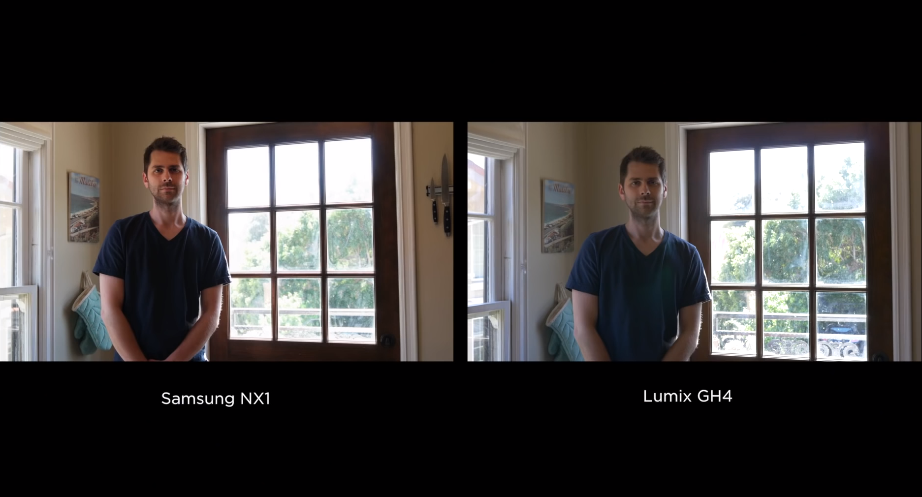

johnnymossville Posted April 3, 2015 Share Posted April 3, 2015 I'd put it somewhere just less than the GH4 in DR. looks closer to my GH2. Actually I'd say the NX1 is like a 4k GH2 with slightly better colors. Here's a test I saw online recently showing a DR comparison. Link to comment Share on other sites More sharing options...
neosushi Posted April 3, 2015 Share Posted April 3, 2015 Its extremely difficult to compare DR.Espescially with all those options (black levels, curve). For me the GH4 has actually very little usable DR because I always have to expose highly to the right to avoid the noise in all the slightly dark areas. All the tests I have seen in terms of DR haven't really convinced me. If you really want a CLEAN image with the GH4, you don't have that much dynamic range. And I don't think the highlights look nice on the GH4... :/ Link to comment Share on other sites More sharing options...
johnnymossville Posted April 3, 2015 Share Posted April 3, 2015 then you'll definitely not like the highlights on the NX1, which are worse. Beritar 1 Link to comment Share on other sites More sharing options...
neosushi Posted April 3, 2015 Share Posted April 3, 2015 Well I have both and I don't mind the highlights on the NX1. Link to comment Share on other sites More sharing options...
neosushi Posted April 3, 2015 Share Posted April 3, 2015 But it's also because I find it much easier to have a right exposure (considering noise) with the NX1, so I have less highlights issues with the NX1 in general. Link to comment Share on other sites More sharing options...

Geoff CB Posted April 3, 2015 Share Posted April 3, 2015 I'd put it somewhere just less than the GH4 in DR. looks closer to my GH2. Actually I'd say the NX1 is like a 4k GH2 with slightly better colors. Here's a test I saw online recently showing a DR comparison. Pardon me, but if you look at the details of that test it was complete GARBAGE. The reviewer used the stock settings on each camera to get his result, no tweaks to contrast or black level. Also he used a different lens on each camera.I agree with Jimmy, if your shooting in this scenario just light him properly and the issue goes away. What is more important in this shot to take note of is the skin tone, which is miles better in the NX1. Julian and arellaTV 2 Link to comment Share on other sites More sharing options...
Beritar Posted April 3, 2015 Share Posted April 3, 2015 then you'll definitely not like the highlights on the NX1, which are worse. I agree, i have both cameras and the NX1 highlights are really worse. I get better result with GH4/CineV profile (CineD is awful).However, like j.f.r. said, both cameras have poor DR and the NX1 has better resolution and colors. Link to comment Share on other sites More sharing options...
