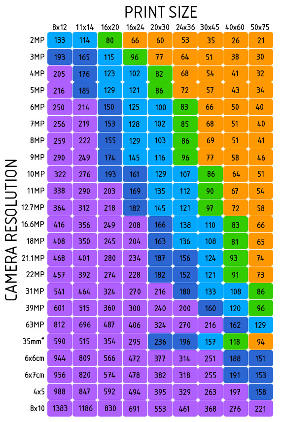

kye Posted June 15, 2023 Share Posted June 15, 2023 In terms of assessing the maximum size for printing, that's another whole debate, but a way to test it is to pull the image up on a 4K display, and then zoom in to the image until you start seeing the video compression artefacts, then reduce the size down a bit, and then measure how large the image would be if you printed it that large. Remember also that the larger you print an image the further back you will tend to view it from. A friend of mine won a certificate and got one of those canvas prints about 2' x 2' across. Â She sent in an early iPhone photo that was a close-up of one of her kids faces (it was a lovely photo) and the printing place said it wasn't "high enough quality" (read: not enough megapixels) and she had to insist they print it. Â She hung it high up on their photo wall and due to how the furniture was arranged you could see it throughout their open-plan living/dining/kitchen area, but you wouldn't have looked at it from closer than about 5' away, and even then you'd be looking up at it significantly. It looked great. Â Had it been taken with a high megapixel camera would it have been sharper? Sure. Â Would she have ever been able to afford a high megapixel camera? Â No. Â Would you ever take that kind of photo with a "real" camera? Â Unlikely. SRV1981 1 Link to comment Share on other sites More sharing options...
SRV1981 Posted June 16, 2023 Author Share Posted June 16, 2023 2 hours ago, kye said: In terms of assessing the maximum size for printing, that's another whole debate, but a way to test it is to pull the image up on a 4K display, and then zoom in to the image until you start seeing the video compression artefacts, then reduce the size down a bit, and then measure how large the image would be if you printed it that large. Remember also that the larger you print an image the further back you will tend to view it from. A friend of mine won a certificate and got one of those canvas prints about 2' x 2' across.  She sent in an early iPhone photo that was a close-up of one of her kids faces (it was a lovely photo) and the printing place said it wasn't "high enough quality" (read: not enough megapixels) and she had to insist they print it.  She hung it high up on their photo wall and due to how the furniture was arranged you could see it throughout their open-plan living/dining/kitchen area, but you wouldn't have looked at it from closer than about 5' away, and even then you'd be looking up at it significantly. It looked great.  Had it been taken with a high megapixel camera would it have been sharper? Sure.  Would she have ever been able to afford a high megapixel camera?  No.  Would you ever take that kind of photo with a "real" camera?  Unlikely. This is kinda my question !  for your personal life - do you need high MP cameras if you’re not heavily grading or cropping?   if you take video at 4k60p with shutter speed of 1/500 or 1/1000 sure the video may not look “cinematic” but if it’s purely for action and you’re using it to grab stills from and make 2x3’ prints for your wall or a photo album/book for coffee table and social media, does it matter?  if we’re at a point where I can invest in a great video centric camera and grab still frames for my photos that would be the ultimate workflow. Link to comment Share on other sites More sharing options...
SRV1981 Posted June 16, 2023 Author Share Posted June 16, 2023 Â 4k = 8.2 mp. Seems you can print a decent size for personal use!? Link to comment Share on other sites More sharing options...
