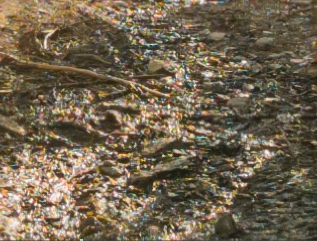

sir_danish Posted May 8, 2014 Author Share Posted May 8, 2014 Thank you. I am about to buy a diffusion filter for the Sigma, because it is too sharp. Moire means lower resolution. Resolution and sharpness are related, but you can have an overly sharp image with low resolution. Like in this case. That´s why I avoid shooting RAW when using the Sigma. It´s almost impossible for me to get a single moiré free shot. Look at this: http://i1285.photobucket.com/albums/a588/sir_danish/moire3_zpsbd471ec6.jpg~original Does this look like a streamlet? Purple and blue blotches everywhere, nobody would ever recognise this as sparkling water. I´ve been advised to shoot wide open to soften the image a bit... LOL!! Well, I can´t because of the problem mentioned above. I should try it with the pancake next time. Link to comment Share on other sites More sharing options...
