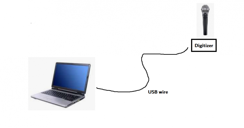

mkabi Posted October 4, 2021 Share Posted October 4, 2021 By the way, I haven't said anything about USB. Sorry for my rudimentary diagram. Look... in all reality XLR isn't transforming sound into Is and Os AND from my understanding USB doesn't accept analog information to flow through it.... you need a digitizer for that... so the problem isn't with USB Audio.... but the digitizer (transforming the sound into Is or Os)... you can place the digitzer anywhere you want.... you can take Mic to digitzer via XLR then move from digitizer to computer via USB. Even on-camera audio.... you can move from Mic to input device via XLR (its digitized on the input device or in-camera)... its then recorded on a memory card and then card info is moved via USB port..... so... in theory....why not digitize on the microphone itself where it is the quality that you want? Link to comment Share on other sites More sharing options...

KnightsFan Posted October 8, 2021 Share Posted October 8, 2021 The problem with USB audio for widespread use is it's limited to short cables. There are workarounds, but it gets complicated once you get to 5+ meters. XLR cables can easily be 10x that length. So XLR is better unless you know that the DAC is always going to be right next to the recorder. As far as non-USB digital audio goes, it would be interesting if we saw some uptake of RJ45 ethernet ports on cameras along with the necessary standards to carry video and/or audio. Those have (flimsy) locking connectors and longer run distance, plus there's a POE standard in place. But as of right now, the only universal standard for digital audio in the consumer world is USB. AES would help pro audio, but would be useless for most consumers still. @mkabiI think we're heading in the direction of putting the DAC (digitizer) in the mic housing like you are suggesting. Certainly the consumer world is. The Sennheiser XS Lav Mobile and the Rode VideoMic NTG are examples, and then there are a couple bodypacks like the Zoom F2 or Deity BP-TRX that are moving there for the wireless world. I think putting the DAC in the mic is especially beneficial for consumer products, because it means that the audio company is solely responsible for the audio signal chain. However, for the foreseeable future, if there is a wire between the mic and recorder, then analog via XLR to a DAC inside the recorder has no downsides compared to digitizing on the other end. If we're talking wireless it's a different story--it would be better to both digitize and record on the TX side, but that's a legal minefield. Also, the reason lavs get away with thin cables and 3.5mm jacks is because they have short runs. You can run unbalanced audio from your shirt to your belt, not 50m across a stage. mkabi 1 Link to comment Share on other sites More sharing options...

mkabi Posted October 26, 2021 Share Posted October 26, 2021 On 10/11/2021 at 6:22 AM, IronFilm said: That's a good analogy. Is it though? Okay fine... @IronFilm I value your input as you have invested way more than me in the audio industry... so... you can let me know if this is bad or good (meaning does the audio quality deteriorate or just as good): Link to comment Share on other sites More sharing options...
