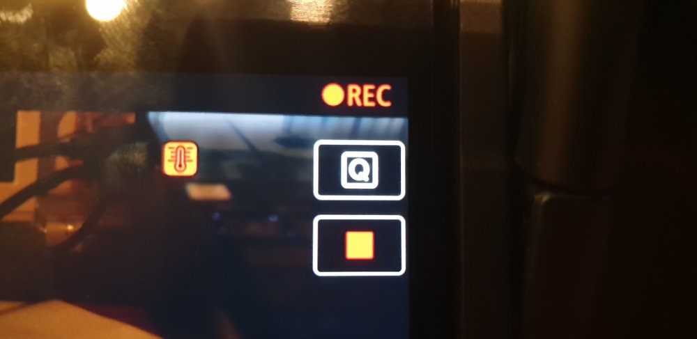

Coffe Posted September 6, 2020 Share Posted September 6, 2020 But this is interesting: There is another overheat symbol appearing after 15 minutes into my seconf 120fps run: one without the camera, a thermomter only. After stopping and taking out the card (leaving in the SD card) the symbol turns white. It disapears after taking out the (very hot) CFExpress card. So it seems to be an overheat warning for the CFExpress card. Stanly 1 Link to comment Share on other sites More sharing options...
horshack Posted September 6, 2020 Share Posted September 6, 2020 4 minutes ago, Coffe said: But this is interesting: There is another overheat symbol appearing after 15 minutes into my seconf 120fps run: one without the camera, a thermomter only. After stopping and taking out the card (leaving in the SD card) the symbol turns white. It disapears after taking out the (very hot) CFExpress card. So it seems to be an overheat warning for the CFExpress card. That's the overheat warning for stills operation. Page 284 of Canon R5 manual. Can you do me a favor and take a photo next time you see that stills warning? I'd like to check the camera's temperature for that threshold. It's embedded in the EXIF of stills images - you can send me a link to the out-of-camera image so I can extract it. Thanks! Link to comment Share on other sites More sharing options...
Coffe Posted September 6, 2020 Share Posted September 6, 2020 41 minutes ago, horshack said: That's the overheat warning for stills operation. Page 284 of Canon R5 manual. Can you do me a favor and take a photo next time you see that stills warning? I'd like to check the camera's temperature for that threshold. It's embedded in the EXIF of stills images - you can send me a link to the out-of-camera image so I can extract it. Thanks! This is Pictogram. I took a foto with my R5 close to that moment: Not pretty - but it should have the precious temperature reading you're looking for 🙂 Next time I will take that picture once I see the symbol again. It comes in red and also in white. And it disapeared seconds after I took out the CFExpress card. horshack 1 Link to comment Share on other sites More sharing options...
