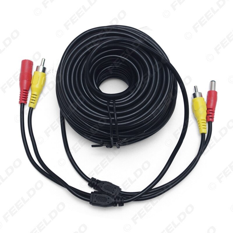

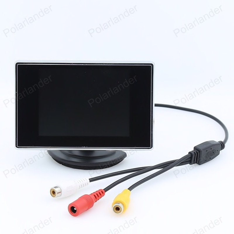

Super Members BTM_Pix Posted May 16, 2020 Super Members Share Posted May 16, 2020 24 minutes ago, PannySVHS said: @BTM_Pix the appealing part is the lack of thickness of the solution and being set up with just one cable. What cable would I need to look for to channel image and power to the display? Just an ordinary sdi cable giving power connection and an analogue composite? Suggestions for a monitor? Not meaning to be lazy doing my own research. Maybe though for today. Thanx and cheers! In all honesty, I think you are opening up yourself to a world of clunky lashing stuff together ugliness trying to do this. I'm not going to recommend any specific monitors etc but here is one example way to do it by basing it on the sort of 3.5inch monitor used for reversing cameras in cars. This will take in power and composite video and you'll then need one of these extension cables that carries both. This then connects to an HDMI to composite converter like this Then you will have to run power to the converter and also of course up to the monitor. The converter can run directly off USB so a dual outlet power bank would do it if you use one of these to supply power to the monitor on the other port as the monitor can run off 9v. And then you just need to add a DSLR loupe that will cover 3.5 screen to the monitor and have a way of attaching it, so try and find one of those that has the magnetic frame type of attachment. Typical prices for this sort of stuff on Aliexpress would be Monitor €12-15 Cables €8-12 HDMI>Composite €6-10 USB>9v step up €3-5 Loupe €10-14 So somewhere between €40-55 plus the cost of the power bank. Now there is no doubt at the viewing end of this that it will be relatively neat and compact but there is a price to pay at the other end for that (same as there will be in the part of the original photograph that isn't visible) but with enough velcro and gaffer tape I'm sure it could be made to work. Link to comment Share on other sites More sharing options...
