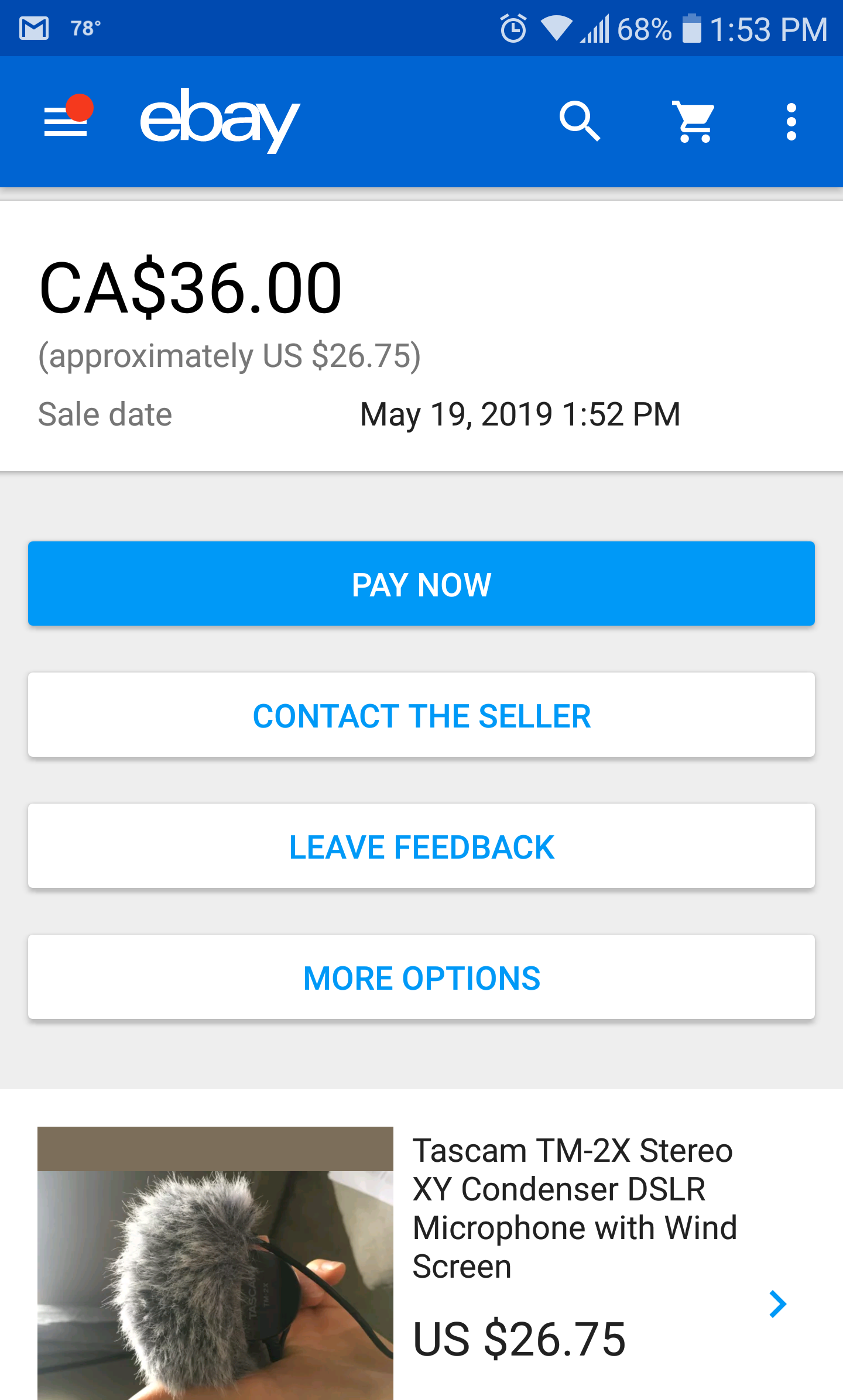

newfoundmass Posted May 19, 2019 Author Share Posted May 19, 2019 I just won a second TM-2X on eBay. A total bargain! This pleases me webrunner5 1 Link to comment Share on other sites More sharing options...
