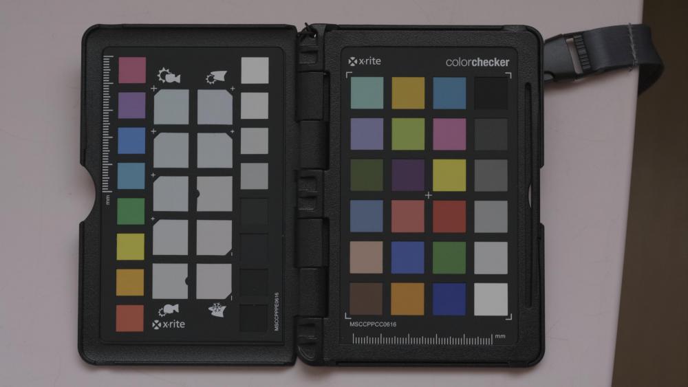

Attila Bakos Posted April 3, 2019 Share Posted April 3, 2019 The issue this video covers was already mentioned in several topics, but I promised a video explanation and fixes, so here it is. Beware: long, boring, bad English. andrew_dotdot, Papiskokuji, buggz and 5 others 3 5 Link to comment Share on other sites More sharing options...

Attila Bakos Posted April 3, 2019 Author Share Posted April 3, 2019 This correction should be the very first thing in the chain. Funny thing is that sometimes you will prefer the uncorrected version, especially with nature stuff, the wrong matrix gives a bit more warmth to the image. andrew_dotdot 1 Link to comment Share on other sites More sharing options...

Attila Bakos Posted April 25, 2019 Author Share Posted April 25, 2019 On 4/19/2019 at 3:10 PM, thephoenix said: any shifting in hlg ? i record botj internal and external in hlg and same color, actualy maybe more about saturation, and exposure difference between internal and external Sorry I couldn't test HLG yet, the only external recordings I got are not HLG. Something interesting: with the help of @Papiskokuji and a friend of mine I did some tests with Sony footage coming from two different Sony bodies, and it seems the files require the BT.601 matrix as well, but they are not even flagged. In Resolve all files look off, in Premiere some are okay, some are not. More testing is needed, but I'm surprised I don't see topics or videos about this. Papiskokuji 1 Link to comment Share on other sites More sharing options...
Llaasseerr Posted April 26, 2019 Share Posted April 26, 2019 Setting aside the 709 vs 601 issue, I've loaded the same Lazy Video Guy internal and external clips initially in Resolve 15 and I was able to get matching data levels when setting to full range. I then upgraded to Resolve 16 and now the h.265 clip comes in as video range when set to full. To get it to match the ProRes full range, I need to apply your "full to legal resolve" lut. I then downgraded to Resolve 15 to double check that it matches. Now I have the same issue as in the 16 beta, which makes me think there's an underlying library that got updated by the beta and did not get rolled back when I reinstalled 15. I'd be interested to hear if anyone else has had this issue. Link to comment Share on other sites More sharing options...
Llaasseerr Posted April 26, 2019 Share Posted April 26, 2019 I've done some HLG tests with the caveat that I seem to be seeing this "video levels" interpretation issue with full range h.265s now in Resolve 16 (see my post above). So right now, my test is inconclusive even after rolling back to Resolve 15 to do a sanity check. However as a workaround I'm using the "full to legal" lut for now. What I did notice is that the metadata tags for the internally recorded HLG are: Color primaries : BT.2020 Transfer characteristics : HLG Matrix coefficients : BT.2020 non-constant For the externally recorded ProRes it's all BT.709 for those tags which is clearly incorrect. We weren't paying much attention to the Atomos setup so maybe there was a "HLG" switch on it that tells it to embed the correct metadata. I had also used Editready to convert F-log clips, and it fixed the problem I'm reporting about the incorrect video levels interpretation of h.265. Something interesting though is that if I convert the HLG h.265 to ProRes using EditReady, it preserves the metadata tags. It means the converted HLG doesn't match the Atomos recorded HLG. However I feel the recorded HLG is interpreted incorrectly by Resolve because of its incorrect metadata. So the EditReady converted HLG is probably correct, and it matches the h.265 once I add the "full to legal" lut to the h.265. Link to comment Share on other sites More sharing options...
Attila Bakos Posted April 26, 2019 Author Share Posted April 26, 2019 Yes you have to be careful with externally recorded files. Unless you have some kind of switch they will have BT.709 flags, at least the ones I've seen so far, but sometimes the underlying data requires BT.601 or BT.2020 matrix, so the NLE will have no chance to show it correctly. Link to comment Share on other sites More sharing options...
