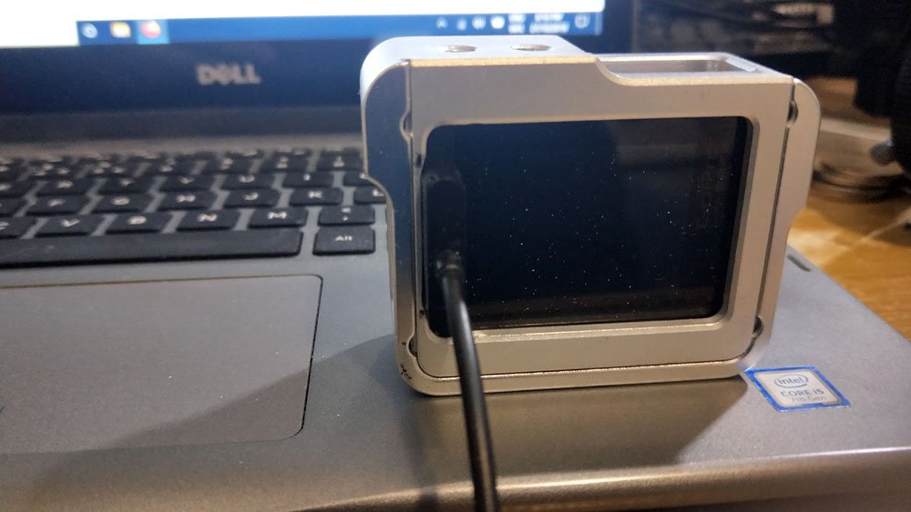

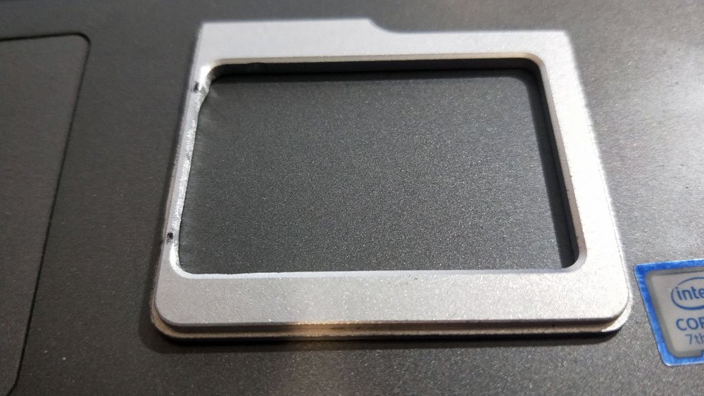

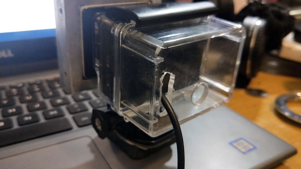

leslie Posted October 27, 2019 Author Share Posted October 27, 2019 broke out the dremel yesterday and today did my final hacks to both of the housings i use to enable the use of the battery eliminator cable. Had to grind away about 2mm on the left inside of the frame, for the alloy frame The plastic housing had more room to work with, however i had to grind a bevel on the top and bottom of the replacement rear housing as with the camera inside, the back housing was catching on the rear top of the camera. I still have to fill the voids with silicone or something, still considering that. I think i can make the plastic housing splash proof or rain proof i think but i doubt that it will be water proof, but thats ok for my purposes i think. Pretty happy with the mods i have made, i do think it will open up a few options to explore. I did get outside just on sunset with the letus anamorphic and the faking it frame i have made, yet to look at the footage. Guess we'll see if it has any potential shortly Link to comment Share on other sites More sharing options...

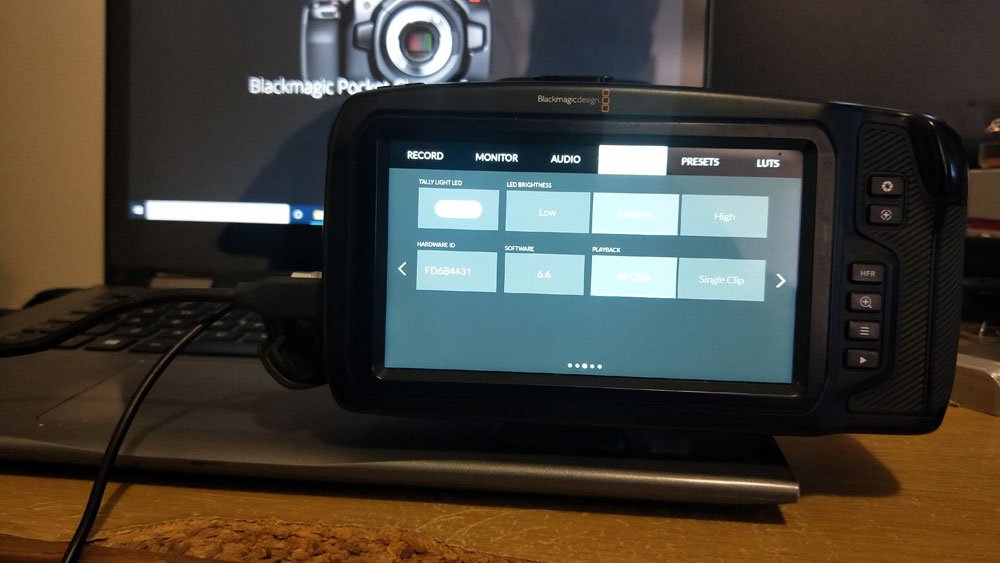

leslie Posted November 3, 2019 Author Share Posted November 3, 2019 updated davinci resolve to 16.1.1 the other day and the p4k camera to 6.6 today. No issues with either updates. The camera update stalls at 70% for two and a half minutes but i knew this from the p4k thread. While its at 70% i get a couple of notifications that the p4k drivers or whatever are being installed, which is a bit disconcerting as you get the usb bell sound informing you that something is either inserted or removed and i'm thinking the update is about to fall over however it doesn't. Had a bit of a lung infection lately, might have overdone it on friday spent 16 hours in the car driving around helping the brother and his boss out. i also had a plan to video some of their expensive Arabian horses on sunset, due to a couple of showers of rain that didnt happen, we had pizza and watched the latest aladdin instead. Got home around midnight spent the next 18 hours sleeping i think. Ironically the bosses wife breeds and train Arabians and then sells them back to Arabia, go figure ? I always though my laptop was 8 gig, after reading the p4k update change file, i checked and found i only had 4 gig, looks like the next spend will be on computer ram. Link to comment Share on other sites More sharing options...

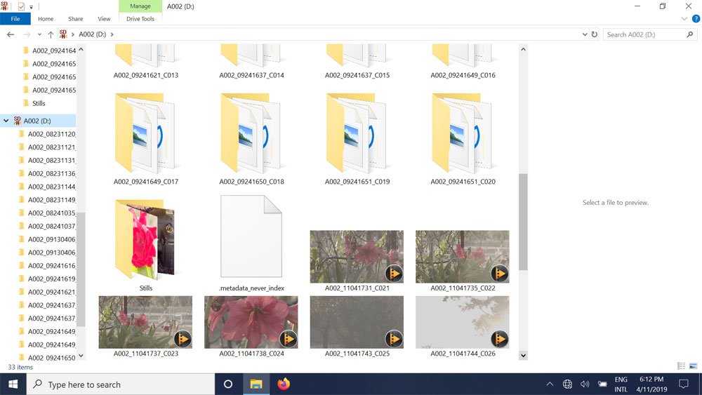

leslie Posted November 4, 2019 Author Share Posted November 4, 2019 windows has done a couple of big updates over the last few days, whatever its done has broken viewing dng folders and image sequences. Maybe i need to reinstall the codec perhaps, not really an issue i guess since i updated resolve studio and are now playing with raw. Raw files display just fine in explorer Link to comment Share on other sites More sharing options...

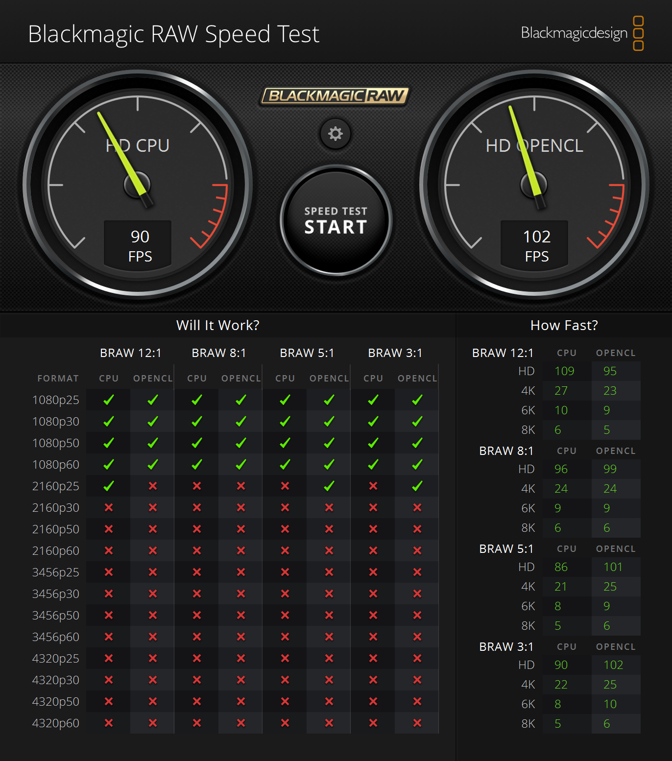

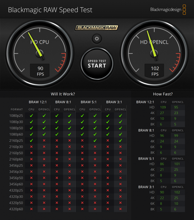

leslie Posted November 6, 2019 Author Share Posted November 6, 2019 seeking enlightenment, i ran the black magic raw speed test that came with resovle 16.1.1. It looks like my dell laptop i5 with 4 gig will only handle hd at its various frame rates. No big deal for me as i have no 4k tv yet anyway and i have been happy enough shooting 1080. I do plan on adding more ram to the laptop and i do have a usb 3 port maybe i could plug a gpu into that perhaps, something to look into. i did notice the minimum frame rate is 25 for the speed test, whats up with that ? why no 24fps ? its kinda canonish isn't it lol ? In the long run its probably a non issue, most people will probably spend the money on a fast card or two or get the samsung t5. What i do think would be cool is if bmd could implement a speed test for cards, i know bmd have a list of recommended cards to use however i think it would be advantageous if users could perform their own tests they could then decide if they wanted or needed to spend $$ on the faster cards. I know i can record braw 3 to 1 for at least a minute with a cheap 32gig card from woolworths. With 6.1 and dng's i got about 35 seconds. In one way i was kinda lucky i pre ordered waiting 5 months for the p4k gave me a chance to put a few dollars together to get the samsung t5 ssd, if the p4k had of turned up earlier priorities may have changed perhaps. I probably appear a bit stingy and you'd be mostly right .? Link to comment Share on other sites More sharing options...

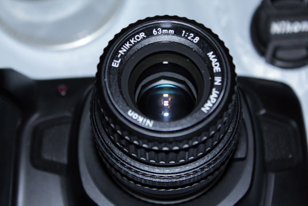

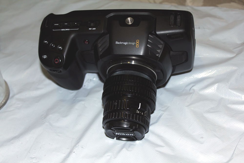

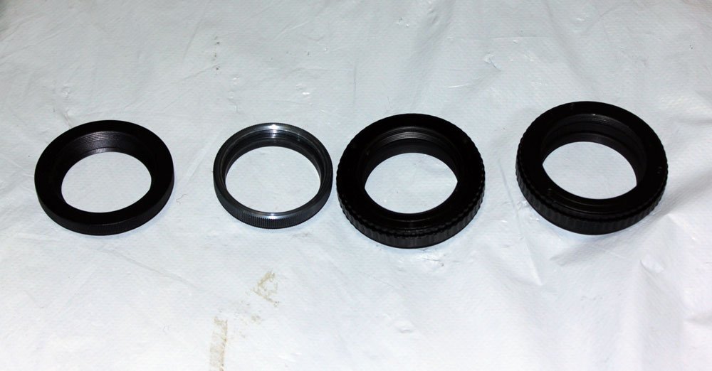

leslie Posted November 6, 2019 Author Share Posted November 6, 2019 dusted off the elmoscope anamorphic today, tried a couple of different lenses 24mm vignettes quite badly, 35mm just gets the corners, a 37mm might just be ok 40mm should be ok.The issue being i dont have a 37mm or 40mm i do have a 50mm so that will be the next on the agenda to try. While playing with various bits and pieces i cobbled two helicoids together and mounted that to the el nikor 63mm enlarging lens to the thinnest m42 mount i had then there's a 6mm spacer in there as well. Its not exactly pretty but i can get infinity focus. Now just need btm to add a button for stills into his app then all will be good in the world. Because its pita to press the button on the p4k in the dark lol i'll get a few photos tomorrow, Link to comment Share on other sites More sharing options...
leslie Posted November 7, 2019 Author Share Posted November 7, 2019 here is the photos of whats involved in getting the el to infinity focus. At this point its not a particularly elegant solution, it does however give you proper lens like focus. The other way of doing things is to follow tito's guide but that only gives you infinity focus and i was more inclined to having a lens with focusing abilities. I do have one thinner mft mount on order yet to arrive once i get that i'll reexamine things and find a more suitable helicoid, that should make it a two piece solution i hope. The helicoids i used were two 12-17mm. I should point out this arrangement is only for the mft mount on my bmp4k. How it would work on a different mount i'm not sure yet, i can try it on a ef mount but that will be later. i have also bought a bolex 16mm anamorphic lens, it has fungus issues, i either stuffed up the currancy conversion or i wasn't cheap enough as he accepted in less than an hour ? Link to comment Share on other sites More sharing options...

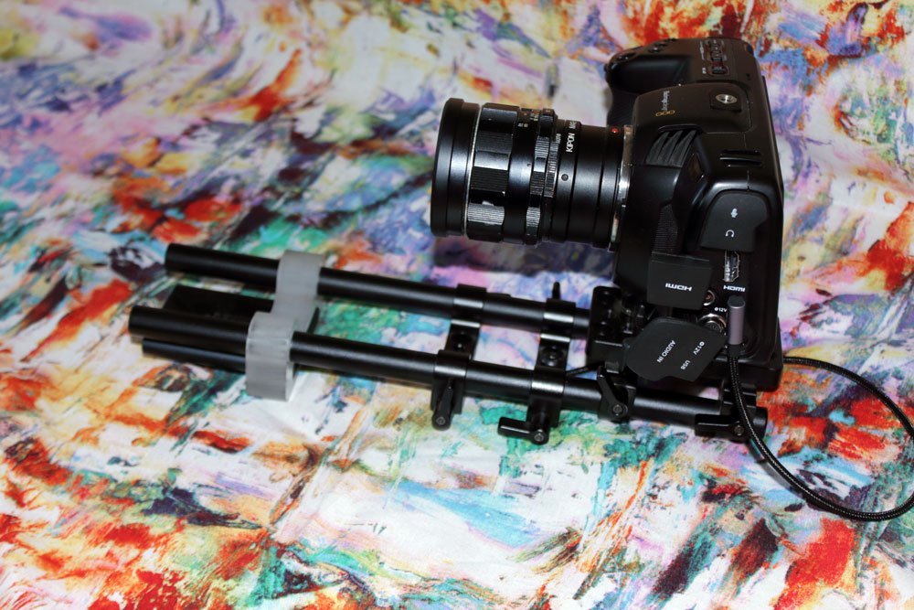

leslie Posted December 1, 2019 Author Share Posted December 1, 2019 i know i said pics were coming and they are.. In the interests of upping my gamesmanship, i have gone with moving pics. I utilized the pk4, the viltrox speedbooster and a pentax m42 50mm f1.4 not to mention some fabric, a board and a lazy susan. Learned quite a bit today, i must really press hard down on the p4k shutter as i had to cut the last couple of seconds of each of the clips due to movement. I also really messed up on two of the clips in the middle with the colour. You'll also see the scratch i made in a couple of the clips. learned a few more things about resolve as well. Been raining most of the day, which is very welcome, so was squashed between my mums car and my motorbike. I thought with my mums car being white and about two feet away it would have reflected more light, that wasn't the case. with pulling the lens off the front i dont think i have the anamorphic aligned properly, since i still have to do the back element, i will pull it apart again as its all just finger tight at the moment. I'm thinking of investing in one of those white out pens nothing else seems to show up on the blackened outside of the anamorphic. i do have everything i need to motorize the lazy susan except a driver board for a stepper, perhaps next time i do it again it will be all sorted out i hope. bolex.mov Link to comment Share on other sites More sharing options...

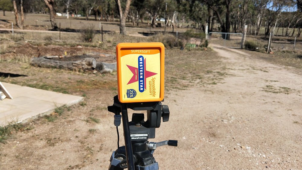

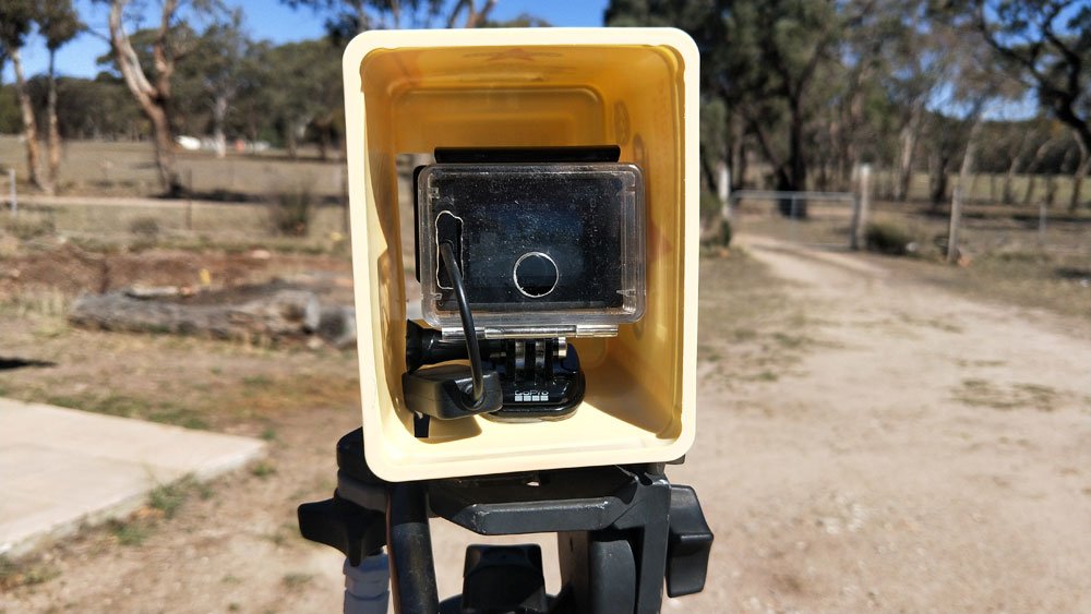

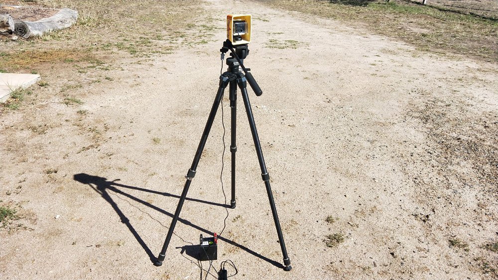

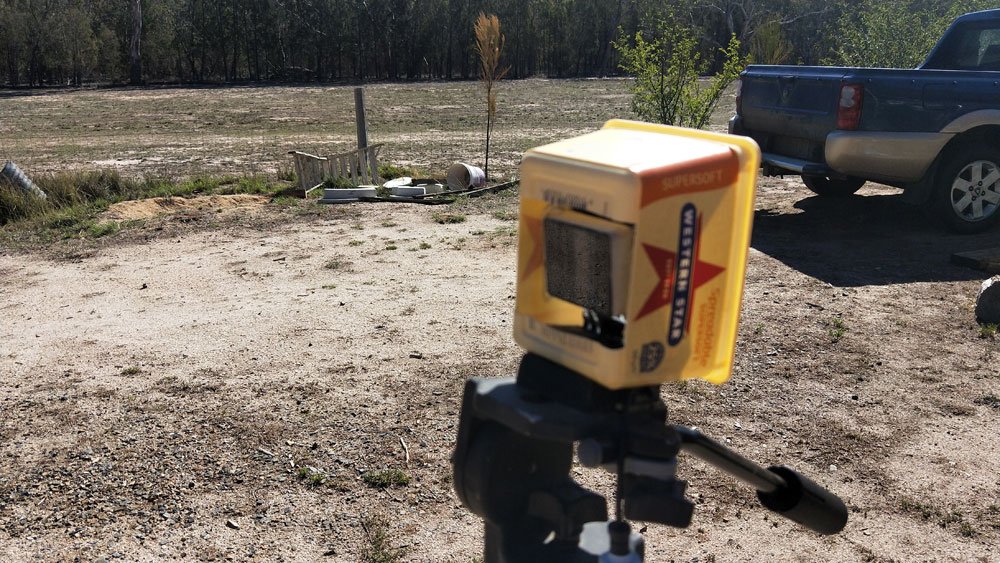

leslie Posted December 4, 2019 Author Share Posted December 4, 2019 I am convinced somewhere in my room is a a black hole that randomly eats things.. then months later spits them back out ? After looking in the absolutely last place i would imagine for a cable for the gopro battery eliminator to hide in ... i finds it ? Its been awol for several weeks As a proof of concept i made up a quick and dirty cover for the gopro since the battery eliminator is waterproof no longer. All it has to do is keep most of the water off the back of the gopro as the front should be ok i think. there's a slot in the bottom for the cable and water to drain away. I have done this just in case i get called away or i get distracted with something else, while i run a time lapse and a sudden storm comes up. i may add a rubber band around it to keep it together, winds have been pretty severe of late its surprising how much of the container i had to cut away to avoid it showing in the photos with the letus anamorphic. Link to comment Share on other sites More sharing options...

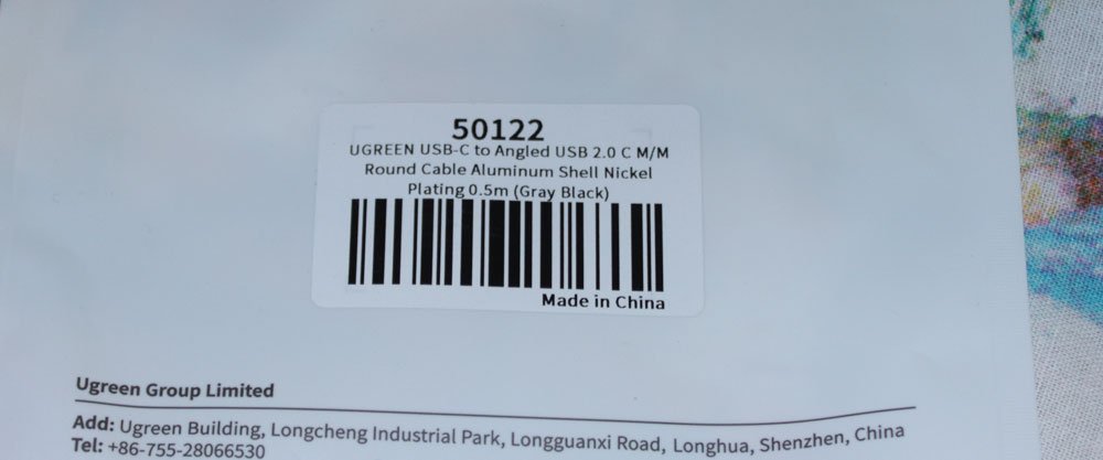

leslie Posted December 31, 2019 Author Share Posted December 31, 2019 Good morning all, Happy new year. New year, new resolutions i guess. I plan on being a bit more active/creative this year Got the gopro setup, running a timelapse as we chat. May have some sort of wildlife video to show for it later today. The ugreen usb c lead with a 90 degree angle connector turned up a few days ago. Initial setup wasn't promising, i couldn't get a connection between the p4k and the t5 ssd. However i have had another play with it this morning and turned all the connections either, upside down or the other way around and now i can record to the ssd, not sure if perhaps i didn't have the cable seated properly the first time round which is a bit embarrassing as i left a neutral comment on the ebay feedback link . On the back of the ugreen packet is a sticker showing thats its only usb 2 not 3.1 so looks like i have some testing to see how long i can record to the ssd before it drops frames. Considering that it was $10 posted and the tilta p4k cable comes in at $40 posted to aus i 'll be using the ugreen for awhile. The 90 degree connector does make for a more streamlined setup much less chance on getting hooked up on something i hope. Theres nothing on the ebay link to say its not usb 3.1 that i noticed, you just assume that being usb c it would be 3.1. At the moment the main thing is i can record to ssd not sure for how long, at some point i'll have to upgrade. i'm kinda hoping it will be later rather than sooner. Got an email from sirui this morning apparently there's 10 days to go till the early bird offer closes for the anamorphic so i'm still in with a chance to get one. Got some colour correcting gels to play with last week haven't opened them yet. I was thinking of doing an unboxing video for something different and the experience. I have also ordered a cheap led light i have seen reviewed on youtube. When that turns up things should get mildly interesting. there's a metal backboard in the process of being spray painted. I have some plans of using it for testing purposes and vlogging if all the planning comes together. Link to comment Share on other sites More sharing options...

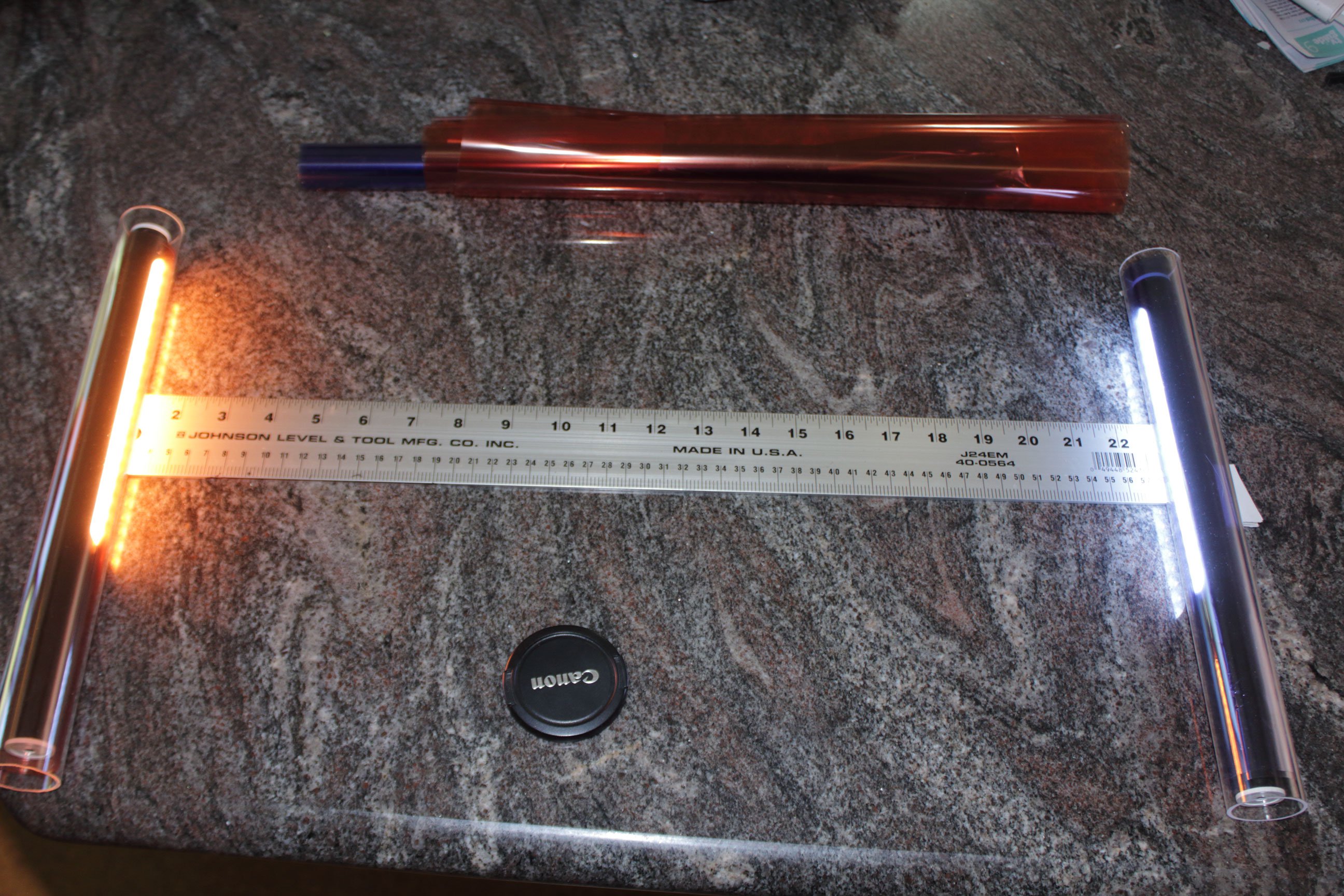

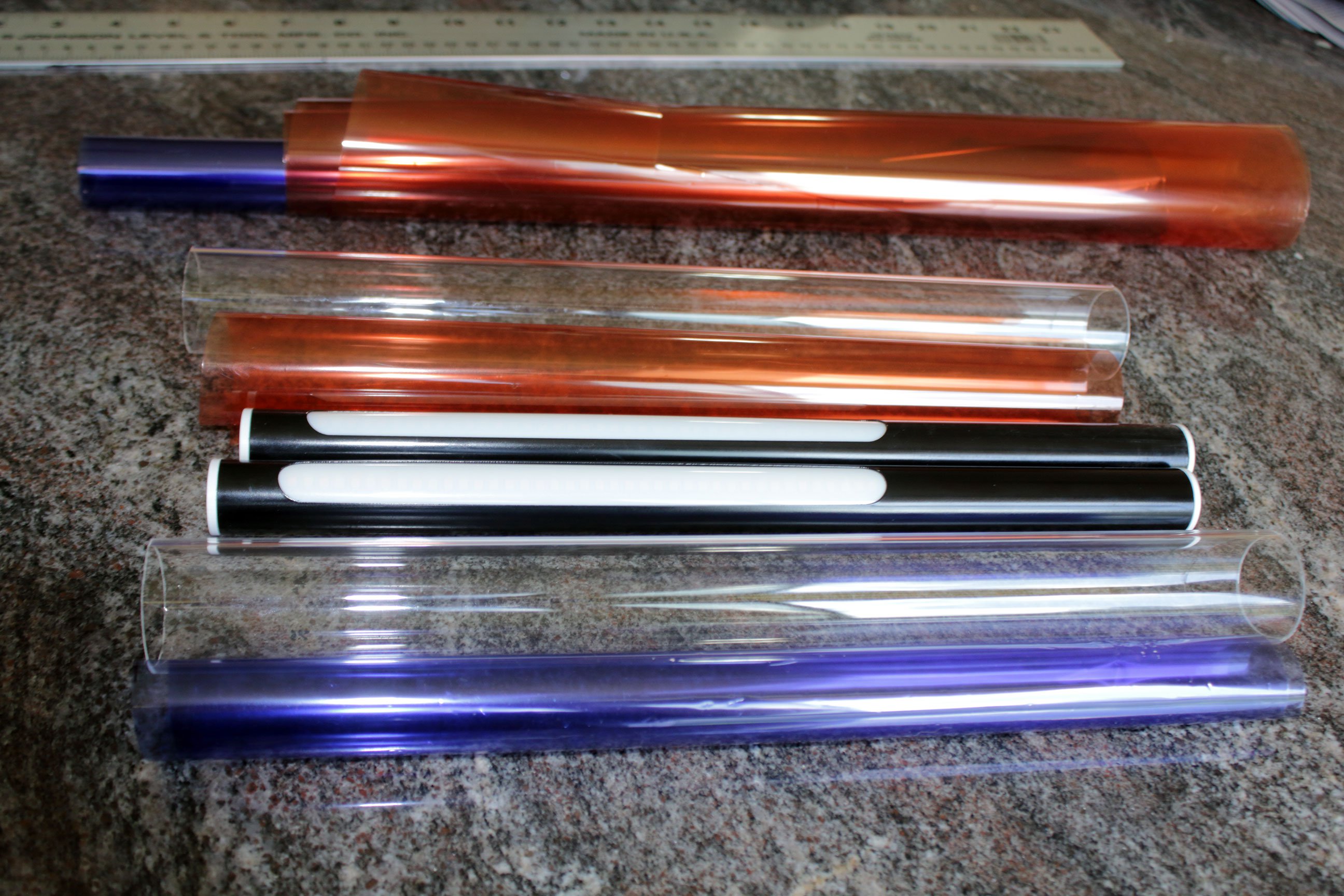

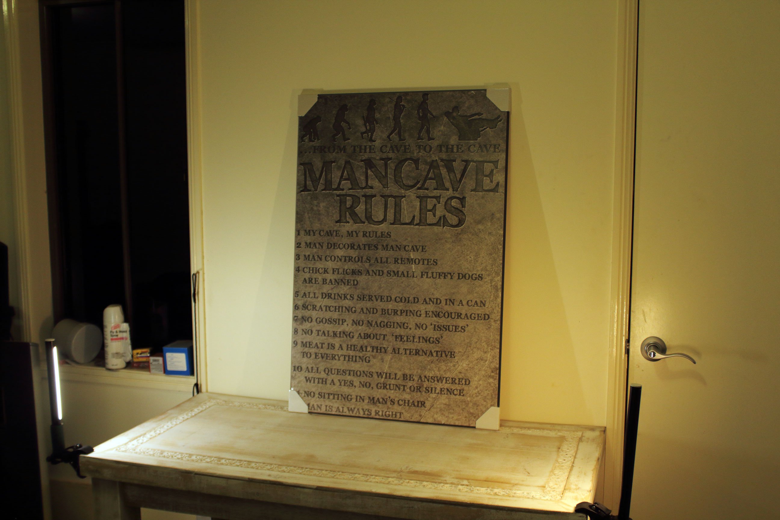

leslie Posted March 10, 2020 Author Share Posted March 10, 2020 Bought two cheap led lights of Amazon a moth or so ago. Don't normally buy of amazon, had to open an account normally i get most of my stuff of ebay. However i found a review of some cheap led lights from dslr video shooter. but couldn't find them on ebay. I'm impressed they don't flicker. Been waiting for some other parts to arrive and now they have. Dust has been a bit of a problem this or last year, more to the point. So i have been thinking of how to keep them clean as i'm not big on dusting i plan on using them for accent lights. I also bought some cheap bike clamp light holders they seem to open wide enough to grip a 45mm table edge ok. Since i love the orange teal look, i bought a bunch of gel filter material and a meter long length of perspex pipe i cut the pipe into three sections long enough to cover the led lights and cut some orange and blue gel filter material to slide inside the perspex. The filter material is one and a half times the diameter of the tube. I can either use them at normal strength or turn the light 180 degrees and get a double strength filter. I plan on getting a mate to turn up some caps for the top and bottom shortly just need to measure the barrel of the charging lead hopefully its smaller than the larger of the tripod threads. I just eyeballed the bottom of the p4k rig it has provision for both thread sizes and the lead with the round charging port will fit inside the larger thread quite comfortably i think. At some point bike mount clamps may not be suitable all the time, I sort of figure i'll get some stands, with the thread on the bottom it should be easy to mount them on stands in the future. heart0less 1 Link to comment Share on other sites More sharing options...

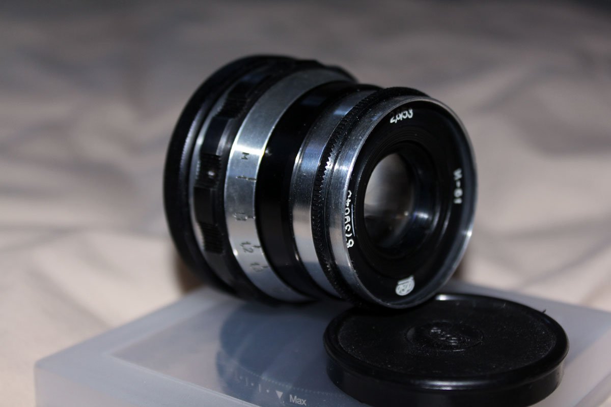

leslie Posted May 18, 2020 Author Share Posted May 18, 2020 Well its been awhile, a couple of lenses have been added to the collection. The first being a russian lens an industar 61, 53 f2.8, nice exterior, great lenses but more play in it than the local kindergarten, which is rather disheartening. focusing turns really easily till it hits a rough patch in the middle. it was the only question i didn't ask the previous seller seeing it was pretty cheap it would probably cost more to send it back. So far it seems like it requires a different flange distance adapter to what i have already Things being a bit tight i haven't really worried about sorting it out just yet. The other lens is a vintage canon or fd mount, but its a bit of an odd one for the forum i think, and its still on its way from the usa. Postage was quite reasonable oddly enough coming from the usa, however the conversion rate left me high and dry. Looking on ebay it seems about $60-80 cheaper than some others i have seen, hopefully its a good deal. I have sworn of lenses till i can put some dollars together for a fvd16a for the elmoscope type 1. Got a confirmation email from rapido this morning that the fvd16a will fit. I'll just buy the front adapter / clamp thing as well, i have the rear mounting already sorted. PannySVHS 1 Link to comment Share on other sites More sharing options...
