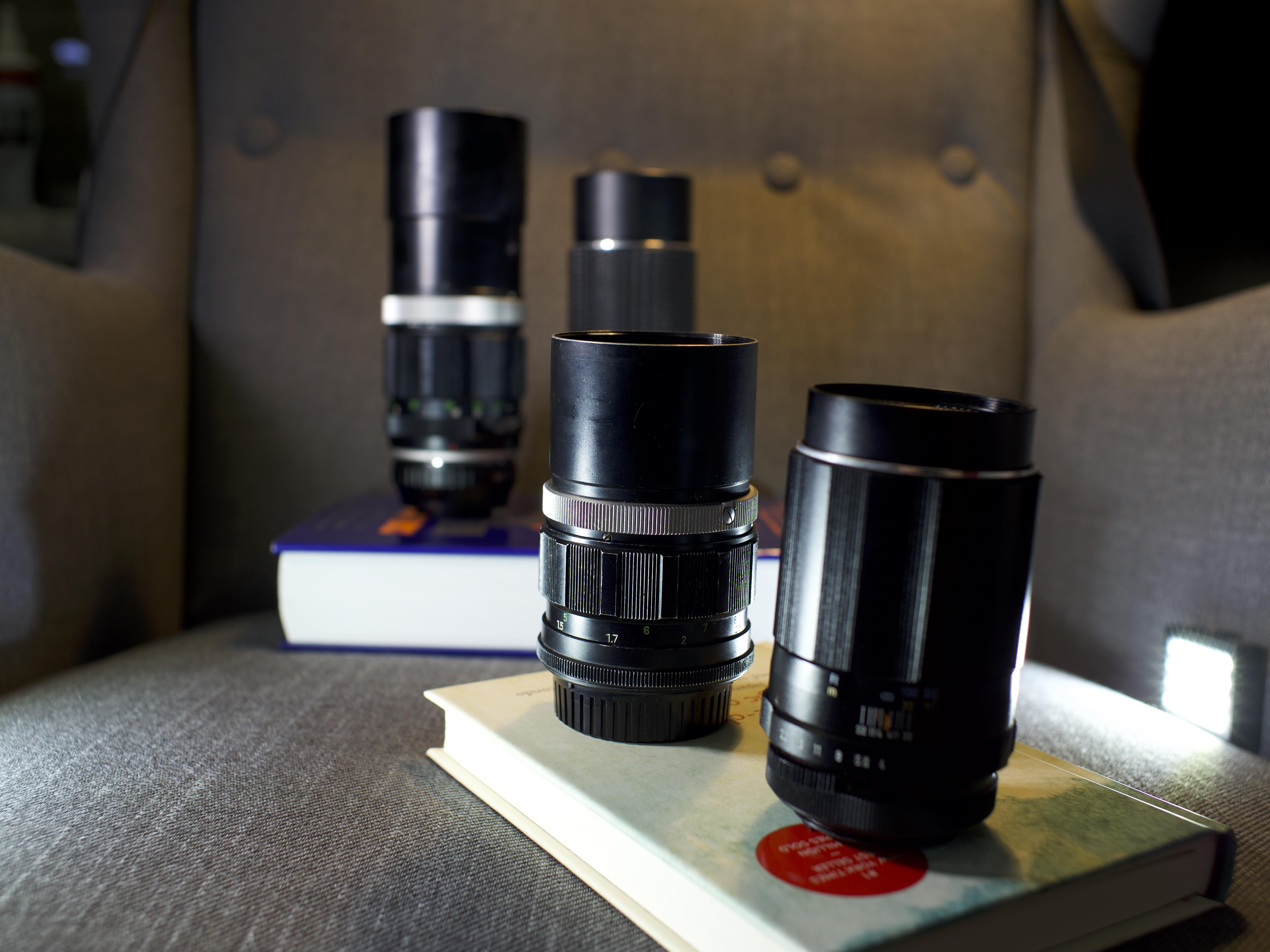

My last lenses are due to arrive, and before I shoot 10 million test images I want to make sure the test is good.
I will be shooting lenses with a wide range of different focal lengths, maximum apertures, and minimum focal distances.  I've done a test mini-shootout that looked like this:
~50mm on SB F2.8:
532617875_P1066672Helios58mmwithSBatF2.8.thumb.jpeg.d488fc16ad1b7d964a8d09b9cd443b72.jpeg

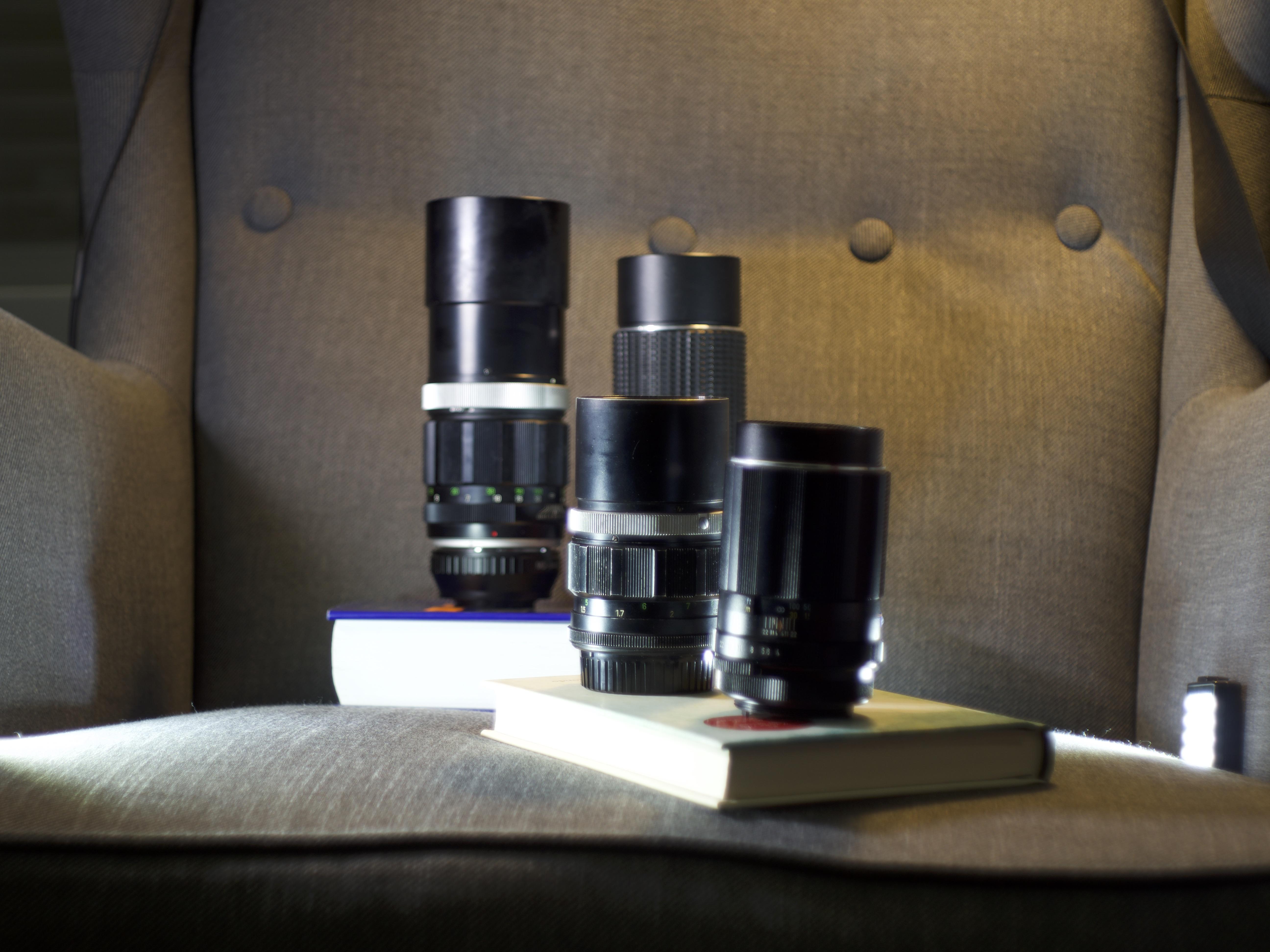

~40mm no SB F2.8:

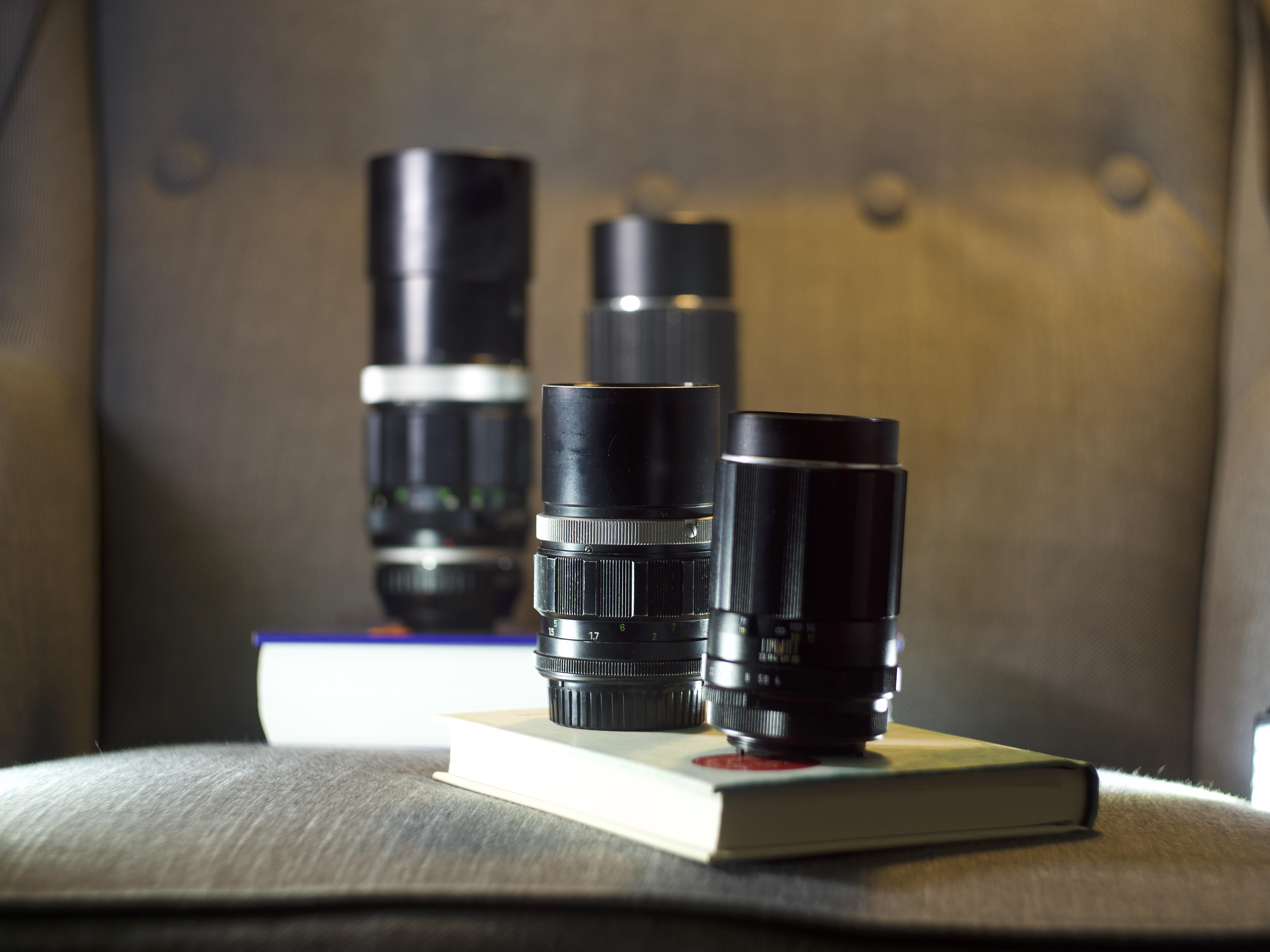

~20mm no SB F2.8:
326044332_P1066665Voigtlander17.5mmatF2.8.thumb.jpeg.0c6120326c8b600d518f9e9e1442d617.jpeg
I tried to keep the same framing so had to move the camera back with the longer focal-lengths.  Unfortunately, because of this the DOF is different on all lenses even though those test shots are all F2.8.
Do I make a test scene where the framing is similar in each lens so that you can compare resolution (ie, the texture or reference charts) and accept that the DOF will be different, or do I keep the DOF the same but vary the framing, meaning that you can't compare resolution etc.
I'll be testing lenses that range from 8mm F4 to 200mm F4 and with apertures as much as 0.95.

That is a 135mm f3.5 Takumar right? Focus ring it sooooo smooooooth!

Smooth like butter!!  It really is incredible, and my one is virtually brand new.  The other Takumar lenses are all just as good, if a little firmer.  It's a pity they don't look as good or have the focus ring going in the right direction 😆😆😆
