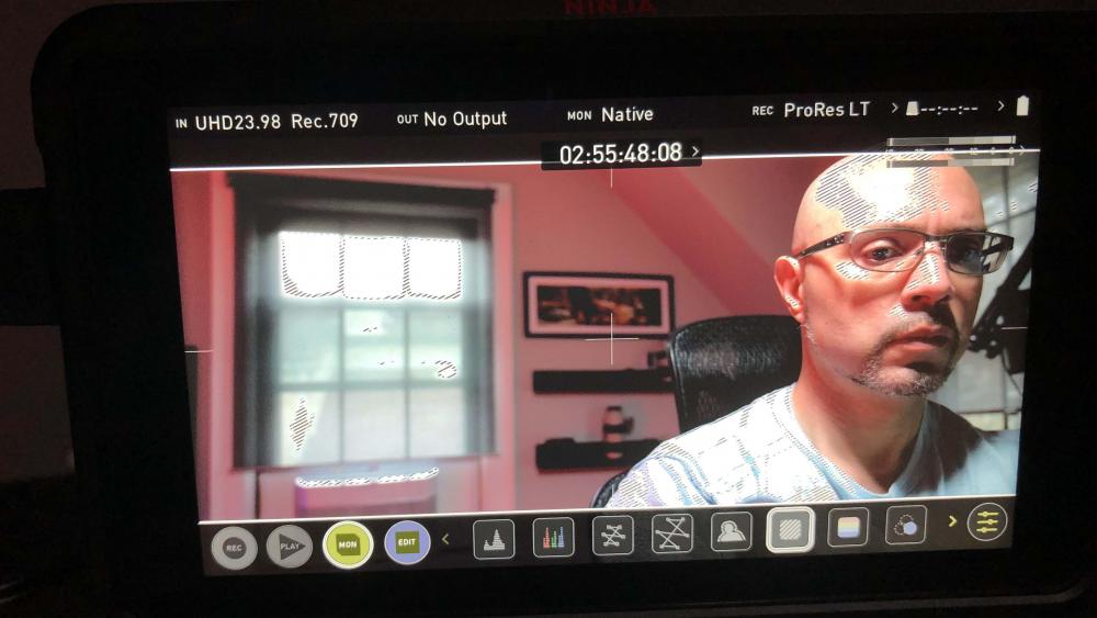

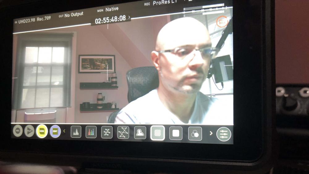

Ok, all of this speculation about exposure is a bit much. Here is a quick test I just did with ample... ample light. As you can see, after a quick pan to the center of the room to find a different focus point, when I re-center the camera with my face in the scene again it cannot recognized my face. It just sits out of focus. If I am talking it still does not find me. I have included some shots from the Ninja. Trust me when I tell you, under/over or correctly exposed... with NLog enabled AF becomes unreliable. Hey folks it's your money. I'm just sharing what I have found.

Log profiles involve collecting a larger data set than normal and then conforming it to fit a smaller data space using an algorithm. That would require more processing than non-log, so it would not be surprising to see things like AF affected if the processor is operating near it's limits.
