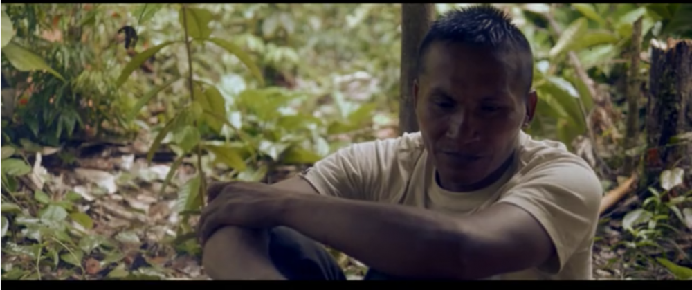

I'm not sure what kind of look you are going for with this story, but I got this after a few minutes in Resolve...kind of an old Kodak film look (I worked just off of a screenshot so it isn't very high quality)
5a72bbef0e301_ScreenShot2018-02-01at9_02_36AM.png.b0acaf14a473f637a3e000ce682a56e1.png
This was your original:
5a72bc349af86_ScreenShot2018-02-01at9_02_50AM.thumb.png.ad16b3ca722f794a199f4c7f4bb24e39.png
@Benjamin Hilton this is actually the most difficult shot to grade. As you can see the face is behind fire so the air is wiggling. Now I see that my grading was not nice so thank you a lot!
No Problem.  I attached a LUT I exported of that grade if you want to try it out as a base for the sequence.  It includes all the adjustments minus the power windows to bring up his face.
I think power windows are your friend on a project like this where you really couldn't light.  They give you the ability to draw the attention to the right places by bringing the exposure up or down in certain areas.
Grading is a very fine art that takes a lot of practice, don't give up!  It's worth taking the time to learn and practice and become a master.  (I still feel like I have a long way to go here)
Jungle Grade V_1_32.Screen Shot 2018-02-01 at 8.46.59 AM.cube
