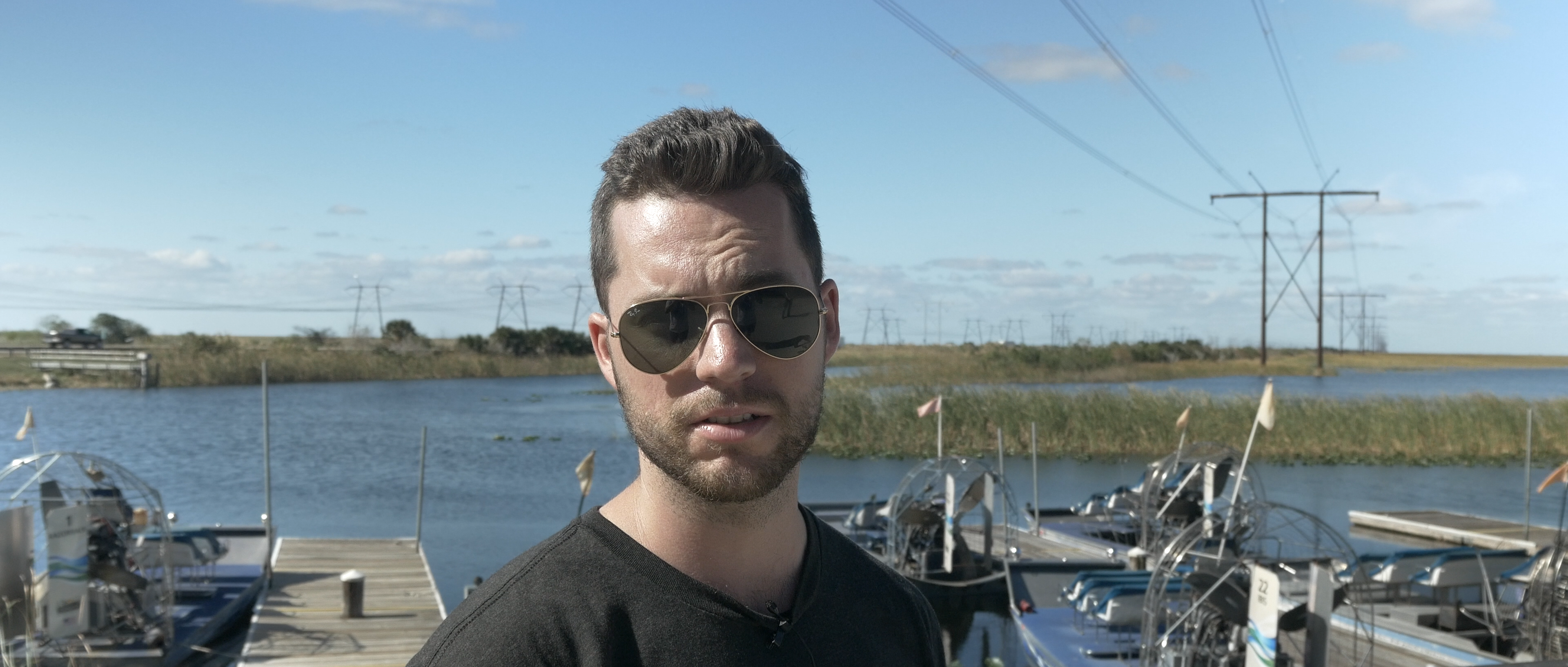

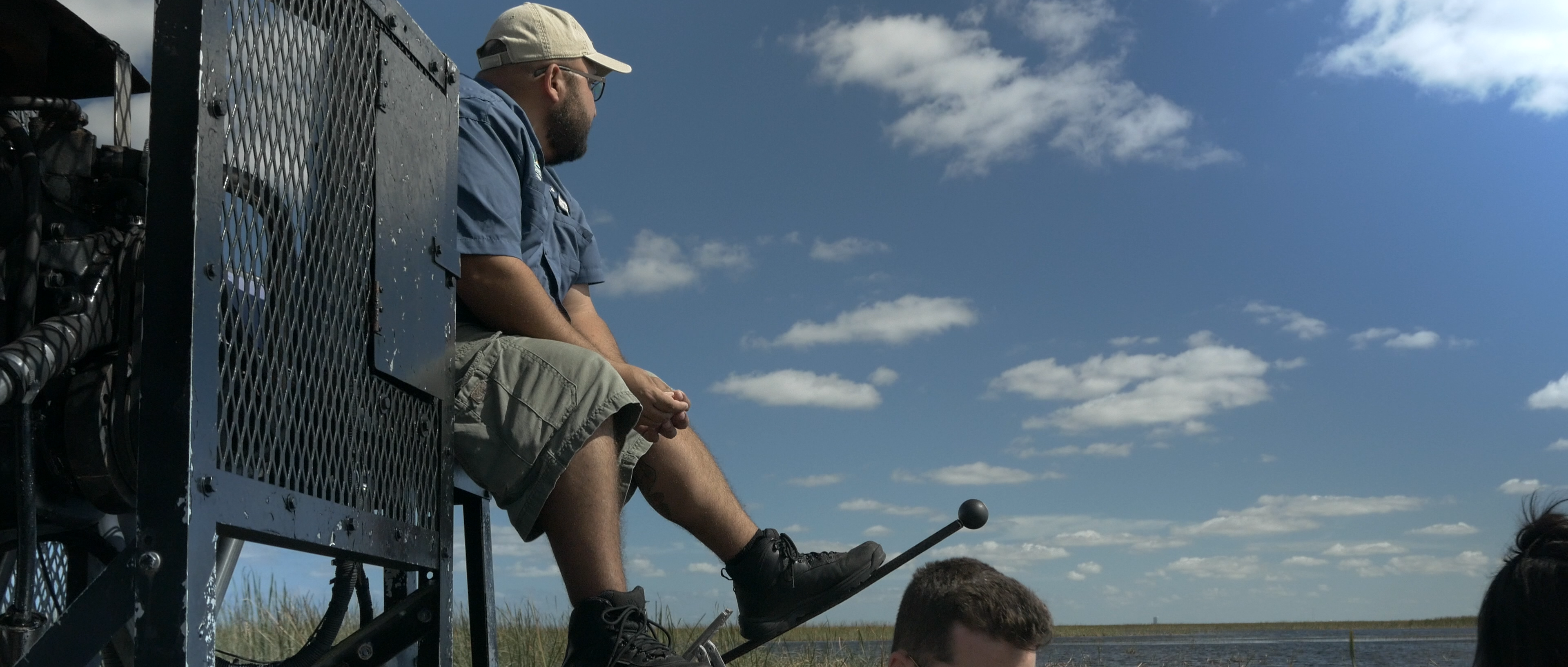

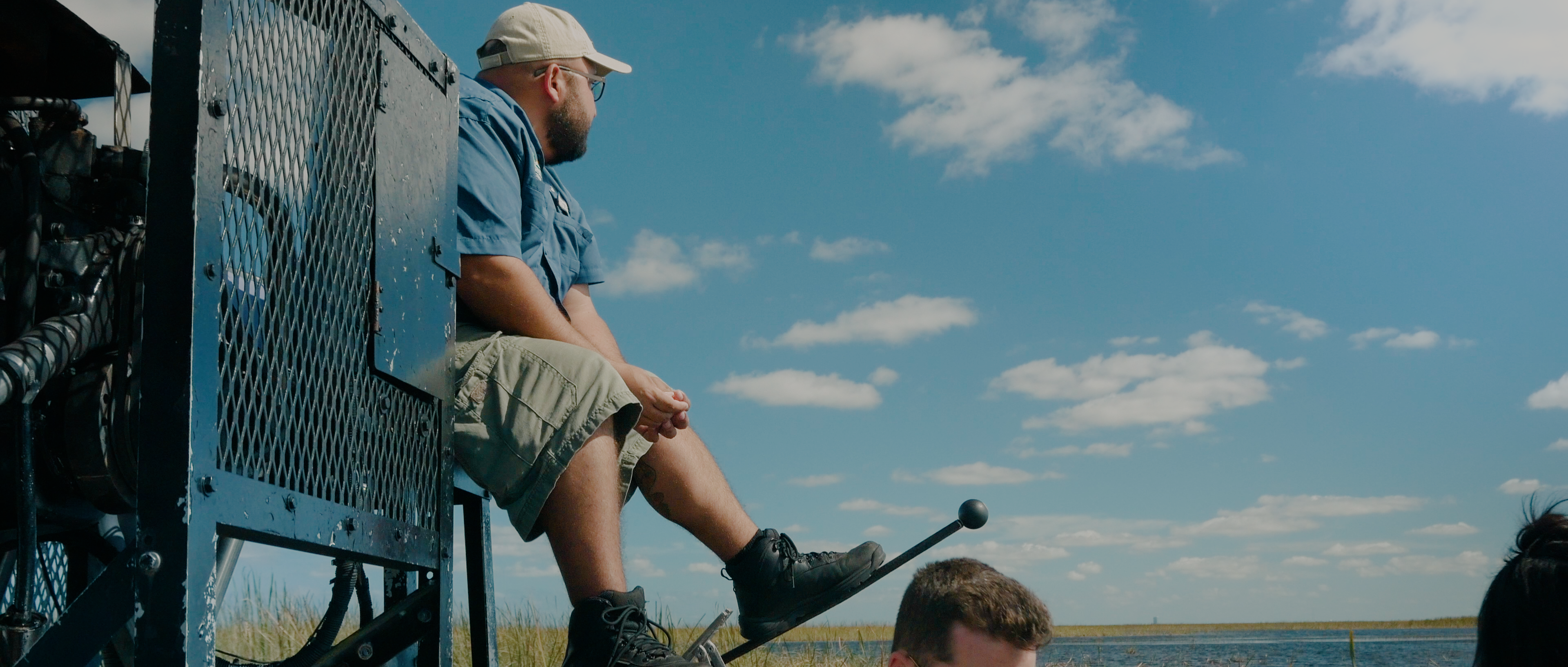

katlis Posted February 10, 2019 Share Posted February 10, 2019 Wanted to share more GX85 Cine-D samples. It's fun to carry around with the 14-42mm pancake for impromptu video when I'm not using it for photos. Additional coloring was done on top of GHa. deezid, Sage, JeremyDulac and 4 others 7 Link to comment Share on other sites More sharing options...
Sage Posted February 11, 2019 Author Share Posted February 11, 2019 17 hours ago, katlis said: Wanted to share more GX85 Cine-D samples. It's fun to carry around with the 14-42mm pancake for impromptu video when I'm not using it for photos. Additional coloring was done on top of GHa. Love those stills man, especially the middle one Do you use the digital olpf settings? They really improve texture Link to comment Share on other sites More sharing options...
katlis Posted February 11, 2019 Share Posted February 11, 2019 6 hours ago, Sage said: Love those stills man, especially the middle one Do you use the digital olpf settings? They really improve texture No olpf blur on these. Just quick color tests to see how much I could save this random GX85 video. On a related note, I've gotten my DD1 filter and will share some GH5 results later, but so far I've noticed a nicer texture, however it adds quite a bit more flaring to the image. Link to comment Share on other sites More sharing options...

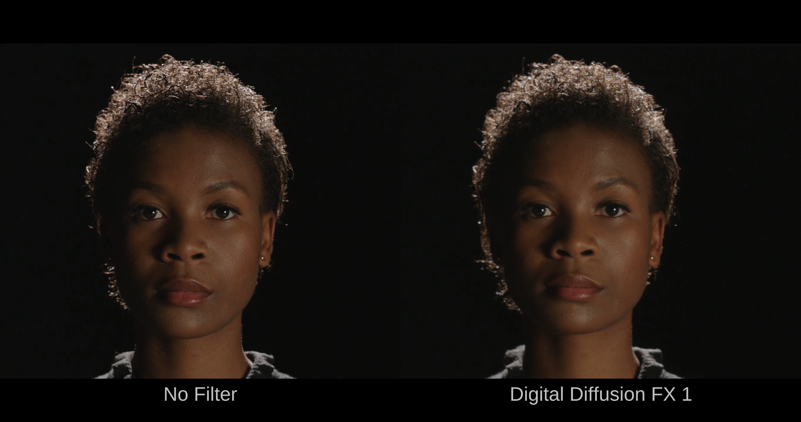

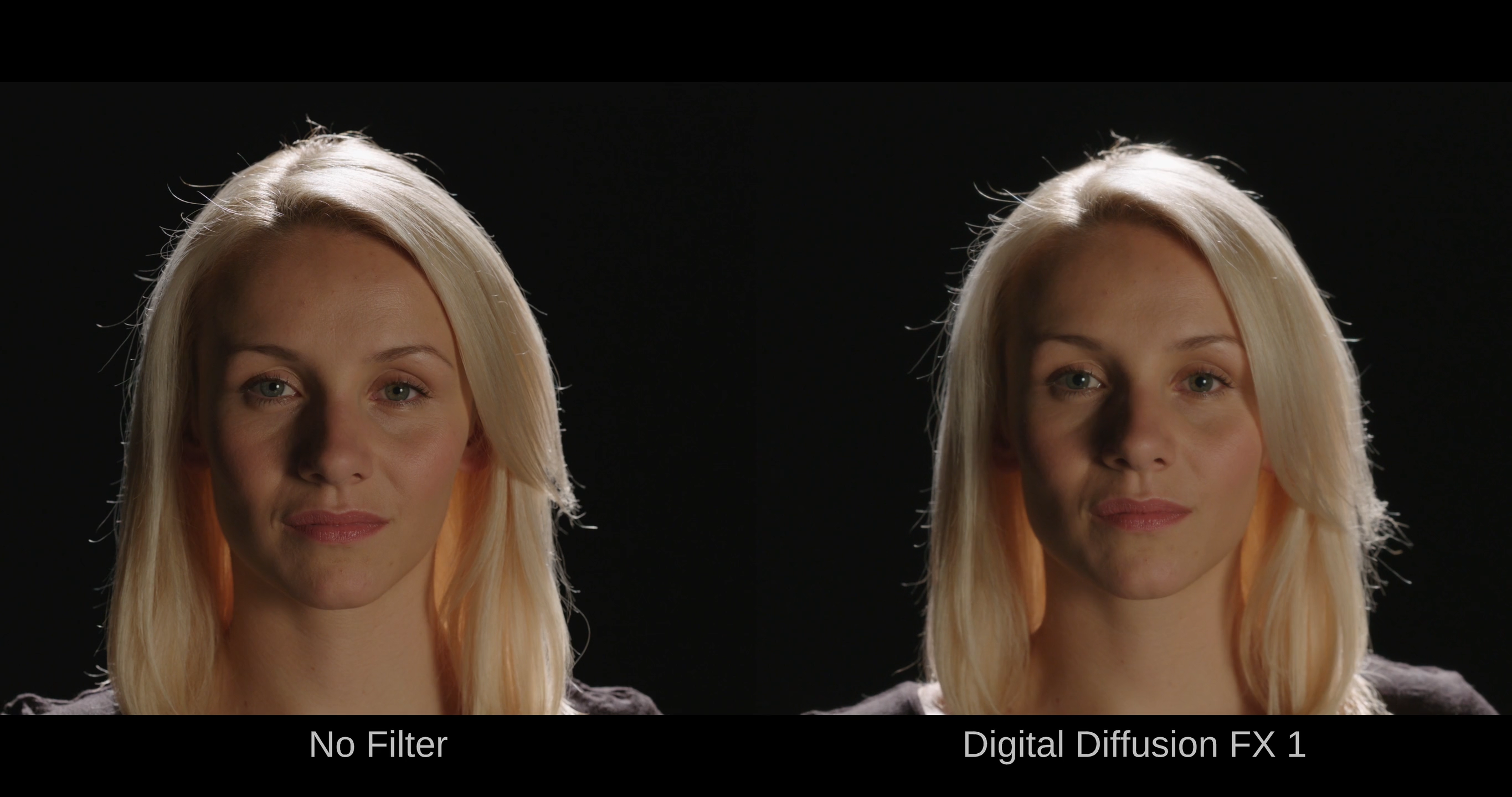

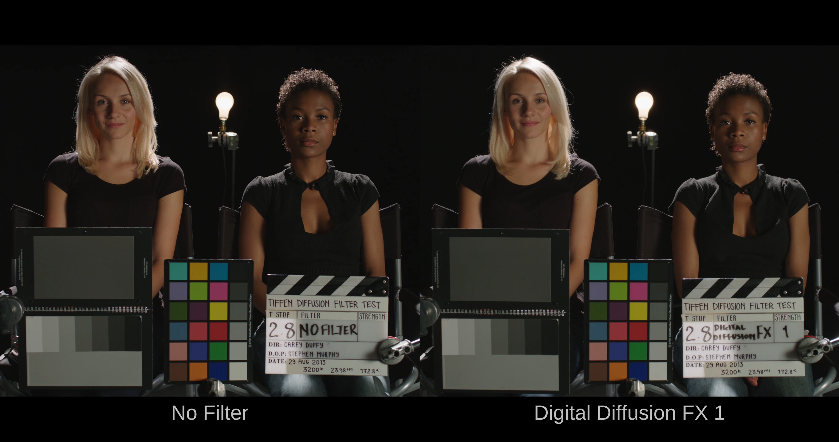

katlis Posted February 12, 2019 Share Posted February 12, 2019 46 minutes ago, RCV said: Great work as usual, I love all your ghalex vids. Was wondering what the DD1 filter is and what it does? Thanks! Alex makes it easy! And his latest tip came from the GH5 Facebook group. Tiffen of course makes a bunch of filters, the pro mist filters probably being their most popular. But they also have a “Digital Diffusion” filter that comes in different densities. It softens fine texture without overly blooming light (halation). Alex suggested trying the Digital Diffusion in the 1 density. It’s subtle, but sort of emulates that olpf look. I’m sure he can explain more, but have a look at this video: https://vimeo.com/162597544/description Link to comment Share on other sites More sharing options...
RCV Posted February 12, 2019 Share Posted February 12, 2019 33 minutes ago, katlis said: Thanks! Alex makes it easy! And his latest tip came from the GH5 Facebook group. Tiffen of course makes a bunch of filters, the pro mist filters probably being their most popular. But they also have a “Digital Diffusion” filter that comes in different densities. It softens fine texture without overly blooming light (halation). Alex suggested trying the Digital Diffusion in the 1 density. It’s subtle, but sort of emulates that olpf look. I’m sure he can explain more, but have a look at this video: https://vimeo.com/162597544/description Nice! thanks for the suggestion! I just started using schneider's radiant soft and it does wonders...Im going to check out this digital diffusion filter Link to comment Share on other sites More sharing options...
Sage Posted February 12, 2019 Author Share Posted February 12, 2019 46 minutes ago, RCV said: Nice! thanks for the suggestion! I just started using schneider's radiant soft and it does wonders...Im going to check out this digital diffusion filter About two months ago, I bought a bunch of filters to see if I could match the Olpf optically. I haven't had a chance to do a proper write up, but updated the Pdf - the closest one was Tiffen's Digital Diffusion 1. I had always thought Low Contrast 1/2 would be the match because of Jim Jannard's note about matching the Red to Alexa many years ago, but it wasn't even close (too strong). That said, LC did improve the falloff, to smooth out the stair stepped nature of the GH5's falloff, which was Alexa-like. The optimal stack I settled on was: Lens > Firecrest ND (Cancels out inverse sensor reflections) > Tiffen Low Contrast 1/8 > Tiffen Digital Diffusion 1 That said, I use 1/4, which gives a nice distinct diffusion and smooth falloff, but is decidedly stronger than the Alexa (lowering the contrast as well). LC 1/4 + DD1: This original Gunleik Groven test had also convinced me that Low Con 1/2 would be the ticket: Red 1MX Alexa And DD1 examples, from Tiffen: ChristianH 1 Link to comment Share on other sites More sharing options...
RCV Posted February 12, 2019 Share Posted February 12, 2019 3 minutes ago, Sage said: About two months ago, I bought a bunch of filters to see if I could match the Olpf optically. I haven't had a chance to do a proper write up, but updated the Pdf - the closest one was Tiffen's Digital Diffusion 1. I had always thought Low Contrast 1/2 would be the match because of Jim Jannard's note about matching the Red to Alexa many years ago, but it wasn't even close (too strong). That said, LC did improve the falloff, to smooth out the stair stepped nature of the GH5's falloff, which was Alexa-like. The optimal stack I settled on was: Lens > Firecrest ND (Cancels out inverse sensor reflections) > Tiffen Low Contrast 1/8 > Tiffen Digital Diffusion 1 That said, I use 1/4, which gives a nice distinct diffusion and smooth falloff, but is decidedly stronger than the Alexa (lowering the contrast as well). LC 1/4 + DD1: This original Gunleik Groven test had also convinced me that Low Con 1/2 would be the ticket: Red 1MX Alexa And DD1 examples, from Tiffen: wow! thats some gems in there! Great information. thanks. So Im assuming you mostly use that combo when shooting the gh5? Link to comment Share on other sites More sharing options...
Sage Posted February 12, 2019 Author Share Posted February 12, 2019 Just now, RCV said: wow! thats some gems in there! Great information. thanks. So Im assuming you mostly use that combo when shooting the gh5? I've been using it for the first time on a shoot recently (first time filming anything since my research splurge in Nov). I definitely always want to use DD1, no matter what. I may experiment with other diffusion in combination, for artistic falloff (though the GH5 will never be an exact match for AA halation). Jan Sandvik, a GHa fan, posted an interesting diffusion example using black tulle in front of the lens, which I thought was quite filmy: Link to comment Share on other sites More sharing options...
RCV Posted February 12, 2019 Share Posted February 12, 2019 14 minutes ago, Sage said: I've been using it for the first time on a shoot recently (first time filming anything since my research splurge in Nov). I definitely always want to use DD1, no matter what. I may experiment with other diffusion in combination, for artistic falloff (though the GH5 will never be an exact match for AA halation). Jan Sandvik, a GHa fan, posted an interesting diffusion example using black tulle in front of the lens, which I thought was quite filmy: Fantastic! Read about downscaling 4k to 2k as Jan Sandvik posted. great technique, and upscaling from 2up back to 4 K for that reduced digital edge Link to comment Share on other sites More sharing options...
Sage Posted February 12, 2019 Author Share Posted February 12, 2019 Just now, RCV said: Fantastic! Read about downscaling 4k to 2k as Jan Sandvik posted. great technique, and upscaling from 2up back to 4 K for that reduced digital edge In my case, I shoot to 2K All-I, and use the digital Olpf settings, to make the resolution organic (and upscale as needed). Paired with the DD1, I find I only need the lighter olpf settings (5.2/20) to counter sharpening, and the DD1 takes over texture from there for a solid match. The full 6/20 is too much with the DD1 (beyond a match) Link to comment Share on other sites More sharing options...
