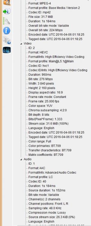

Pavel Mašek Posted April 6, 2016 Share Posted April 6, 2016 I have tried 320 / 250 /200 Mbits with fastest possible card (Lexar 2000x) and it records just few seconds and then it crash with quick "slow card" message (clip with 200Mbits was longer then with 320 Mbits). So it seems that 160 Mbits is only one stable bitrate for now. I would like to do more tests but do not have time for it. However - still GREAT achievement Vasile, thank you so much. Link to comment Share on other sites More sharing options...
vasile Posted April 6, 2016 Share Posted April 6, 2016 21 minutes ago, Pavel Mašek said: I have tried 320 / 250 /200 Mbits with fastest possible card (Lexar 2000x) and it records just few seconds and then it crash with quick "slow card" message (clip with 200Mbits was longer then with 320 Mbits). So it seems that 160 Mbits is only one stable bitrate for now. I would like to do more tests but do not have time for it. However - still GREAT achievement Vasile, thank you so much. I think someone needs to do some more in-depth tests. I do not know how the codec works but based on previous analyses (seen in this thread) of my fish tank video, the codec uses a variable rate. This is supported by @SMGJohn codec info screenshots. What this means is that the 160Mbit is not really the true rate, it is merely the target average rate for the codec, and that, based on the complexity of each frame, the codec will use less or more bits to encode it. It is likely that the codec uses something like this: target rate => [min_rate .. max_rate] where min_rate and max_rate are fixed multiples of target rate. For example (and this uses numbers coming from my hat): 160Mbit/s rate == in reality [0.5x160 .. 2x160] == [80 .. 320] Mbit/sec. This could be easily be proved with your Lexar card by recording a static scene vs a dynamic scene - the static scene should allow higher bitrates (presumably because it would hover near the lower limit) before the crash. Pavel Mašek 1 Link to comment Share on other sites More sharing options...
Pavel Mašek Posted April 6, 2016 Share Posted April 6, 2016 59 minutes ago, vasile said: I think someone needs to do some more in-depth tests. I do not know how the codec works but based on previous analyses (seen in this thread) of my fish tank video, the codec uses a variable rate. This is supported by @SMGJohn codec info screenshots. What this means is that the 160Mbit is not really the true rate, it is merely the target average rate for the codec, and that, based on the complexity of each frame, the codec will use less or more bits to encode it. It is likely that the codec uses something like this: target rate => [min_rate .. max_rate] where min_rate and max_rate are fixed multiples of target rate. For example (and this uses numbers coming from my hat): 160Mbit/s rate == in reality [0.5x160 .. 2x160] == [80 .. 320] Mbit/sec. This could be easily be proved with your Lexar card by recording a static scene vs a dynamic scene - the static scene should allow higher bitrates (presumably because it would hover near the lower limit) before the crash. Yes, that makes sense, that peak of bitrate can be very high. However after quick check I have not seen so big variation in few seconds of 250Mbits footage (but it is too short for proper analysis). Strange is that write speed of the card is still much higher than can achieve peak of bitrate - maybe there is not enough RAM in camera (according Tommix) Link to comment Share on other sites More sharing options...

Chant Posted April 6, 2016 Share Posted April 6, 2016 For the NX1 I have done a stablity test going from 320mbs down and the 200mbs worked best on a 3 year old 32gb class 10 Sandisk extreme pro uhs 1 card. If you use constant focus it crashes the card 1/5 times, switching to manual focus and back to constant seems to work. Its a good leap on the scripting side of things! Try running the camera in manual mode and ois/dis off. Pavel Mašek, Geoff CB, Marco Tecno and 1 other 4 Link to comment Share on other sites More sharing options...
Pavel Mašek Posted April 6, 2016 Share Posted April 6, 2016 7 minutes ago, Chant said: For the NX1 I have done a stablity test going from 320mbs down and the 200mbs worked best on a 3 year old 32gb class 10 Sandisk extreme pro uhs 1 card. If you use constant focus it crashes the card 1/5 times, switching to manual focus and back to constant seems to work. Its a good leap on the scripting side of things! Try running the camera in manual mode and ois/dis off. So it seems that limit is camera's computing power and not card speed. Will try it. Link to comment Share on other sites More sharing options...
Chant Posted April 6, 2016 Share Posted April 6, 2016 Just now, Pavel Mašek said: So it seems that limit is camera's computing power and not card speed. Will try it. Well for how the dis works it could be using up ram that could be allocated for buffer to write. But more testing is needed for sure Link to comment Share on other sites More sharing options...

ReinisK Posted April 6, 2016 Share Posted April 6, 2016 Did a test with 300mb\s in UHD 25p and FHD 100p. The fasted card I have is a Samsung Pro 16gb, which has 50MB\s write speed. It always stopped after a few seconds. When I put the files in Premiere Pro, it showed weird frame rates. 25fps was in some files 24,77 or something close and 100p was something around 80fps. When the bitrate wasn't hacked, it always showed exact fps, no matter how short the clip was. Another thing - when I brought up the very deep shadows in Premiere. it could very well be seen, that in the beginning of the clip, those shadows consist of huge macroblocks. But when time goes on, those macroblocks get smaller and smaller, until the video stops. It seems that these hacked bitrates need more time to start, and in the beginning the bitrate is somewhat low. Pavel Mašek 1 Link to comment Share on other sites More sharing options...

hirsti Posted April 6, 2016 Share Posted April 6, 2016 I have 2 SD cards that I have tested on, a Sandisk 280 MB/s and a Lexar 2000x 300 MB/s On the sandisk it is reliable setting the bitrate @ 160 MB/s, if you step up to 200 it will fail after about 10 seconds. On the Lexar it is reliable setting the bitrate @ 200 MB/s, if you step above this then it fails. Pavel Mašek 1 Link to comment Share on other sites More sharing options...
Pavel Mašek Posted April 6, 2016 Share Posted April 6, 2016 3 minutes ago, hirsti said: I have 2 SD cards that I have tested on, a Sandisk 280 MB/s and a Lexar 2000x 300 MB/s On the sandisk it is reliable setting the bitrate @ 160 MB/s, if you step up to 200 it will fail after about 10 seconds. On the Lexar it is reliable setting the bitrate @ 200 MB/s, if you step above this then it fails. Interesting - have you tried it with AF/MF, focus peaking ON/OFF, non/native NX lens? Maybe these settings can affect that. I will check it later today too.. My Lexar UHSII crashes after 4 seconds with 200 Mbits (4k30p, AF ON, Samsung 45mm) Link to comment Share on other sites More sharing options...
ReinisK Posted April 6, 2016 Share Posted April 6, 2016 Hirsti, you mean 160 and 200 megabits, right, no megabytes? My Samsung 50MB/s card at 200Mb/s goes on for about 40 seconds to 1 minute. With dis it ended after 5 seconds once, but usually no less than 30sec. UHD 25p that is. Link to comment Share on other sites More sharing options...
