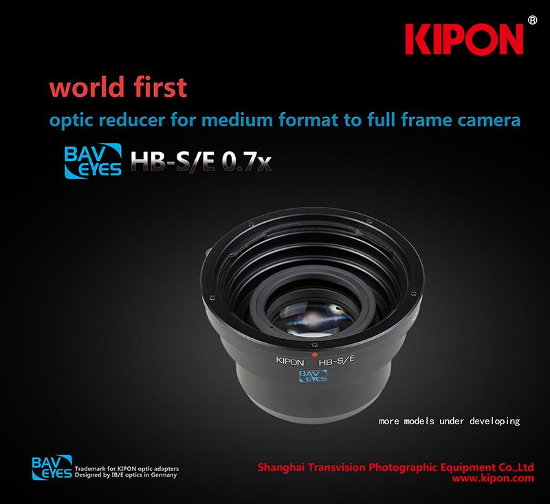

Kipon / Baveyes medium format speed booster for full frame Sony A7 series
Interesting. I know they do a 0.7x PL too ( http://world.tmall.com/item/521200581514.htm ).
Two months back ( http://www.43rumors.com/kipon-announces-the-baveyes-ef-and-m42-speed-booster-adapters/ ) I saw they even had a M42 to M43 0.7x ( http://world.tmall.com/item/521181289088.htm | http://global.rakuten.com/en/store/auc-stkb/item/baveyes-m42-m43/ ), which spiked my interest. Not sure if their line-up of focal reducers is any reputable, though, or how they compare with the others. They're up in price from the 'Lens Turbo' ones.

They have the extra first concave element ,like the spees boosters but still less elements than these, the optics also have a larger diameter. It wouldn't surprise me if they are all the same, and that the hasselblad speedbooster is the same as the nikon to e mount and that the housing is just different. We will see.

For what I know, sensor size different ''looks'' come from field of view and depth of field.
We've reached the conclusion some time ago that you can get the same FF look with a s35 camera by using a faster lens to match DOF and wider lens to match FOV. Then the aesthetic and image are identical. BUT , the point is, you DO need a faster lens, which means vastly lower quality wide open to match DOF of FF and vastly more expensive glass overall while with FF you can achieve that shallow DOF and FOV with an endless cheap slower lenses available that are much higher quality at f/2.8 vs s35 lens at f/1.2.
The same goes with medium format.
With a Canon/Nikon 50mm F/1.2 you get the same look as a MF 100mm f/2.8 or so, but the point is that the medium format glass at f/2.8 is much sharper with higher contrast than the hazy and expensive FF f/1.2 lenses.
The medium format look will be achieved with this speedbooster if it doesn't affect IQ, and that an incredibly exciting invention we've been waiting for since Sony started making FF mirrorless cameras with sensor qualities equal and higher than MF ones (48mp, 12bit raw uncompressed tonality, incredibly high dynamic range, exceptional lowlight performance, etc - that's my response for those who will come out and say MF aesthetic is about resolution, DR, tonality, sorry but FF sensors reached that and exceeded while your MF sensor technology is a bit stagnant) and the only missing piece to match MF was the lenses. With a SB, we complete the equation and effectively shoot medium format using a small A7R/II + Focal reducer + one of thr many MF High percision lenses.
I don't know this company so I doubt the results as any decrease in IQ will eliminate the MF lens ''aesthetic'' advantage alltogether.
 I was expecting @Brian Caldwell to make this piece, he has the idea, and Metabones SBs offer unparalleled optical performance. I hope he/they make one with as high quality optics as the SB Ultras in terms of glass-induced image loss.

This is exciting.  I highly doubt this unit will have optics of quality good enough to make investment in decent medium format glass worthwhile.  ie, even my Hasselblad 40mm/4, 50mm/2.8, 80mm/2.8 110mm/2 and 150mm/2.8 and this adaptor will only result in a set of lenses equating to:- 28/2.8, 35/2, 56/2, 77/1.4, 105/2.
This will be a formidable set no doubt, but at around £3000 for the hassy lenses (at current ebay prices) and probably £500 for the adaptor, as well as each of the hassy lenses being upwards of 1kg each! the excitement is damped since for £3500 you can get an incredible set of 35mm format lenses that will likely match the look, with moderately better image quality.
Now, if metabones are watching and create something like this but with optics at the level of the SB ultra, then the hassle will be worth it (for resolution).  Unfortunately there aint enough fast (f2.8 or faster) medium format lenses like the shutterless hasselblad lenses to make the act of developing a truly superb focal reducer worthwhile in marketing terms.
That said, I'll definitely be getting one of these.  my hassy's will deliver pretty good resolution and squeezing the lp/mm tighter with this (providing optical performance is good) will make the 110/2 a badboy!

I think you may be right.  Contax 645 lenses will definitely yield more of a benefit from this than 6x6 hassy's.  Been examining that photo of the unit and the optical element doesnt look big enough to trasmit what would be required from the 110mm/2.   The 645 80/2 might be a little beaut on this, but still...  for the price of this adaptor and the contax 80/2 you could get a sigma 50mm/art and get the same look and obliterate the resolution.
If metabones made a 0.55x unit for 6x6 lenses with 80mm+ image circles with sb ultra performance and apo correction for the hassy F lenses on digital sensors then we'd be cooking!  the 50mm/2.8 would result in a 28mm/1.6 with great mtf.  the blad 50mm at 2.8 on full frame almost matches the c/y 50/1.4 at f2.8 when compared for resolution on a7rii.  compressing the resolution by almost twice would be amazing in resolution terms.
