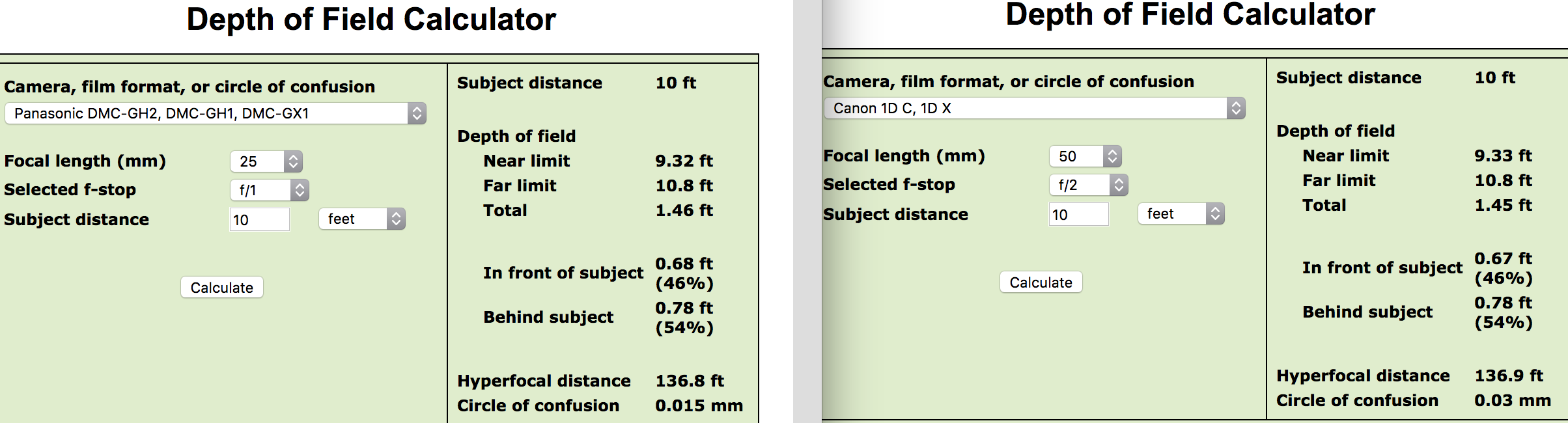

Yes, but if you use the "equivalent" aperture, then there are no differences in DoF.
Here is an example from dofmaster:
Quote
Comparing the 35mm on FF  side by side to the 17mm MFT there is another difference though. Background compression. It has changed because they are different focal lengts. A 17mm and a 35mm. So the "equivalent" wasnt 100% equivalent after all.
As stated and shown multiple times in various threads, compression depends only on the distance from the subject, nothing to do with the focal length or the sensor size.
The only differences that might arise is just because of the lens differences in quality.
For example, wider lenses are more prone to distortion artifacts so to keep the same field of view at the same distance with minimal distortion (typical senario in portait/landscape photography, it would be easier to do so with a larger sensor/film and a longer focal length. That is one of the reasons larger sensor cameras were preferred for this type of photography, the other being quality based on just the sheer area of the film used.
Another example is the resolution of the lenses which affects the quality depending on the circle of confusion. So it is easier to create lenses for larger sensors that have larger circle of confusion.
Now, many things have changed since then. Quality of lenses has vastly increased and especially for FF sensors there are very very good choices for relatively low price. Also distortion is very well controlled, and most of them give excellent quality even at larger apertures. And that is exactly the problem that this adaptor faces. Getting a MF lens that can offer similar quality to the current FF offerings for even the same price is very very hard. So unless someone has many good MF lenses lying around, this adapter makes little sense.
So in the end the reason that small sensors cannot have the look of larger format sensors is
a) As stated before its very very hard to design very sharp lenses with equivalent to larger sensor (very very small) focal lengths at equivalent (very very large) apertures with minimal distortion.
b) The image quality still depends on the sensor size, so even though FF sensors have come pretty close to MF sensors, the sensor area difference between FF and 1" sensors, and thus quality is HUGE. That also provides little incentive for companies to overcome point a).

4 hours ago, Don Kotlos said:
I feel you are the only one that brings this false belief no matter how many times it gets explained (here, here, here).
First you say its false and then you agree with me.... and no Im not the one who brought it up.
You also say, "Yes, but if you use the "equivalent" aperture, then there are no differences in DoF."
My point exactly, you change the exposure. Not equivalent at all. For me its important to expose properly.
"As stated and shown multiple times in various threads, compression depends only on the distance from the subject, nothing to do with the focal length or the sensor size. "
My point exactly.
Link to post
Ok then I guess we can agree that once an equivalent focal length and aperture is used, the famous MF "look" comes down to just a difference in exposure which can be adjusted with either the shutter speed, ISO or an ND.
My point exactly
Then you must excuse my response which was based on this sentence:
On 1/28/2017 at 9:56 AM, Mattias Burling said:
If you change lens to get more SDOF youve done just that. Changed lens. Which means a different background compression.
Link to post
