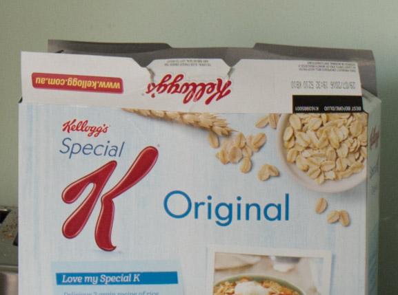

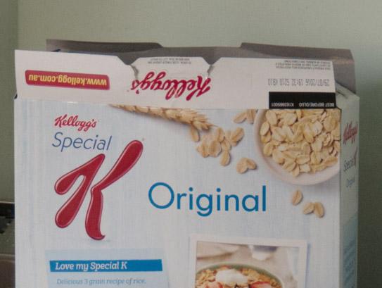

Triumph61 Posted October 22, 2015 Author Share Posted October 22, 2015 Your 24-70 lens WILL NOT match the resolving capabilities of the samsung lens. It just won't. The 24-70 will have been designed with an approximate 30lp/mm onto a full frame sensor. I'm pretty certain that if you;d used the 55mm/1.8 on the a7r2 the results would be closer. OK richg101 Sorry but I disagree and so does the real life output. I have taken two shots attached here at 100% crops. They were taken on the Samsung at 24mm and the Canon on the A7RII in APSC mode at 24mm. Both shot in RAW and imported into Lightroom with sharpening turned completely off on both. Exported both to 4K resolution to be fair as the Samsung is slightly higher res and to emulate what happens when each frame of Video is created. Then I have cropped in at 100% on where I focused and here are the results. The Samsung benefits very slightly from a higher starting res at this pixel level magnification of very fine detail, but the difference is very small, hardly any difference and CERTAINLY not what is show when the same test was run as Video output rather than Raw stills. So the Variable here is ............Video output versus Still capture and I am sorry but by far the largest loss of res is NOT the lens but it is lost in the conversion in camera to Video. By the way, hardly fair to have a 16-50 F2 zoom compared with a 55mm 1.8 prime? But as you can see here that would not be the difference in a shoot out with these two camera's when Video is chosen. :-) Sony is the first image and Samsung the second image. Happy to post edge resolution but its still shows the same result. To be honest I probably could have shot the Samsung in Video and taken a similar grab for a similar effect, the Samsung seems to be able to create 25 frames at it actual still resolution in a fairly lossless way when resolution is considered. Still grabs from Samsung footage look like still shot images. Not so for the Sony. Link to comment Share on other sites More sharing options...
Triumph61 Posted October 22, 2015 Author Share Posted October 22, 2015 The A7rII is softer in FF vs S35, that's well known. If you're comparing them, using FF serves no purpose other than to make the A7rII look worse than it really is. I only use it when I don't need the extra detail like interviews. While S35 may not be as sharp as the NX1, it definitely has more DR, the highlights are far less brittle and the A7rII is cleaner at 3200 and above. This goes for stills as well. I sold my NX1 almost immediately after the A7rII was released, so any improvements since then are excluded from my opinions. The NX1 had a few quirks that drove me nuts, mainly the complete lack of back button AF - since I remove focus from the shutter button on every other camera I've owned, and Samsung only has a few lenses that are MF friendly. The EVF is far better on the A7rII as well.After seeing the performance of the A7rII with adapted lenses I decided my NX1 was on borrowed time. No electronic adapters and no speedboosters means there's a lot of great glass that's tough to adapt on the NX1. The fact that its been a year since Samsung introduced its last NX lens makes me feel it was a good decision to move to Sony.There's plenty of detail in A7rII S35 4k for me, it really pops on my 4k panel after sharpening and bumping contrast a bit.Hi Chris, I disagree re FF comparison, it does serve a purpose, many here may want to see what the real difference is, It's one thing to read that it's not as good and a bit "soft" in FF but for some, this will be a better illustration. Two of my images were S35 so I showed both FF and S35 and i did qualify that one of my main attractions was FF video and stills. The other things like back focus button and adapted lenses are fair enough, but to me, seem far more relevant for a still shooter than video. I have found adapted lenses on the Sony to be fairly flaky with Metabones 4 and latest firmware. It's great you can do it, but far from a great experience. If I had seen a comparison like this before I bought, considering that FF was one of my criteria, I may have purchased differently. TOOOO many talking heads on so called "reviews " online without real life data, to show what a bit softer actually means. IMHO Personally I was a bit shocked when i started looking at the 4K output from the A7RII, but I have gone from 5DMKIII magic lantern raw to NX1 and now Sony A7RII and the output from the Sony surprised me after the other two especially with regards the discarded detail as shown in the images at the start of my post. People have said they have shot footage on the Sony in FF and S35 and edited it with no real discernible difference in the final cut between them, I think my images show that is far from correct. FF is mush not just a "bit softer" I will do some more tests and maybe I can live with it, but so far I am unconvinced. If ONLY Sony hadn't left Phase detect AF from the A7SII, it could have been my potential Still/Video shooter :-( Link to comment Share on other sites More sharing options...
richg101 Posted October 22, 2015 Share Posted October 22, 2015 OK richg101 Sorry but I disagree and so does the real life output. I have taken two shots attached here at 100% crops. They were taken on the Samsung at 24mm and the Canon on the A7RII in APSC mode at 24mm. Both shot in RAW and imported into Lightroom with sharpening turned completely off on both. Exported both to 4K resolution to be fair as the Samsung is slightly higher res and to emulate what happens when each frame of Video is created. Then I have cropped in at 100% on where I focused and here are the results. The Samsung benefits very slightly from a higher starting res at this pixel level magnification of very fine detail, but the difference is very small, hardly any difference and CERTAINLY not what is show when the same test was run as Video output rather than Raw stills. So the Variable here is ............Video output versus Still capture and I am sorry but by far the largest loss of res is NOT the lens but it is lost in the conversion in camera to Video. By the way, hardly fair to have a 16-50 F2 zoom compared with a 55mm 1.8 prime? But as you can see here that would not be the difference in a shoot out with these two camera's when Video is chosen. :-) Sony is the first image and Samsung the second image. Happy to post edge resolution but its still shows the same result. To be honest I probably could have shot the Samsung in Video and taken a similar grab for a similar effect, the Samsung seems to be able to create 25 frames at it actual still resolution in a fairly lossless way when resolution is considered. Still grabs from Samsung footage look like still shot images. Not so for the Sony.even the thumbnails here show a drastic difference in resolution. the top image is smeared (take the sell by date numbering as a reference. blow those two images up 2x and the difference is even more obvious. Link to comment Share on other sites More sharing options...
Triumph61 Posted October 22, 2015 Author Share Posted October 22, 2015 even the thumbnails here show a drastic difference in resolution. the top image is smeared (take the sell by date numbering as a reference. blow those two images up 2x and the difference is even more obvious. Sorry disagree and certainly not what is being seen in the Video files as a Huge difference. There is a difference, but drastic? More res based than lens based I can read the same writing in each raw file. Drawing a long bow I think, I'll give you this 10% lens and 90% internal camera processing. If I had more time I could do the same test and flick them to video output to show you the lens is the insignificant factor here. Link to comment Share on other sites More sharing options...
