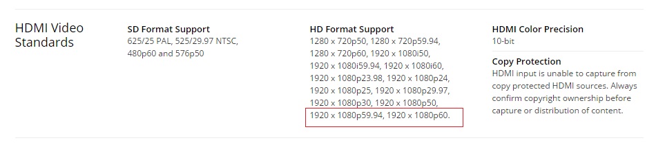

AaronChicago Posted October 1, 2015 Share Posted October 1, 2015 Hey Ebrahim are you sure it works at 60p with the C100? A couple of people at BMCuser were saying its only 60i. Link to comment Share on other sites More sharing options...
Guest Ebrahim Saadawi Posted October 1, 2015 Share Posted October 1, 2015 A note: I just discovered Atomos makes a Ninja 2 with the Superb  5'' IPS Calibrated monitor of the Samurai, it's called the Ninja Blade. Atomos slashed the price from 1100$ to VA 499$ price, with all the features needed (tough break for the VA). Again just not 60p and the micro SDIs. http://www.atomos.com/ninja-blade/This is definitely what I am getting now, the screen is fantastic (I used the samurai with the 1Dc) and it's one of the best 5'' panels out there with extremely accurate colours, plus has waveform/peaking/false colour/etc 495$ is insane. The ninja 2 is the same but 200$ less for the lower res, smaller LCD (great price at 295$ though, it's a perfectly usable panel)Do you know if the Ninja 2 can start/stop on the Nikon d5500?It should, it triggers my D5300 here, and probably all Nikon/Canon DSLRs. Just remember many Nikon DSLRs output only 30p unlike Canons. Annoying quirk. Make sure the D5500 outputs other frame rates (check the menus)Hey Ebrahim are you sure it works at 60p with the C100? A couple of people at BMCuser were saying its only 60i.Yes it does, not only 60i. The C100II outputs a native, normal 60p signal so that will work, however, when it comes to normal speed, the C100 signal is actually a bit unique, the camera only outputs a 1080p 50i stream which needs to be pulled down to 25p, there's no mention of this feature on the VA,the Ninja 2 is especially compatible with the C100 for that reason and for the integration of start/stop trigger, it's designed with collaboration with Canon for this specific camera. So I don't know if the VA will play nice with the normal speed PsF stream and whether it will trigger in the future. The BM Hypershuttle doesn't work well at all with the C100 signal and takes an extra post-production step for pull-down and needs to be pressed to record, the VA is probably the same since it's not a mentioned feature/spec. They'll never learn how to make and deliver reliably working products on time even after 4 years. Yes I am bashing them. Put shiny specs and remove essentials seems to be their motto since the first BMCC. Link to comment Share on other sites More sharing options...
