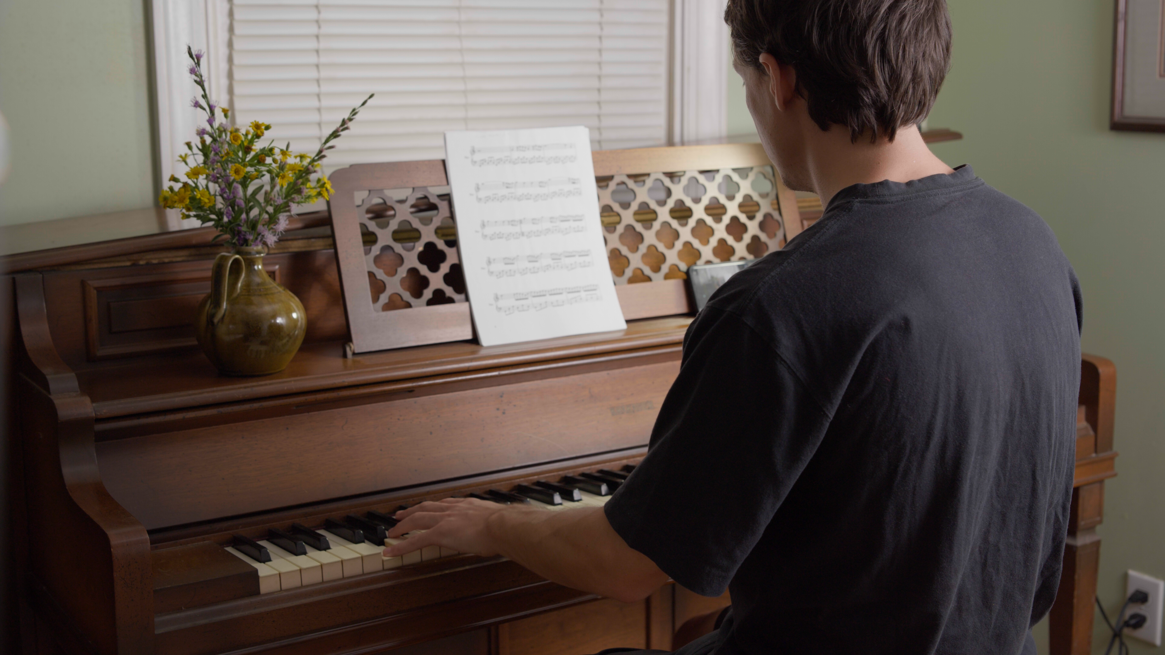

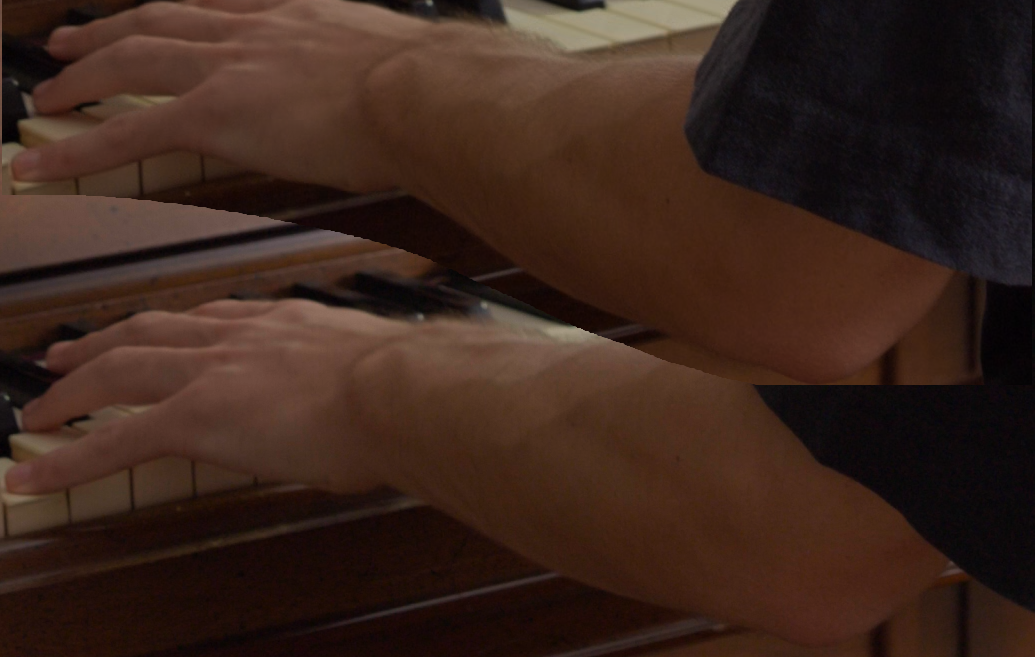

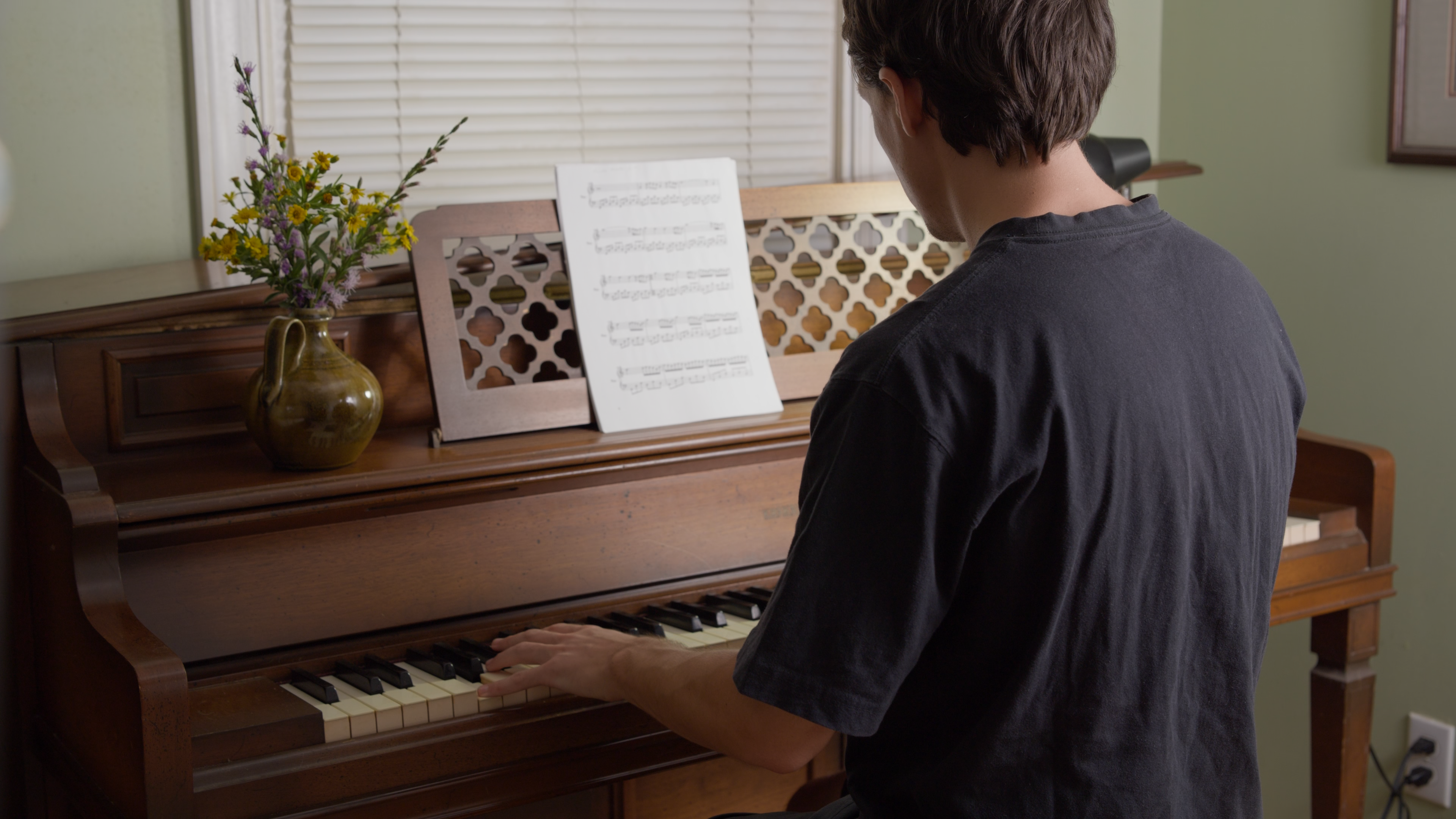

KnightsFan Posted October 7, 2024 Share Posted October 7, 2024 On the S5, the difference between 8 and 10 bit is very obvious. I shot a scene twice, once with 8 bit 100 Mbps (93 Mbps actual), and once with 10 bit 75 Mbps (66 Mbps actual). Both clips have a color space transformation to Rec709, but no other adjustments. The amount of color noise and weird color in 8 bit is very high, and is almost nonexistent in 10 bit. Viewed at 100% scale in motion in my normal viewing condition, it's apparent that "something is off" particularly in skin tones (I did tests facing the camera, too, which I'm not posting). To me, this is part of the "thick" color that people talk about: pure tones without posterized splotches of color noise, which gets worse with saturation. Now clearly this is something to do with the encoder, since the output images that I am posting here are both 8 bit PNGs. So I'm not going to make universal statements, but I will say that on every camera that I have ever used, I get nearly the same result. You can see the difference everywhere in the image, but particularly notice the evenness of the skin on my arm, the black on the t-shirt, the plain green wall, and the deepness of the brown on the wood on the darker parts of the piano. Is this enough of a difference for average audience members to notice, even subconsciously? Probably not. However, I do notice it consciously, and considering the 10 bit file looks better AND is 25% smaller file size, I would never choose 8 bit on this camera. Leon Postma 1 Link to comment Share on other sites More sharing options...
