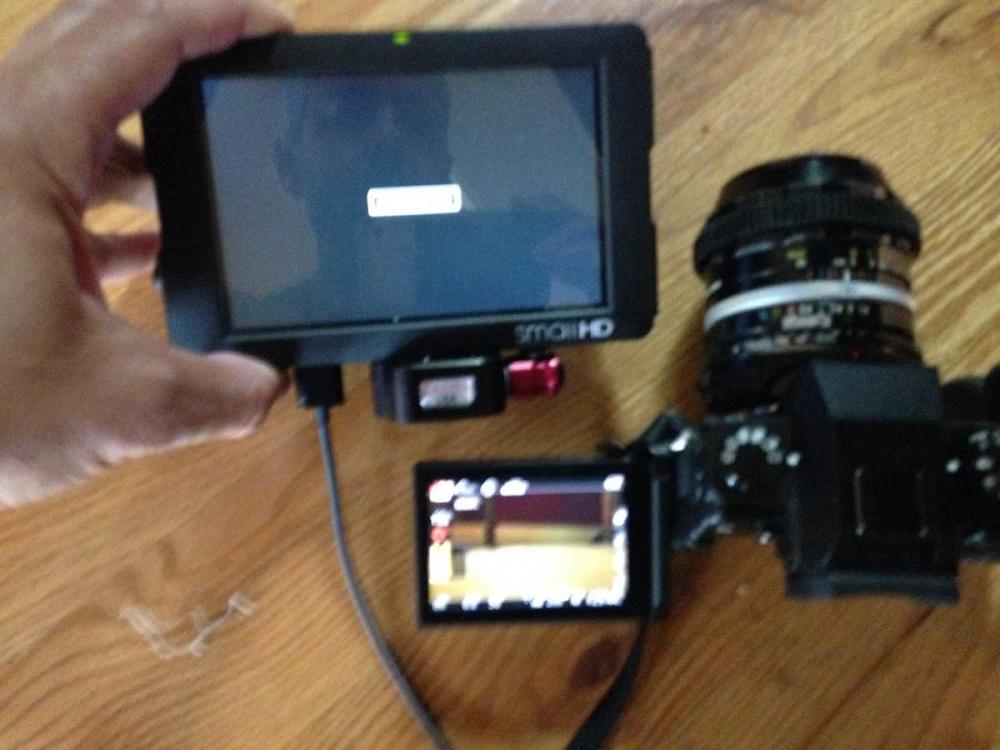

midloch Posted July 14, 2015 Share Posted July 14, 2015 There is one thing about my G6 that I dislike as there is NO live view HDMI while filming. Does the G7 has this feature? I want to get an external monitor but my G6 do not work :-( Link to comment Share on other sites More sharing options...
