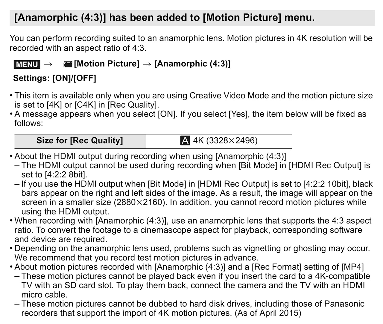

Administrators Andrew Reid Posted April 19, 2015 Administrators Share Posted April 19, 2015 Panasonic will release the new anamorphic firmware for the GH4 on Wednesday, April 22nd. With this update the Panasonic GH4 will have more vertical resolution than the Arri Alexa Studio for anamorphic.Read the full article Julian, Zak Forsman and Cinegain 3 Link to comment Share on other sites More sharing options...
Jimmy Goodwood Posted April 19, 2015 Share Posted April 19, 2015 "In addition, you can not record motion pictures while using the HDMI output" Does this mean no internal recording while monitoring through HDMI, or no recording of the 2880x2160 HDMI output?Kind of confusing. Link to comment Share on other sites More sharing options...
Nick Hughes Posted April 19, 2015 Share Posted April 19, 2015 Sounds like no internal recording. estarkey7 1 Link to comment Share on other sites More sharing options...
Zak Forsman Posted April 19, 2015 Share Posted April 19, 2015 You can record internally. In fact you get a larger 4:3 frame that way. 3328 x 2496. albeit, 8bit 420. I believe the reason why you can't monitor this over HDMI is because it needs to be embedded within an existing 4K frame that external devices can recognize and display (and record). If you set HDMI out to 10 bit 422, the 4:3 frame is reduced to 2880 x 2160 and embedded inside a 4K frame with black bars on the sides (pillar boxed). in this latter case, internal recording is disabled. I finish everything in 2K so that's still plenty for me. and the addition of 10bit 422 is welcomed. Link to comment Share on other sites More sharing options...

Liszon Posted April 19, 2015 Share Posted April 19, 2015 I thought the GH4 already outputs 10bit via HDMI. I remember Andrew saying he didn't find any major difference between the internally and externally recorded footage, now it makes sense why. Link to comment Share on other sites More sharing options...
Administrators Andrew Reid Posted April 19, 2015 Author Administrators Share Posted April 19, 2015 You can't record internally at same time as outputting 10bit over HDMI regardless of whether in anamorphic mode or not on the GH4. Link to comment Share on other sites More sharing options...

tidefilm Posted April 19, 2015 Share Posted April 19, 2015 regarding the 2.2 updateI don t get much of the sense of the 10 bit part,as I understand, the output via hdmi is bound to the hdmi specs, meaning 16:9 so there ll be black areas at the sides, in 16:9 with fixed height the 4:3 anamorph area would be 2880 x 2160. so its the same as before the update isnt it? Link to comment Share on other sites More sharing options...
Zak Forsman Posted April 19, 2015 Share Posted April 19, 2015 the update adds new frame rates. currently limited to 25fps and 30fps. will now have 24fps and 23.976fps. also HDMI is currently completely disabled. Link to comment Share on other sites More sharing options...
