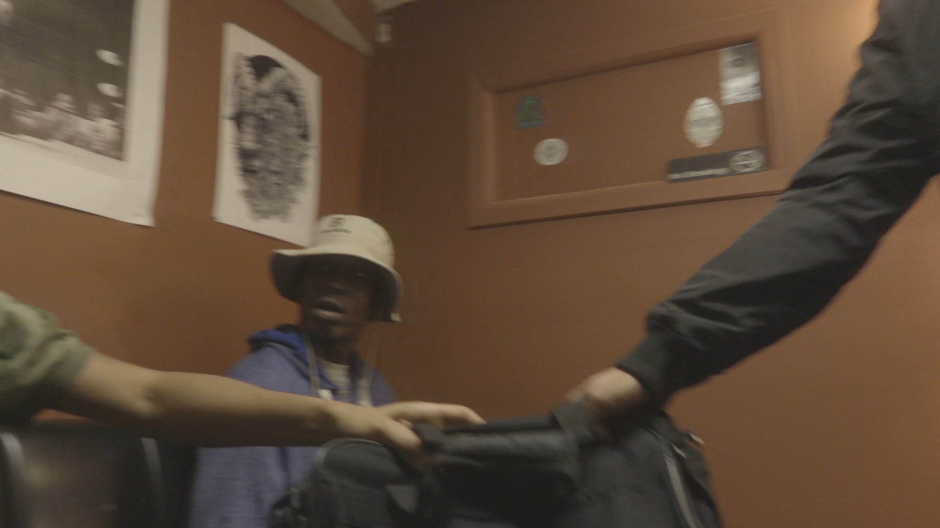

I've already contacted then and sent samples showing the ghosting. At first they said they weren't aware of the problem and then after seeing a couple examples said they would pass it along to the engineering program. That was a week ago so haven't heard anything back. I know they are well aware of the issue as well as the thread on this website. I don't have huge expectations I'd like to be able to confidently shoot people at 1600iso.
same. I shot this at 1000 iso and voila. Ghosting. Its not as noticeable shooting at 1/40 shutter speed because of the motion blur. I may even goo a little lower than that just to hide it. I rather have rollling shutter than this ridiculous afterimaging when panning with a camera designed to be hand held
- my emphasis. I agree 100% @kidzrevil. Also when shooting at ISO 1000 in a camera which Canon says offers..

I am giving the xc10 another shot today. Amazing camera but the in camera NR or whatever's going on Is causing after imaging from up to 3 frames prior. Idk whats going on but im at a total of 3 underwhelming shoots using this camera. The NX1 hasn't let me down yet & I am considering getting one with the 16-50mm S or a GH4 with OIS. Definitely no longer taking Mr.Reid's word for what makes a good camera.

Hmm...I wonder if it is not fully clearing the sensor pixels after each exposure, so partial data from the previous exposure is still there. Something like that would be a hardware problem.
