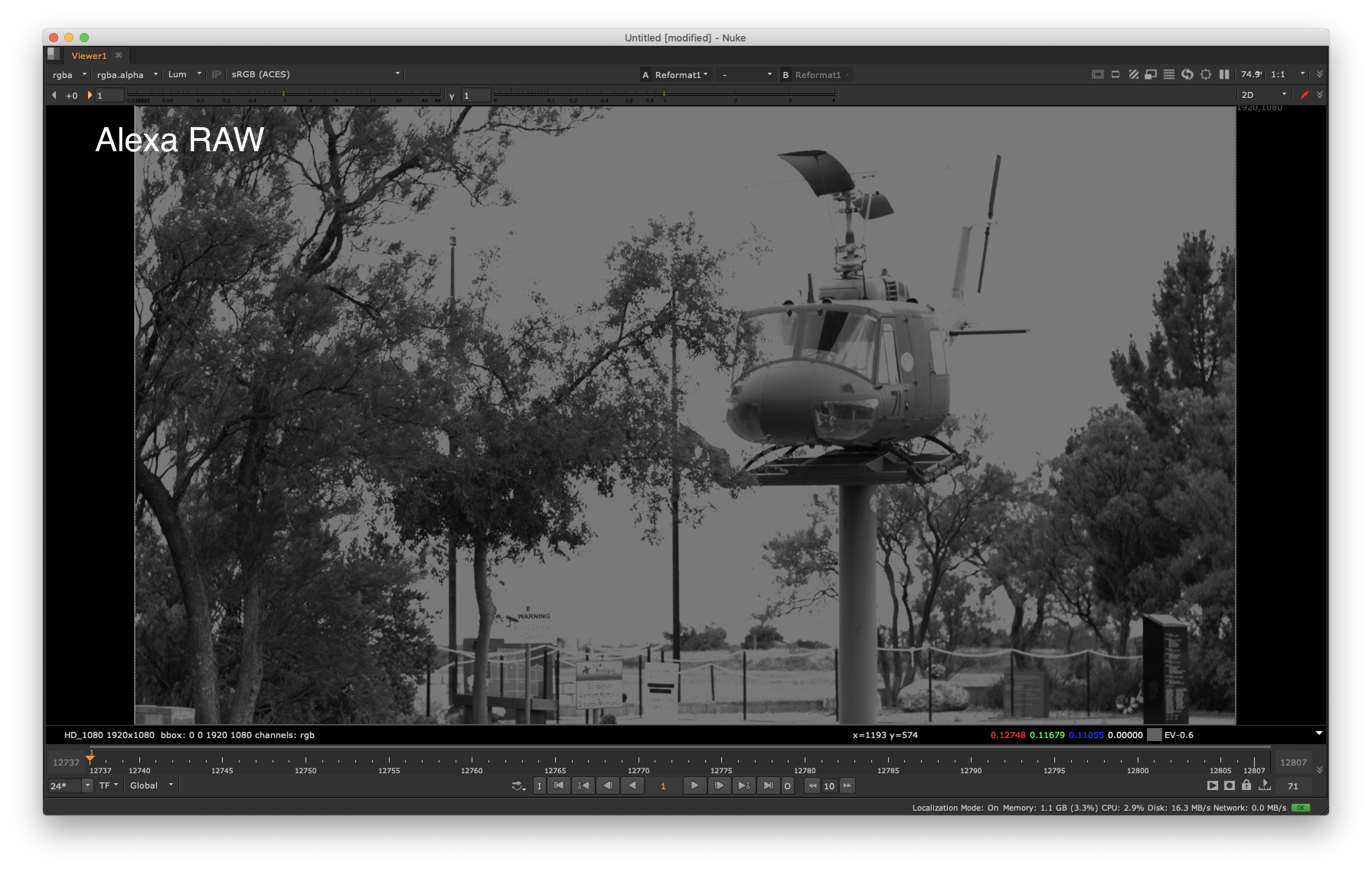

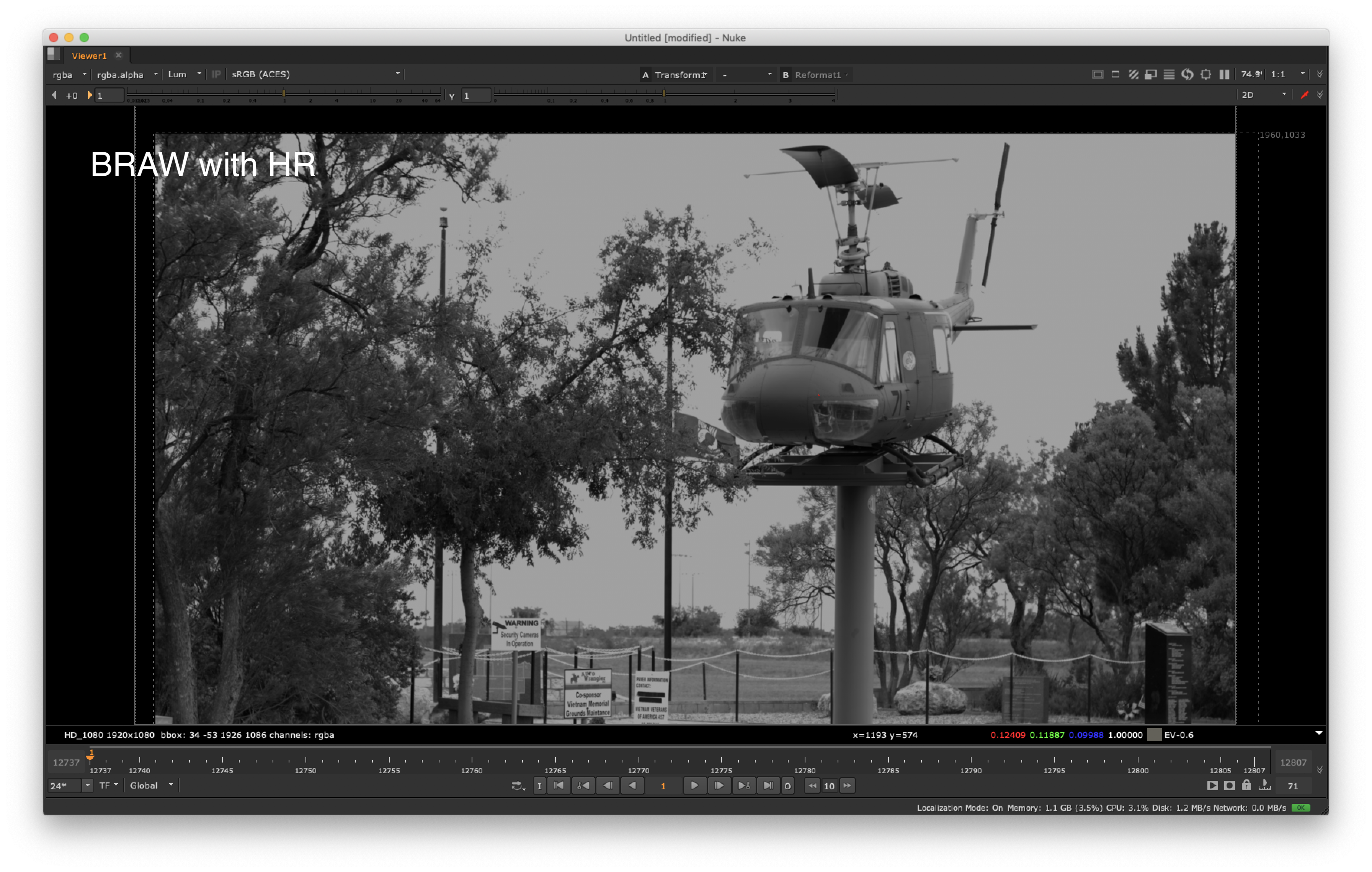

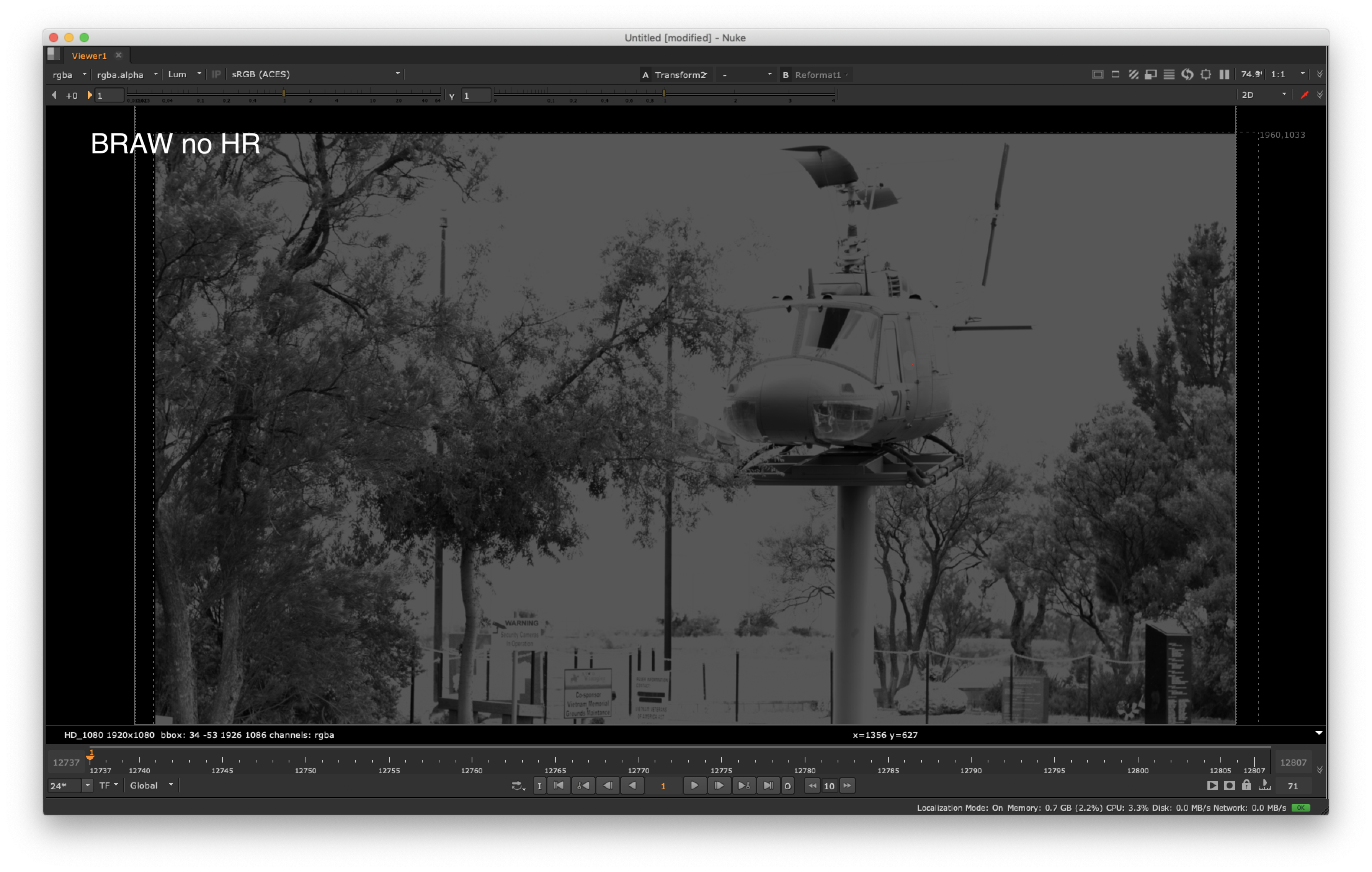

8 hours ago, HockeyFan12 said:
Thanks, I took a look at this and it was a fun test.
 Okay, I can see that with highlight recovery the Braw has some more detail in the window reflections than the Ari raw. But this was shot +7 stops overexposed, so at best it's only useful as an extreme latitude test where really you would expose correctly when filming and then if needed push it +/-2, maybe 3 stops at most. Both of the images are insanely clipped, there's no sky detail.
The issue with using highlight recovery is that it's extrapolating from data that's not really captured and making a best guess synthesis. Sometimes it works, sometimes it doesn't. But it's not a strategy for capturing more dynamic range, which is probably why it's disabled in Resolve by default - even for BM's own cameras. It's more of a neat party trick when combined with extreme overexposure like this.

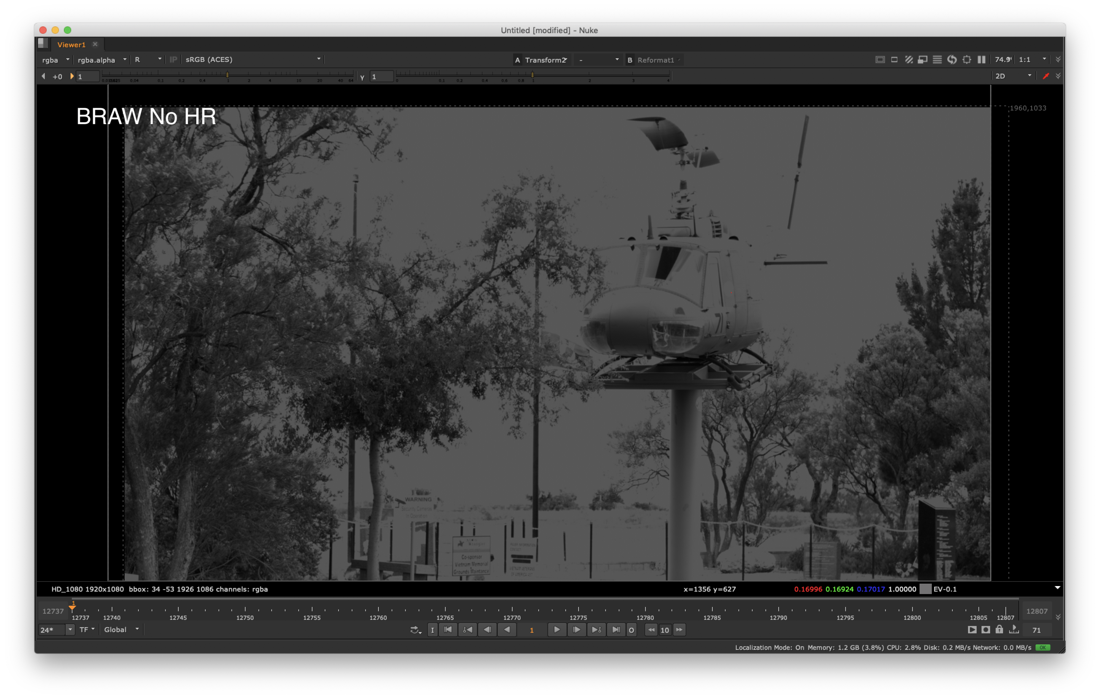

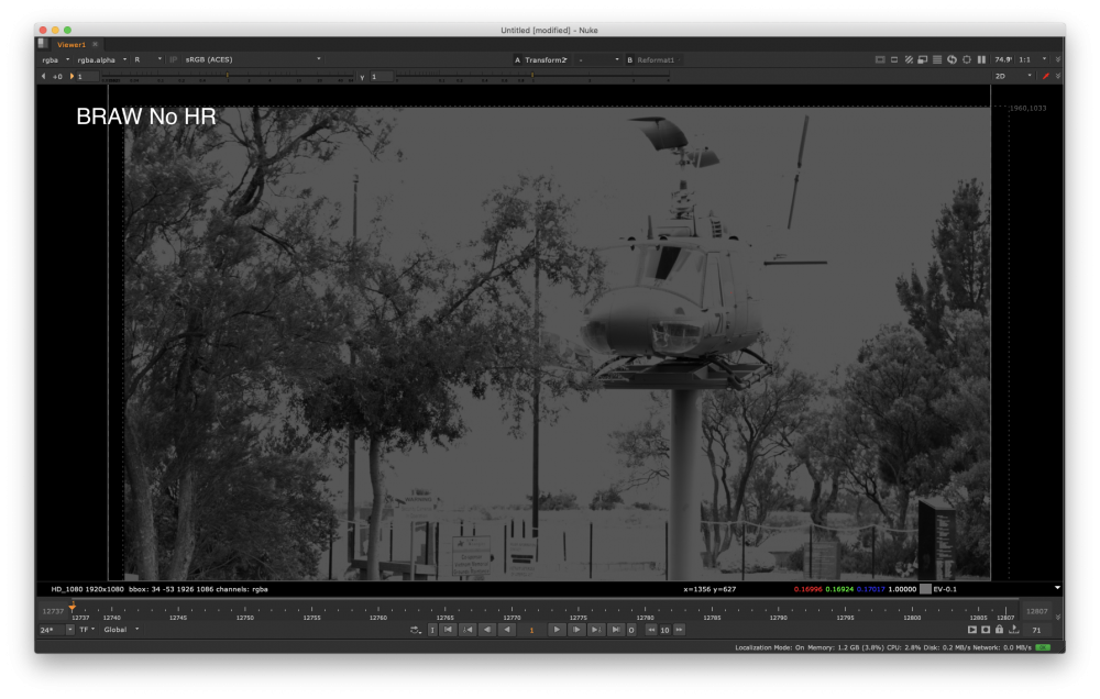

Screengrabs uploaded. The image with the most highlight detail is the Braw with highlight recovery. Without highlight recovery, it has 0.7 stops less in the highlights that the Alexa. If it was even remotely correctly exposed, the Alexa would be holding two stops more detail. Maybe 1.5 if factoring in successful highlight recovery on the Braw.
This guy's original comparison method in Resolve is not apples to apples in the way he's treating the footage differently. All I did was import the BRAW into Resolve and export it as a linear ACES EXR both with and without HR. So I'm using BM's own ACES color science for this camera. I then took them into Nuke where I had already imported the Arri Raw through ACES. So this ingest process provide a baseline consistency as far as scene referred light values captured by both cameras.  I then lowered the exposure on all three by -7 stops. As you can see from the screengrabs, that brings the exposure into line if you look at the trees and the helicopter as a stand-in for shooting a grey card. The sensor clipping point is the sky and the reflections, to varying degrees.
EDIIT: Forgot to mention these screengrabs are captured showing "luminance only" in Nuke, to emphasize the consistent exposure and the highlight differences in each image.
I wasn't able to edit this in time, but the "BRAW no HR" image was displaying the red channel, not luminance. So I'm uploading it again, showing luminance.
