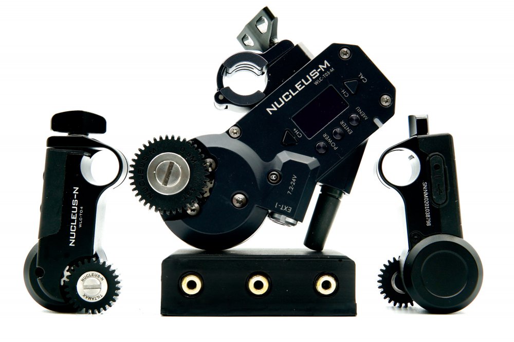

Super Members BTM_Pix Posted November 19, 2020 Author Super Members Share Posted November 19, 2020 35 minutes ago, shooter said: What's the difference between them, N and M models? Why three cables for M model? Don't I need any cable if I am using the Nano? Tilta Nucleus N is Nano, yes? N is the smaller (and cheaper) motor and can be powered by 5v but it has less torque, although that can be boosted using a larger power source. The three different cables for the M motor are 1) Data only for connection to the AFX. 2) Data connection to the AFX with USB outlet supplied from the M to power the AFX. 3) Data AND power connection to the MMX with USB outlet to power the AFX. So for the AFX, the choice is with or without USB dependent on what the user wants. Cable 3 is ONLY required for the FIRST port connected to the MMX (as it will be powering it) and any additonal M motors that are connected to the other ports can use either of the two other ones. No additonal cables are required for the Nucleus N motors as you are provided this with the AFX and an additional one if you buy the MMX. Yes, N is Nucleus Nano. shooter 1 Link to comment Share on other sites More sharing options...

Super Members BTM_Pix Posted November 19, 2020 Author Super Members Share Posted November 19, 2020 3 hours ago, Henchman said: But, would it be able in the future to use the motor of an autofocus in combination wiht a gear for the Anamorphic scope. Just an Idea. For Pocket4K/6K where we control the focus of the electronic lens then yes this would be a possibility. 1 hour ago, Caleb Genheimer said: Let me know if I understand this correctly: one cable is included with the AFX which can power it and connect data on an M Motor. therefore, to run a second M Motor via the MMX and to power it as well, only one cable 3 is needed? No, it is only the cable for the N motor that is included. Every M motor that you use whether it is directly connected to the AFX or connected to the MMX requires an adapter cable. We use the N port size as the "standard" to keep the footprint and cost down as the M port requires the much bigger and obviously far more expensive 7 pin connector. The N motor is also far more common than the M motor amongst our users. Therefore, every M motor used requires a cable to adapt to that "standard". So, for anyone just using an AFX and a single M motor, they need to buy either cable type 1 or cable type 2 depending on whether they want the USB outlet to power the AFX or if they are OK to just run it on its own internal battery. For anyone using an MMX, the first M motor that they use must use cable type 3 as this is the one that will power the MMX itself and with its USB outlet it can also of course power the AFX. For subsequent M motors that they attach to the other ports of the MMX they will need either cable type 1 or cable type 2. shooter, majoraxis and Emanuel 3 Link to comment Share on other sites More sharing options...

shooter Posted November 25, 2020 Share Posted November 25, 2020 4 hours ago, majoraxis said: I purchased both the AFX and MMX and cables. The idea of having auto focus on my manual lenses is irresistible. Do I need those cables for manual lenses? Only for Nucleus M model isn't it? Link to comment Share on other sites More sharing options...
Super Members BTM_Pix Posted November 25, 2020 Author Super Members Share Posted November 25, 2020 2 hours ago, shooter said: Do I need those cables for manual lenses? Only for Nucleus M model isn't it? M Motors require an interface cable but you do not require any for Nucleus N motors as these are included with the AFX. shooter and Emanuel 1 1 Link to comment Share on other sites More sharing options...
