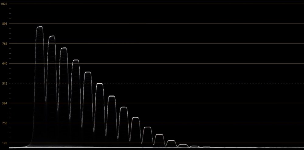

As I mentioned, when linearised 0.87106 works out about half a stop more than the a7s. It's okay, but it seems less than the sensor is capable of.
I just checked Gerald Undone's DR test again, and it's clipping at around the same point - around 0.87106. It looks like it's at about 880/1023 on his chart. So that would appear to be the max value.

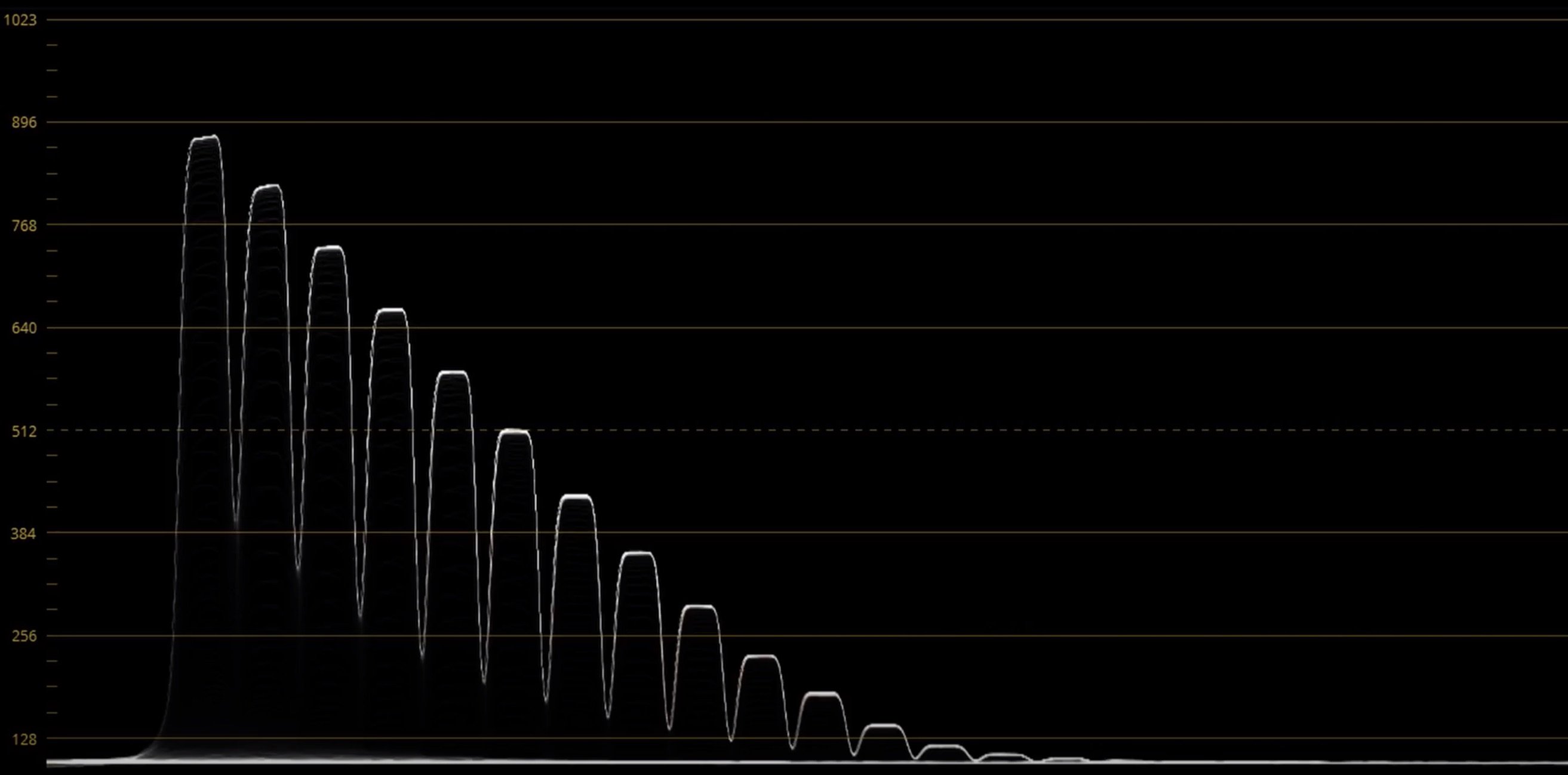

Just following up on this again.
If I check the black levels of the Xyla on the vectorscope here, they correspond with the min black level in the s-log3 spec - around 96. So yeah, it appears the default Data levels interpretation is correct and I was wrong that it may be Video levels.
