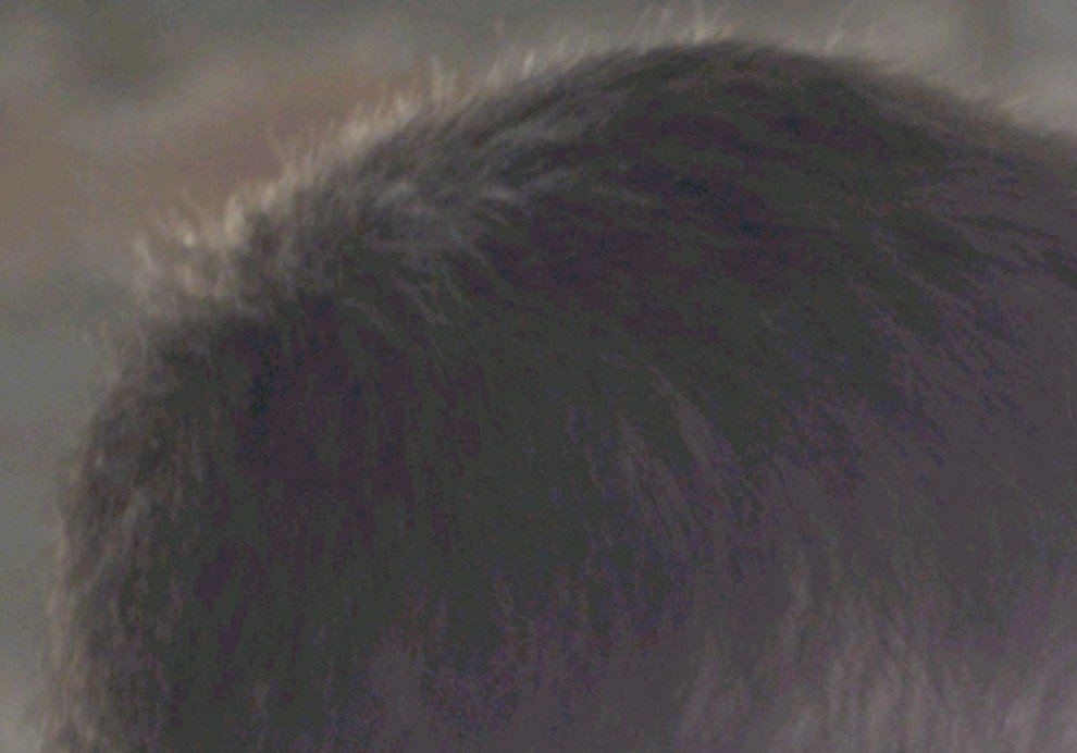

Llaasseerr Posted May 14, 2022 Share Posted May 14, 2022 On 5/10/2022 at 2:47 PM, Ryan Earl said: The HD capture in camera in 12 BIT DNG is where I've seen moire and aliasing in more normal shooting conditions, like hair and details like eyebrows. Though the rolling shutter is much better. It's supposed to be half of UHD I think, about 10 ms? With the UHD, I've haven't seen it where it ruins a shot, but have had it ruin shots on the Blackmagic cameras, so I have bought the OLPF and IR Cut where I could. Like a fashion / clothing shoot on the URSA 12K when I was initially trying that camera on its v1 firmware. Huge parts of a jacket were unusable, so I actually cropped in around it to a head shot later. The RAWlite helps a lot adding extra IR Cut too. The original URSA 4.6K that I still have is without one, there I've used a Schneider 1/4 Classic Soft or softer lenses and a Hoya IR Cut. In ProRes 4444 vs DNG the artifacts are blurred enough so I don't worry about it. With the Sigma FP I've been surprised I haven't seen it in normal shooting, and it's much cleaner in terms of IR. It doesn't need the extra IR cut. Though it can have a digital sharpness where I will still cut it with soft filter. In a test shot, with a lot of detail and packaging with tiny print the Sigma FP does better than the URSA 4.6K. The URSA 4.6K will have more artifacts spread through the objects and print details where it isn't there on the Sigma FP. Though in the color checker and charts it is there in ultra fine details but looks better again than the URSA 4.6K. So I'm not personally wishing I had an OLPF if it existed or thinking it necessarily should have been added. Thanks for the detailed answer! I've been testing a lot more raw files in the last day that I found linked off youtube recently (see linked video). I mentioned that I would lean towards re-pegging the DR by at least +3 stops since the camera holds shadow detail very well. Assuming base ISO 100, it seems you can cleanly push +4 stops with EI 100-800 in daylight and then maybe +3 with ISO 3200 in a darker scene if managed. Not sure about ISO 1600, it apparently has a bit less range that 800 and 3200? My latest question is around bad posterizing in the shadows with a green tint. I'm attaching a crop of a +4 stop push in post on one of the test clips from the upload I linked to. I could be imagining this, but I think I've read here on eoshd before that people are seeing a green issue in shadows sometimes. I don't know if this is the issue here, though, or if it's to do with the fact that these files were passed through slimRAW with lossy DNG compression, where generally lossy DCT compression can unduly affect shadows because there's an assumption that it won't be seen. What I'm hoping is that with lossless or losslessly compressed DNGs, this would not be an issue. But additionally, I've noticed that very high contrast lenses (Sigma) and night time scenes make the blacks fall to zero. This isn't necessarily an issue, but I would rather have them just off the zero floor. Not just because any compression algorithm can cause problems all the way down there, but also that if shooting to push 2-4 stops in post then too much of the image is clipped on the zero end and it looks excessively contrasty. So it seems a good solution regardless of any compression issues is to shoot with something like a Tiffen Ultra Con 1 and/or a lower contrast vintage lens, assuming you can't just add a bit of bounce fill in a controlled lighting situation. Obviously this appeals for more of a run and gun setup. If the green/banding issue is because of the sensor, that obviously sucks! webrunner5 1 Link to comment Share on other sites More sharing options...
Llaasseerr Posted May 14, 2022 Share Posted May 14, 2022 Just following up on that last post, I realise I was simultaneously saying the shadows hold up really well, then saying that they had banding and weird tinting issues. What I should have said is that generally the shadow detail seems very low noise and very good, but I did run into the artifact issue in the case of this hair crop in the post above. So hopefully that kind of thing is not native to the sensor. Link to comment Share on other sites More sharing options...
Llaasseerr Posted May 14, 2022 Share Posted May 14, 2022 Alternatively it could just be that I'm taking the bits buried right at the left side of the histogram, and expecting there to be enough detail when expanded out by +4 stops into the midrange. Perhaps 12 linear bit just isn't enough for this kind of image manipulation, hence banding and posterization! Maybe these numbers will reveal something: Assuming 4096 code values in a 12 bit integer linear raw image converted to linear floating point EXR where middle grey is pegged at 0.18: So if I underexpose by an extreme -4 stops, then that pushes middle grey down to .0112. With 4096 code values, middle grey at "correct" exposure would be at around 737. At -4 stops below, it would be at 46. So that's probably my answer - LOL. 46 code values for everything from middle grey and below, and 4050 for everything above middle grey! Assuming my maths is right. If so, -3 stops would be about 92 code values for middle grey in linear light encoding. Link to comment Share on other sites More sharing options...
